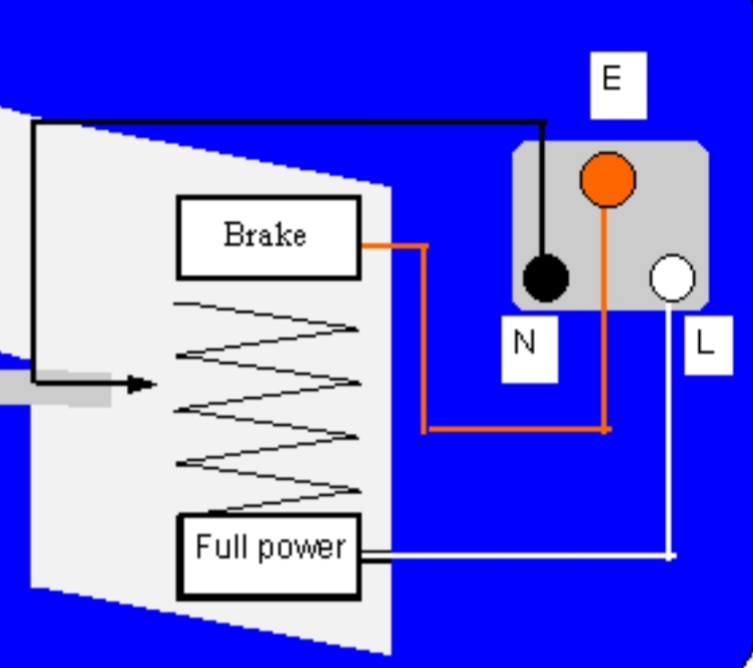

Lots of potential reasons for brake failure.
The most likely is that the red cable the goes to the centre pin of your bs546 plug is broken or disconnected.
Alan
The braking works by connecting the red to the black when you release the throttle.
Test whether the brake circuit using an ohm meter
AlanW

Thank you Alan  Thumbup
I thought that the red wire was the breaks, but this isn't my strong point!
The diagram is very helpful,  will have a look and see what I can find.
