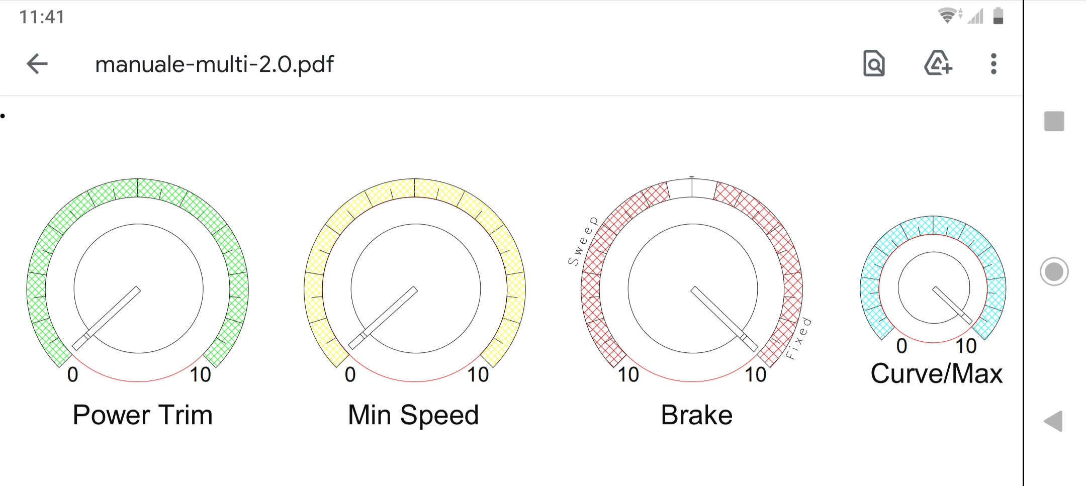

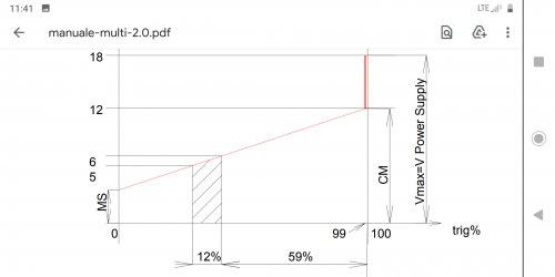

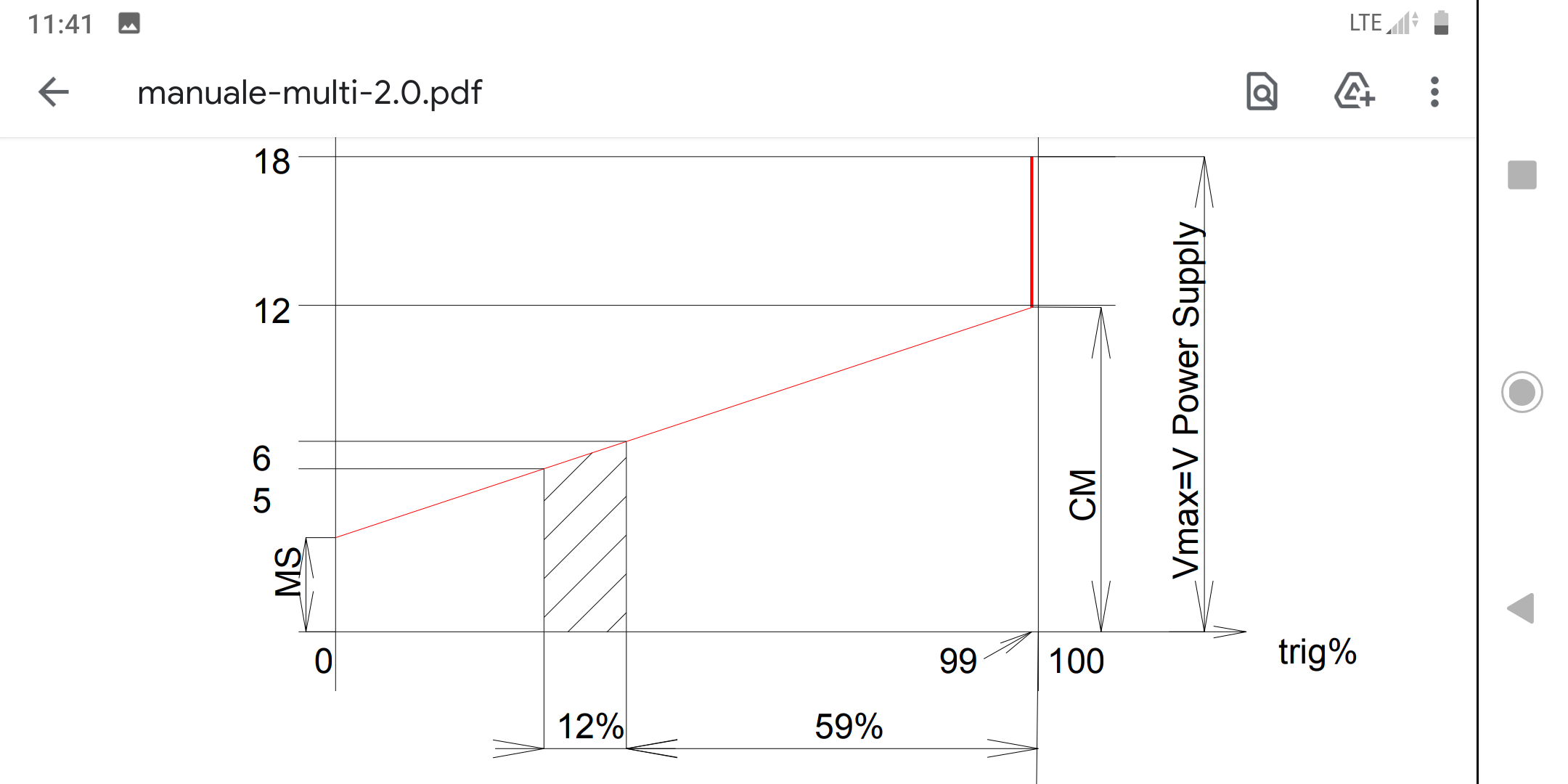

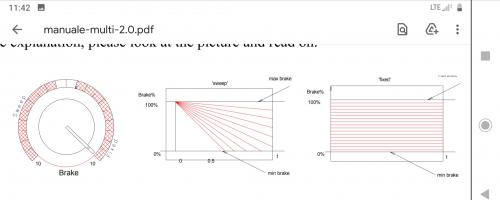

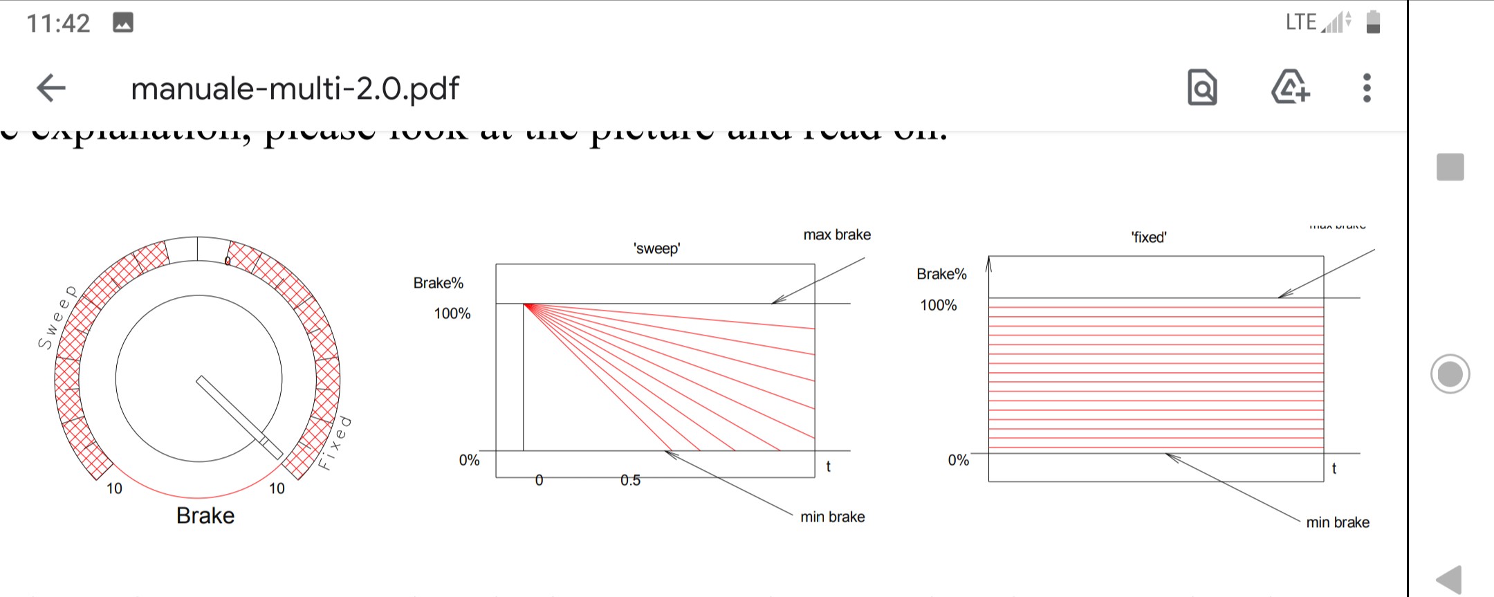

Having read the manual a couple of times, for me, it's these two diagrams that cut through all the complexity associated with describing what each of the knobs are for...
And for completeness...
With the Power Trim knob modifying the transition between the three stages of the first diagram.
Let's go...Off Road!

Or to put it back into words...the dials allow you to focus the trigger on the range of corner speeds between the slowest and fastest corners on a circuit. So:-
0% trigger: car ststionary
1% trigger: MS (Minimum Speed) is the speed you want to go round the slowest corner on the circuit.
99% trigger: CM (Curve/Max) is the speed you want to go round the fastest corner on the circuit.
100% trigger: car full speed.

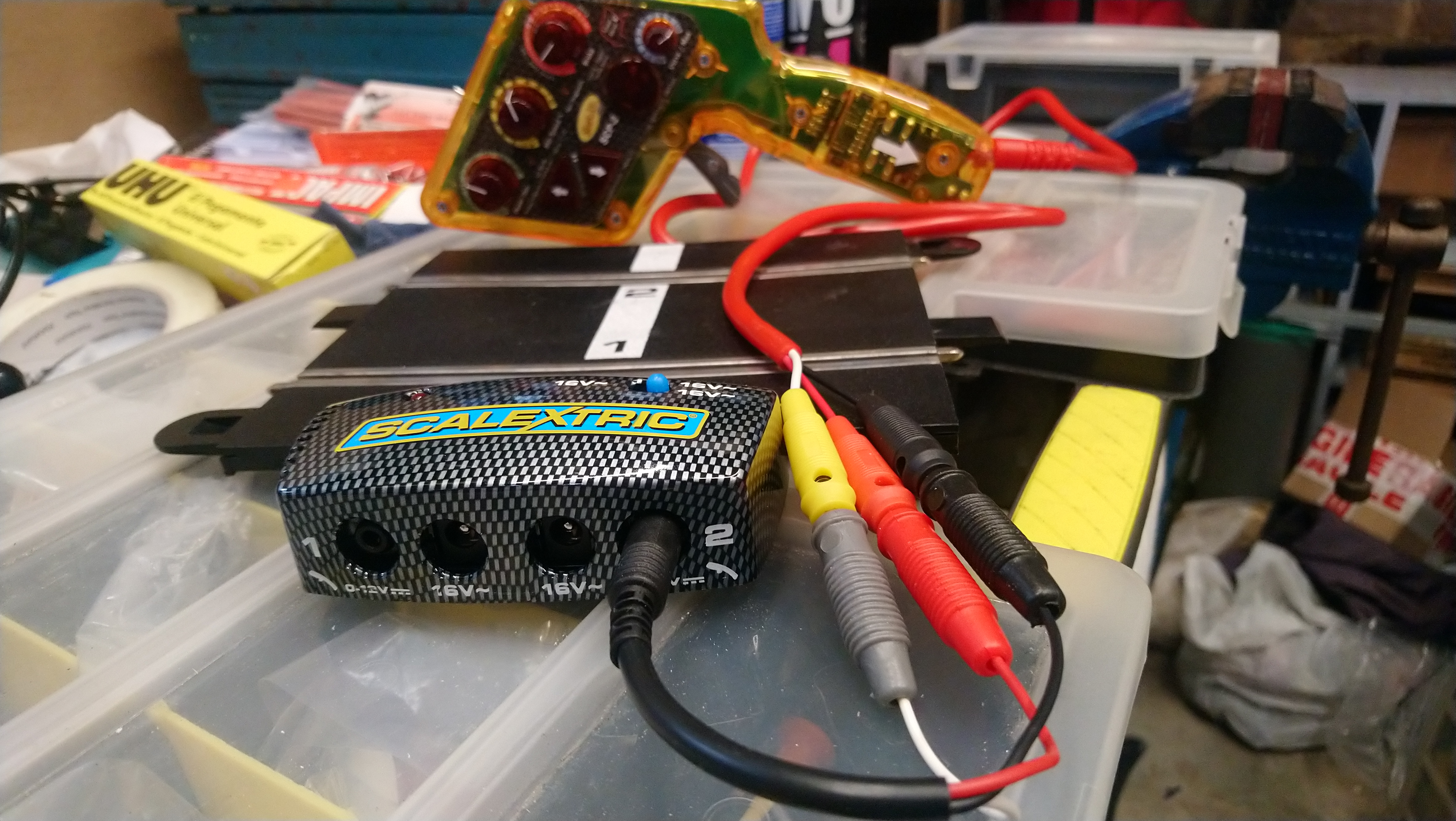

Ok...so set up my track for the first time in four months. The truspeed controller works a treat on my SSD cars. However, when I disconnect the digital powerbase and fire up the analogue base in the picture above, the following happens...
When I use the original controller, the analogue car drives very slowly round the track.
When I plug in the scp-2, the red light on the base goes out after about 10 seconds, and only comes back on when I unplug the controller. If I try and run a car in those first 10 seconds, it doesn't move.
Reading the scp instructions, there is mention of 'common ground (positive wiring) track' and 'common positive (negative wiring) track' and jumper configuration in the cartridge. All I have done is plugged it in and tried to play, using a Ninco 3 into 1 cable converter as in the picture above. It says it can be used for Scalextric.
Any ideas anyone?
