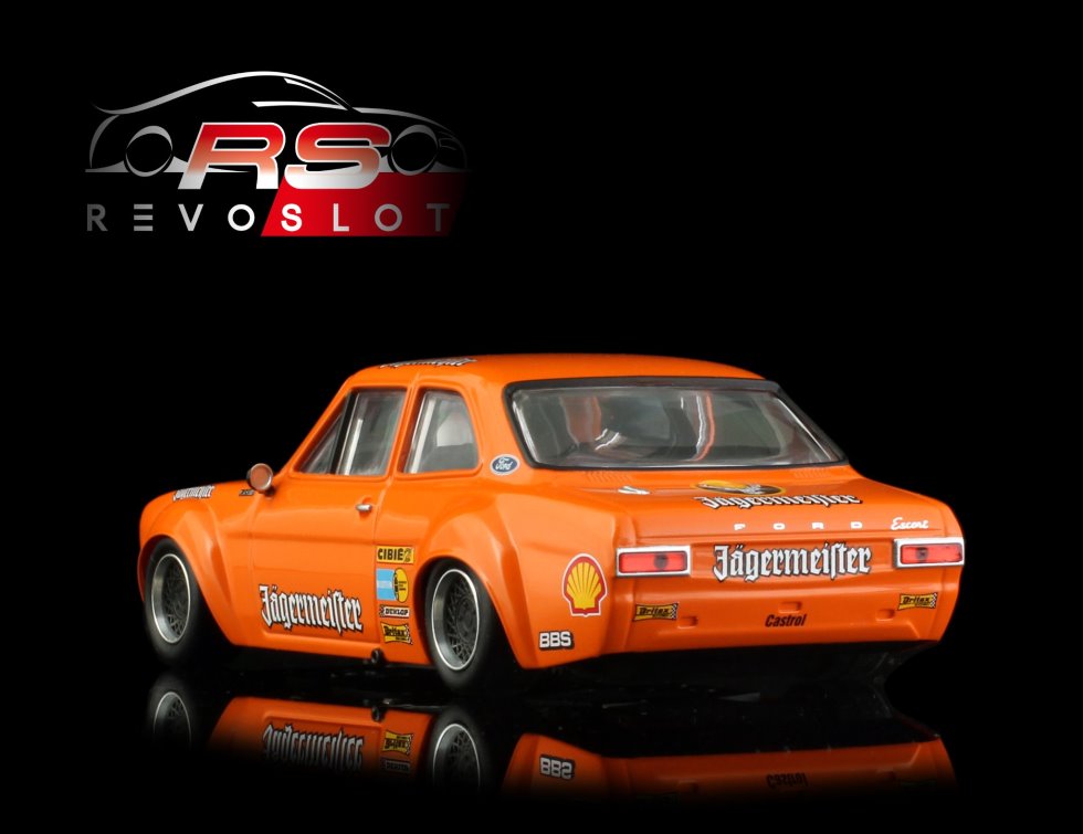

This is the first proper look at the RevoSlot Escorts, now due to arrive August/September and available to pre-order at Pendle Slot Racing...
RS0139 - Ford Escort Mk1 No.20 British Caledonian
RS0140 - Ford Escort Mk1 No.79 Hannen Alt
RS0141 - Ford Escort Mk1 No.75 Jagermeister
Plus there's a RS0142 Ford Escort Mk1 White Kit. All have this chassis and spares package...
Thanks to Pendles for the images.
