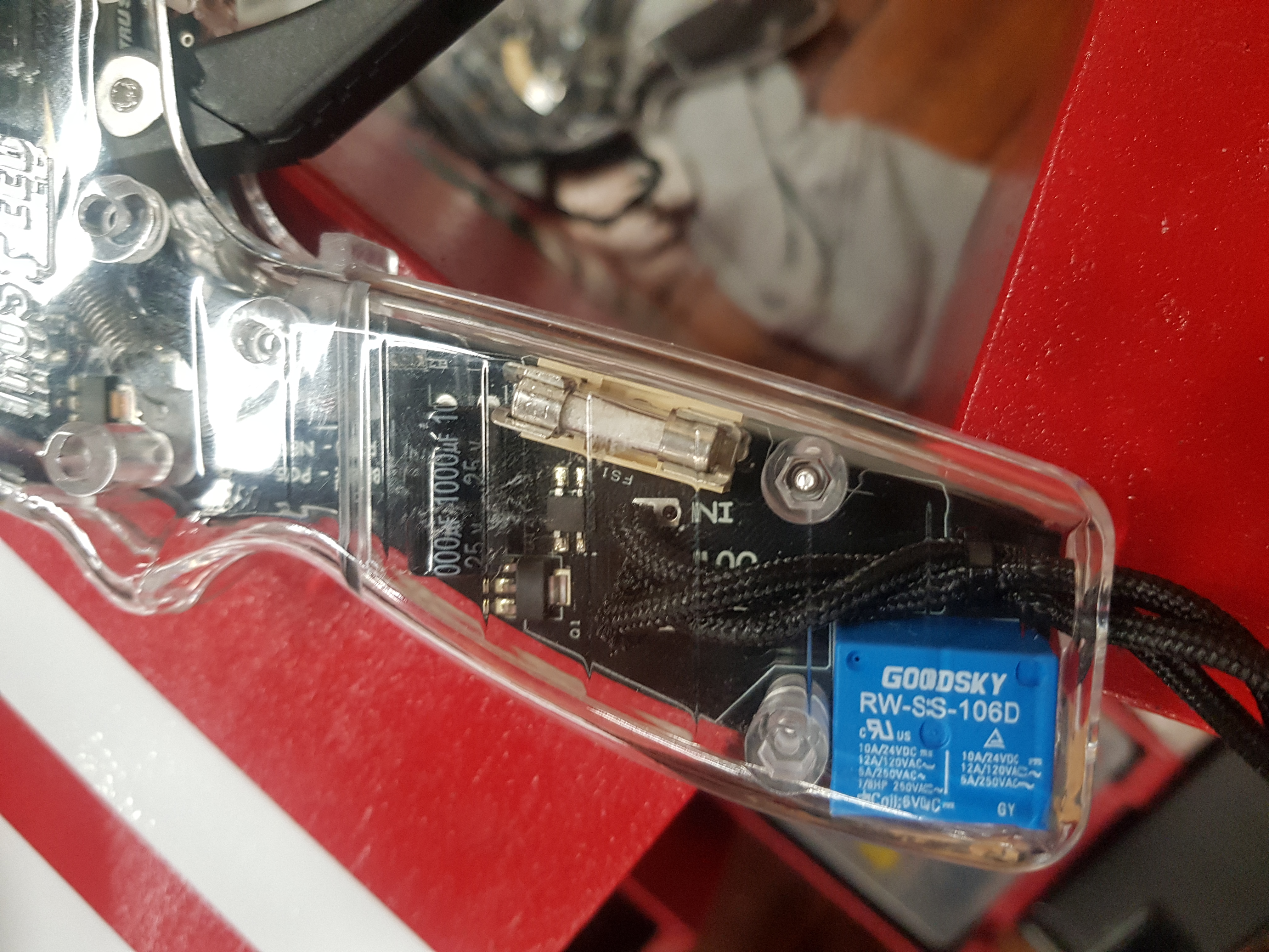

Truspeed with onboard relay
[+] 1 member Likes Nonfractal's post
