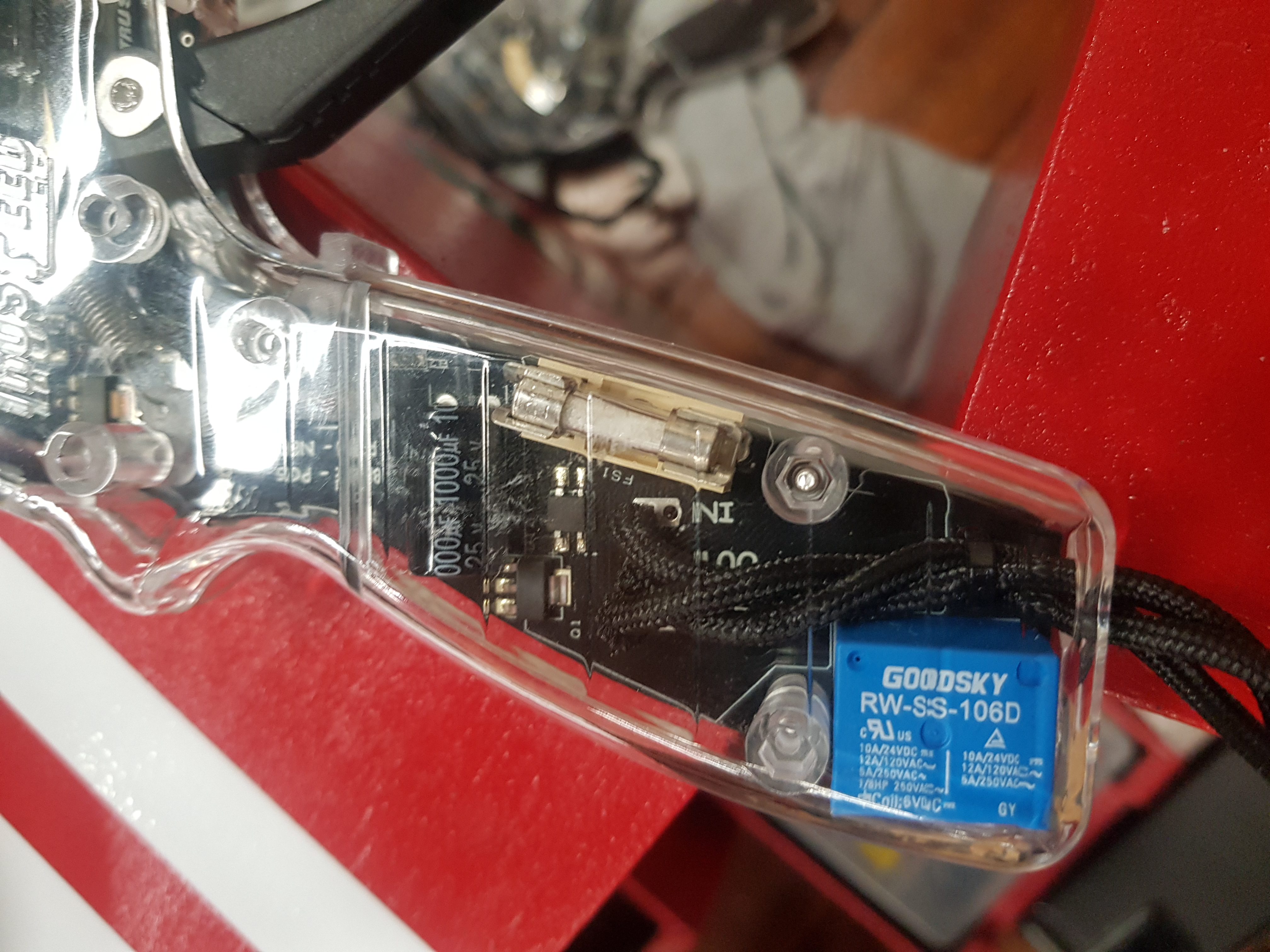

Truspeed apex positives
-Built in blast/bypass relay (it looks like it but only truspeed could confirm that this is really the case)

RE: club controller - Nonfractal - 31st-Oct-21
Truspeed with onboard relay
[attachment=19069]
