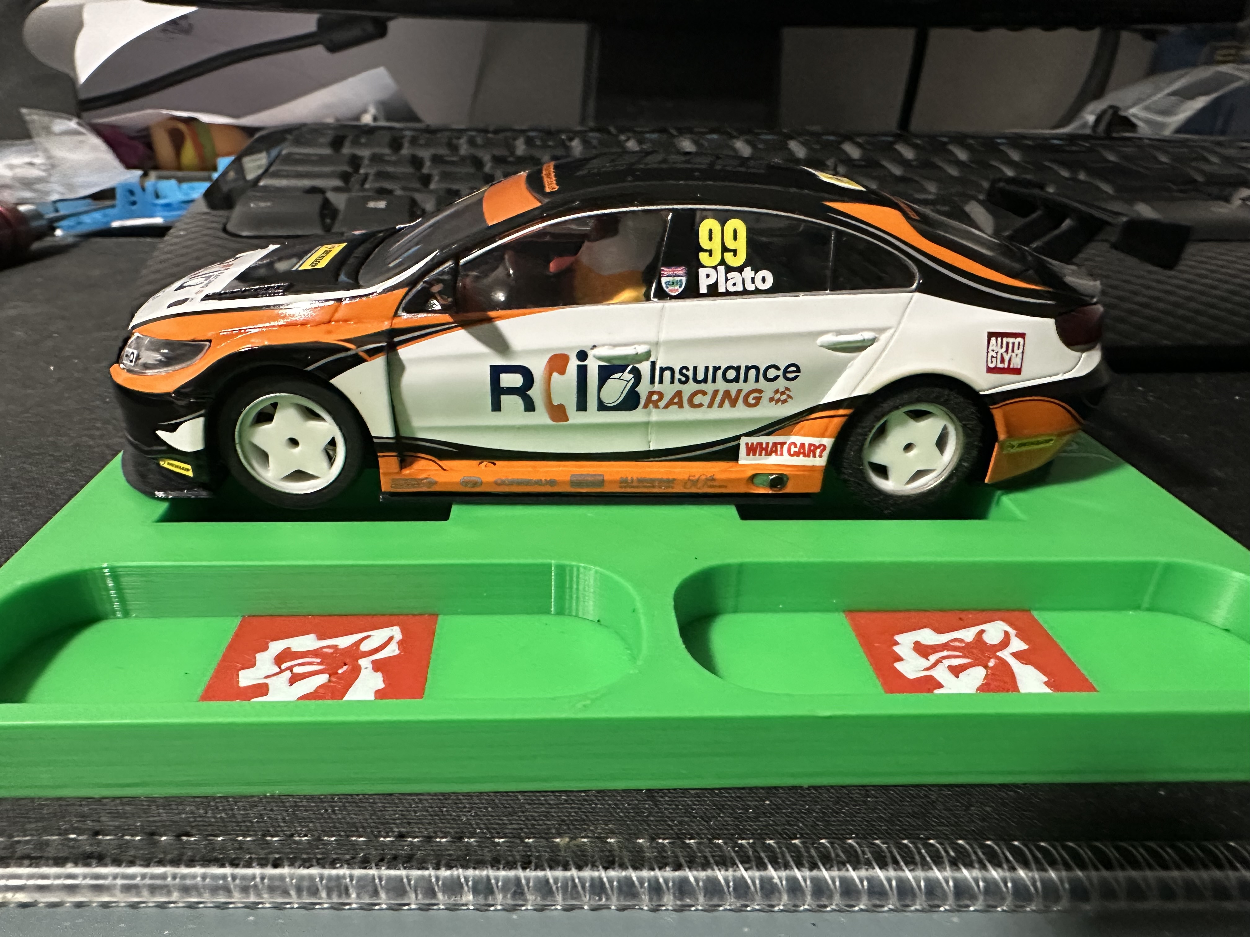

First proxy for a long time, but I have a real soft spot for 90s-modern touring cars.
Here’s my Scaley Passat.  Hoping to do some test runs tomorrow at Llantrisant Slot Car Club, video to follow.
