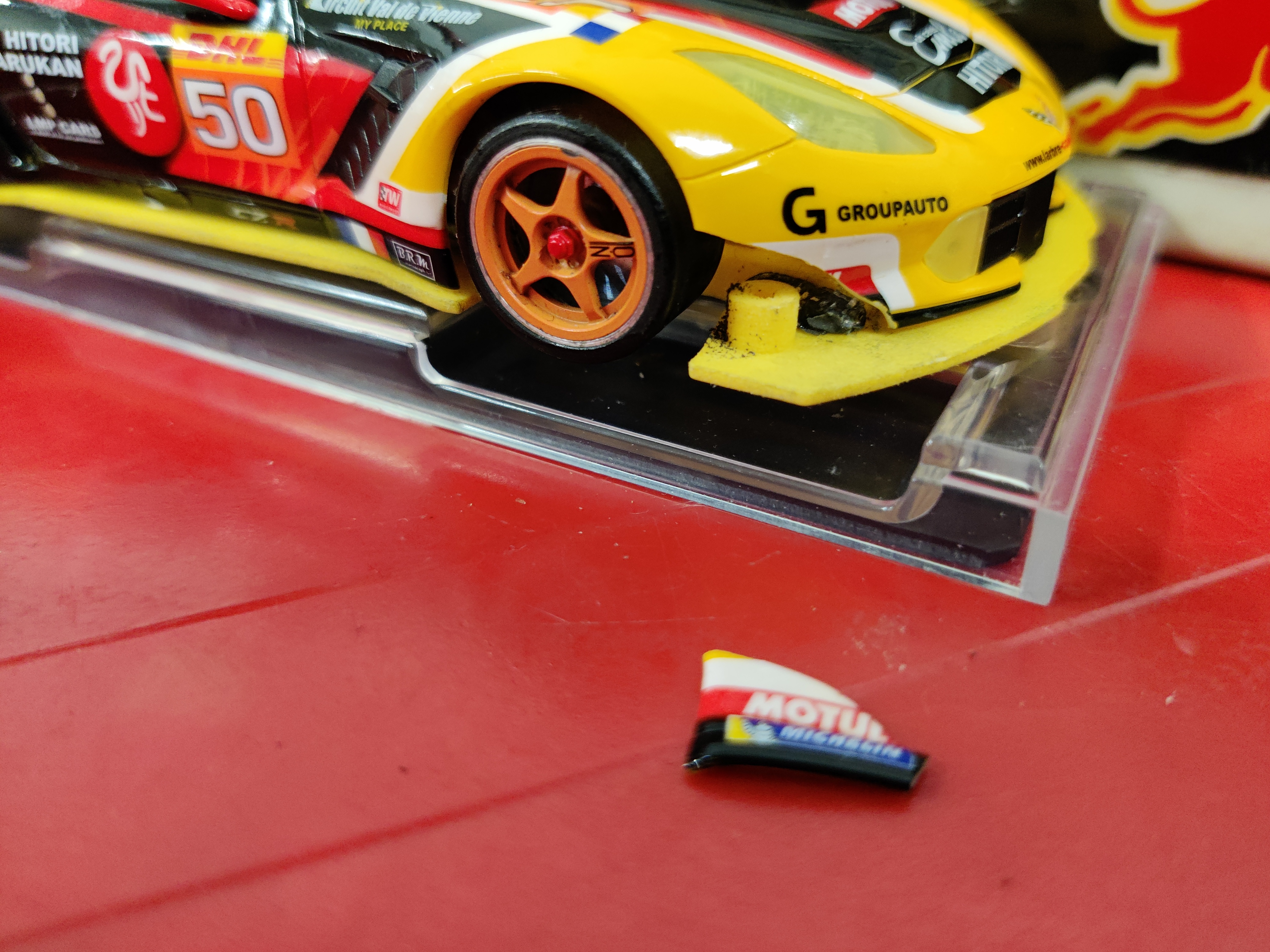

In an attempt to get a bit more tuning time in I ran the car in our open club class last night to try and look into Robs observation .....does the car feel smooth, balanced, and hooked up?
Well it is fast, if it wasn't for a big off the caused the below damage losing at least 3 laps then it would have been upper mid table in a field of moslers and lmp cars with unlimited motors, weight, tyres etc.

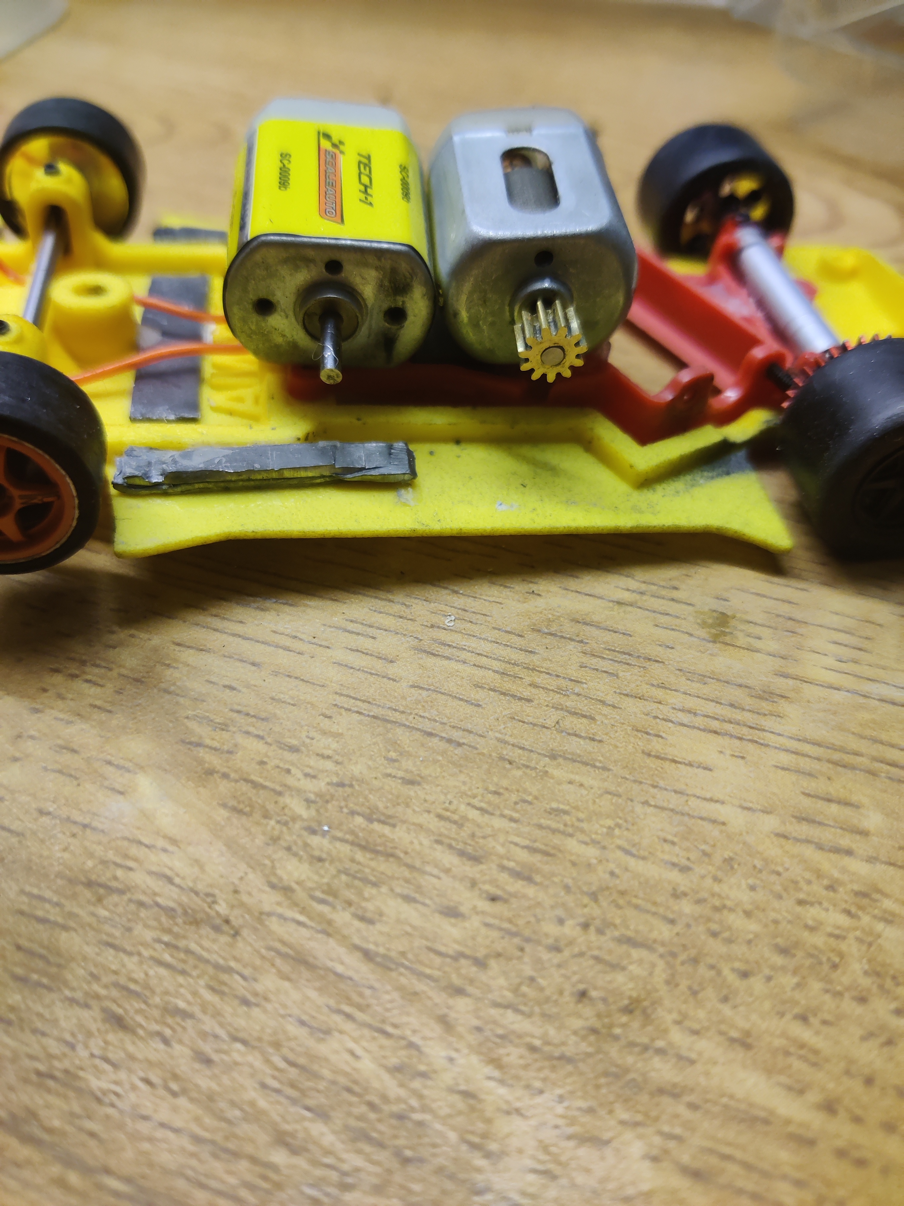

And now I remember why I didn't use the shark in the first place! Spot the difference. Other than the pinion of course.
I hope it was a good move to swap as I am fairly commited now!
The damage to the front has been repaired although a tiny piece still missing. Certainly not going to be winning any concours!

Put a little fiberglass tape on the back side of the damaged area or across the entire front inside the body. There’s one track with a tough tournament 1 after a long straight

(22nd-Oct-21, 10:14 PM)Brumos RSR Wrote: Put a little fiberglass tape on the back side of the damaged area or across the entire front inside the body. There’s one track with a tough tournament 1 after a long straight
Thank you will try that. unfortunately that's a pretty standard evenings damage, especially with the more performance orientated brands making bodies so light and thin.

Ok shark 25k is in and despite being mostly held in by thoughts and prayers (and hot glue) the mesh is smooth. Front area is now reinforced with tape. A few test laps this morning, it's lost a 10th of ultimate pace but definitely smoother and easier to drive, you don't need to as cautious on the throttle.
Still more torque than grip coming out of the tight hairpin and off the start but I'm going to try a little more softening of the tyres to help with that. After 30 seconds or so the tyres are warmed up and the grip and torque find a nice balance.
