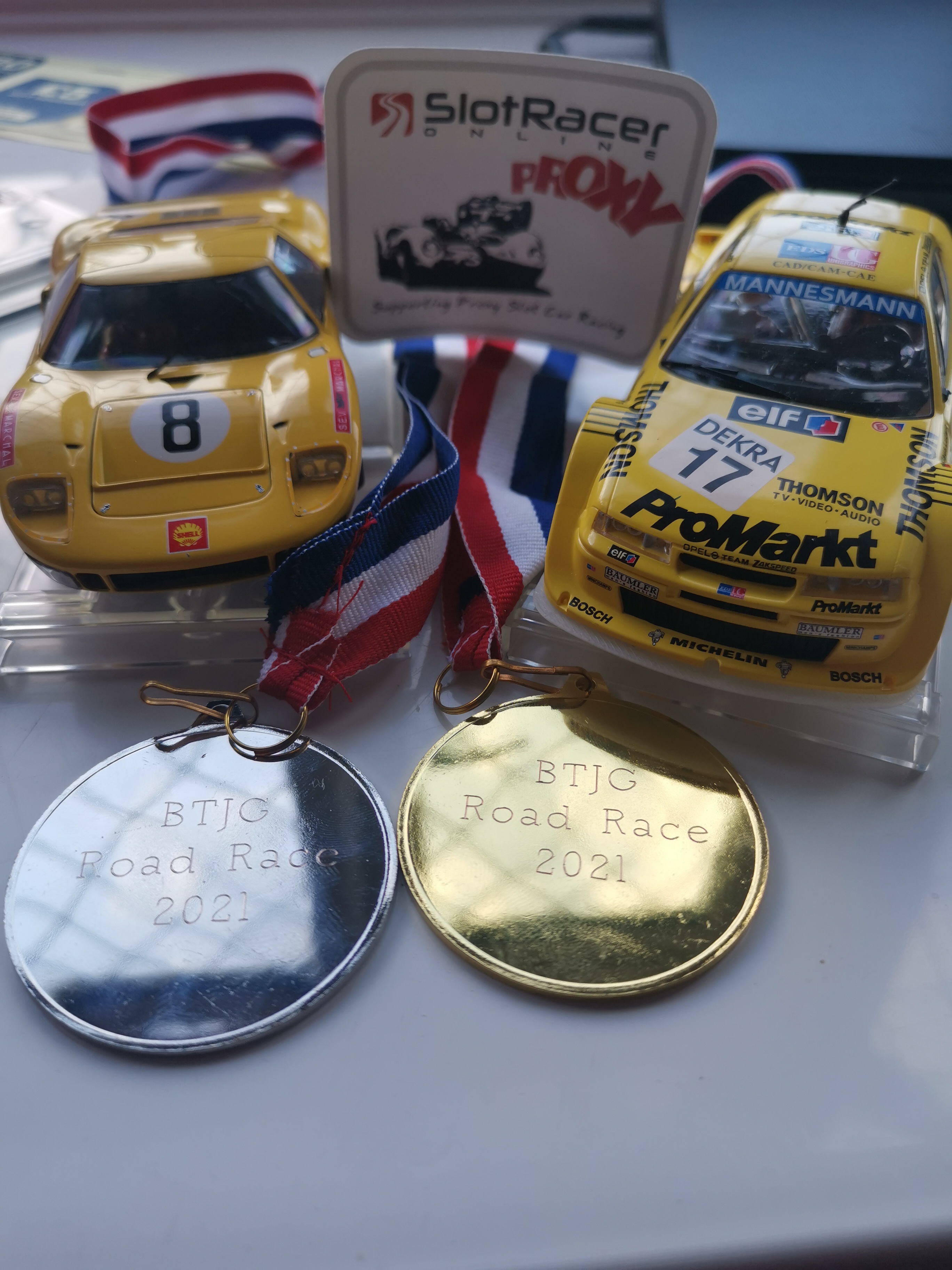

Yellow Devils made it back to base safe and sound.
Build for anyone interested
Class B 1st
Slot.it Calibra body
Lexan interior
Kat racing 3d chassis
Scaleauto 0.5mm offset anglewinder pod (narrow)
Sideways 17k baby raptor
11/29 slot it gears
Slotting plus urano 16.9mm wheels
Slot.it zero grip fronts
PRS 20x10 grip 1 rears
Nsr rally spring guide
Nsr non tinned braid
Slotting plus hard suspension front, medium rear
Slot.it Independent front axle
Notes to self:
Guide too wobbly
Suspension rebound not even across axle
Class C 2nd
Standard Slot.it gt40 body, chassis, pod
Lexan interior
Nsr shark 20k
Standard slot.it gearing 11/32
Slot.it 15.8 air hubs rear with BRM f15 19x10
Slot.it 15.8 aluminium fronts with nsr zero grip 18*8
Slot.it suspension rear only
Nsr spring rally guide
Nsr tinned braid
Notes too self:
Body too tight
Too much side to side pod movement
