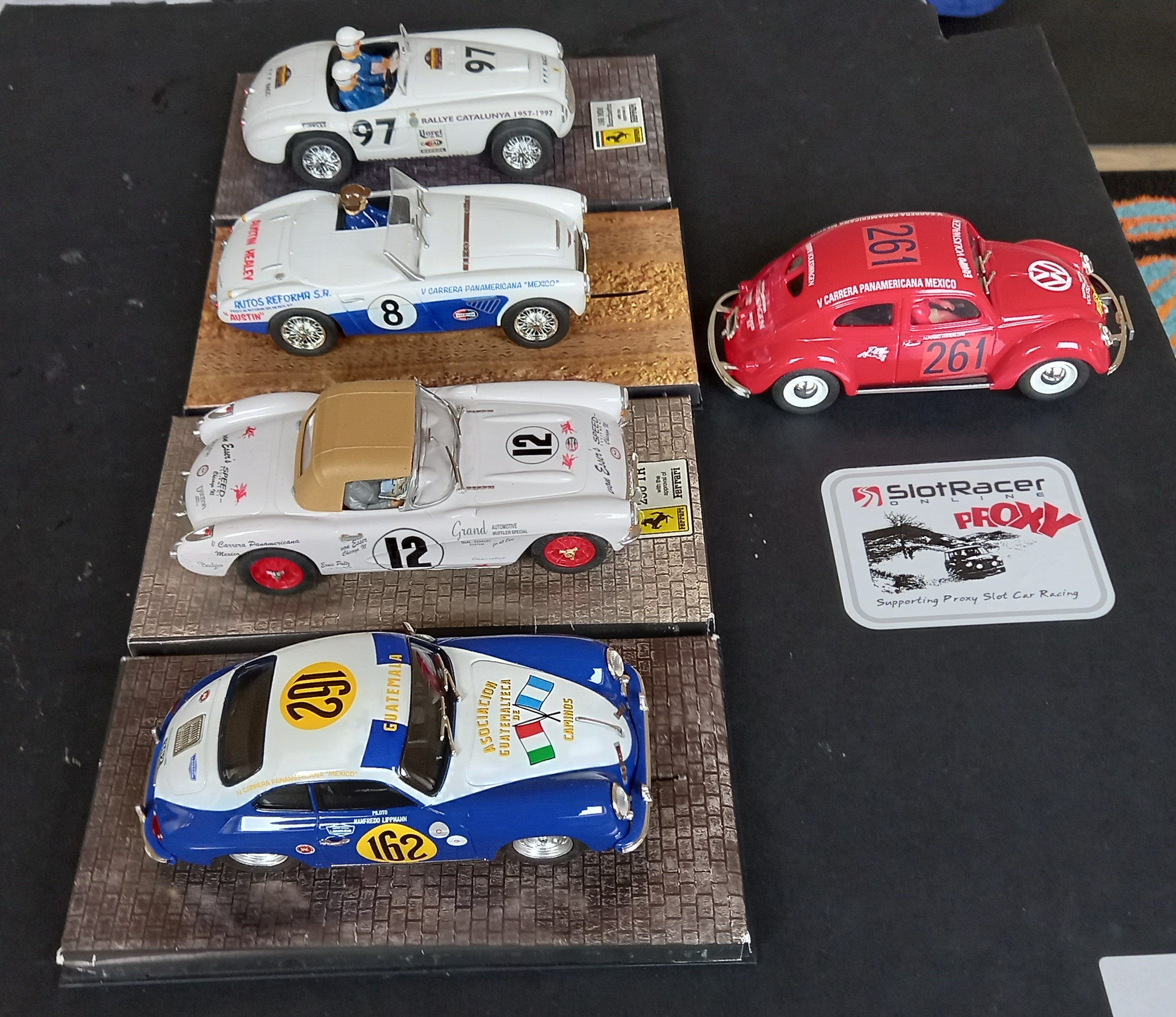

Wavegreen God Morning,
So just before we move onto Class C here is a photo of my Carrera Panamericana type "off the shelf 50's cars"
But of course they can be any of the cars listed over the 50's or 60's
The Porsche, Chevrolet, Healey and Ferrari are Ninco's and the Beetle is from Pink-Kar
I was also reminded about "Rally cars", I don't have a historic list of such cars of the period (although I made a mental note to look out for one) but I do know that mostly they are the same, especially those which run in the "Tour De France". However they are all welcome to enter this this Class. I did find a listing in the racingsportscars website for a couple of Rally's both in the USA and in Europe but they were quite limited.

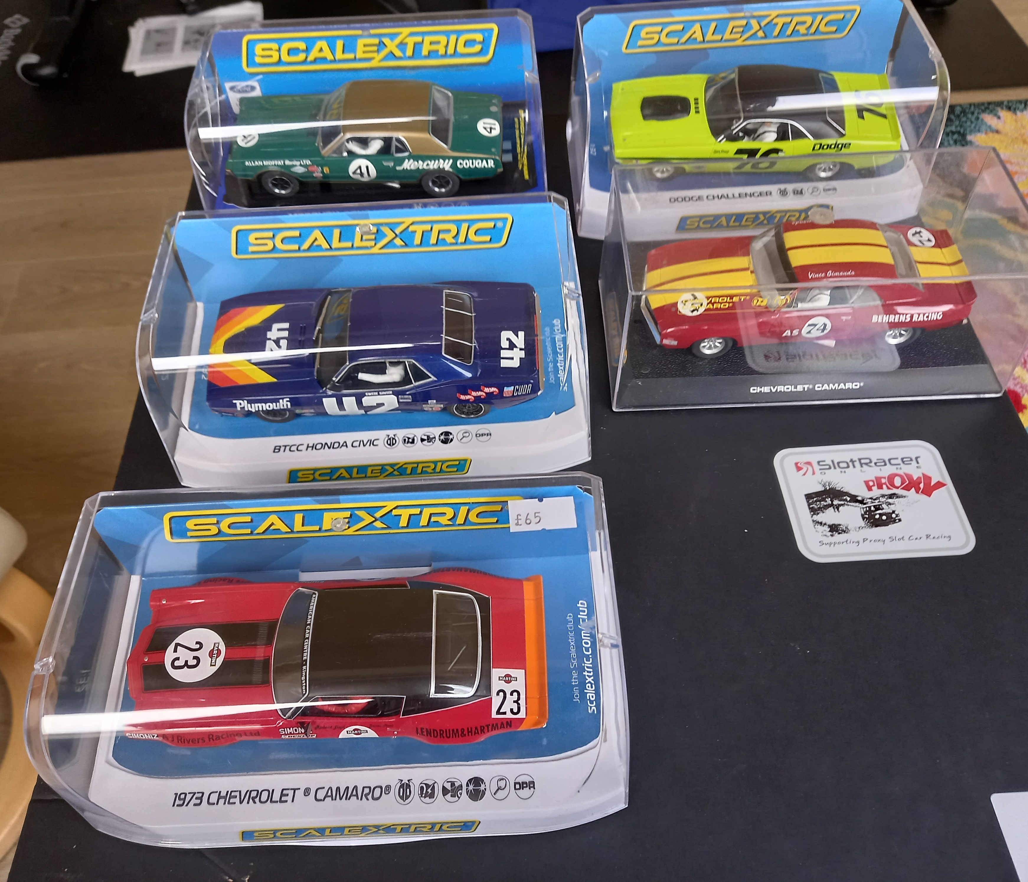

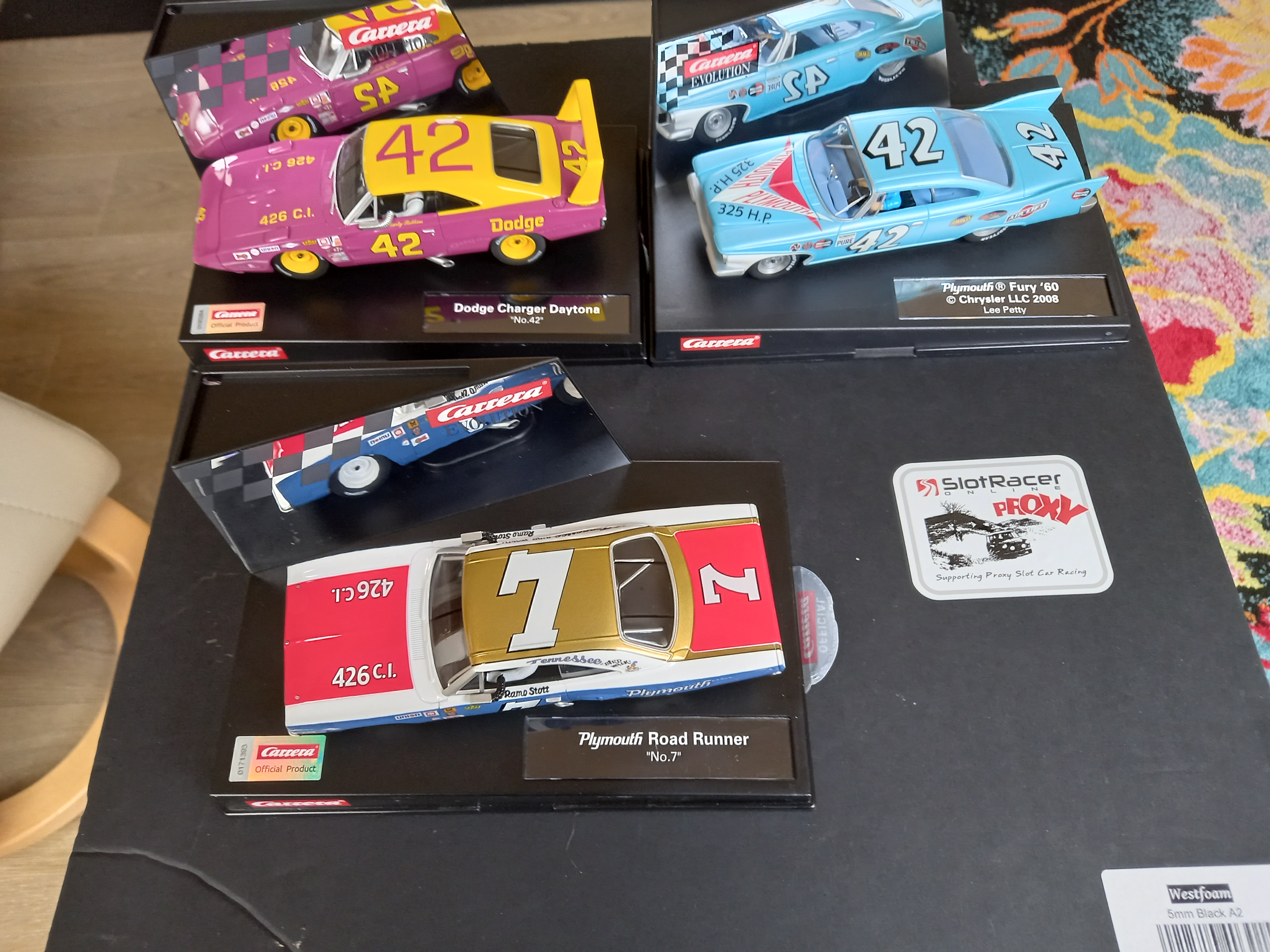

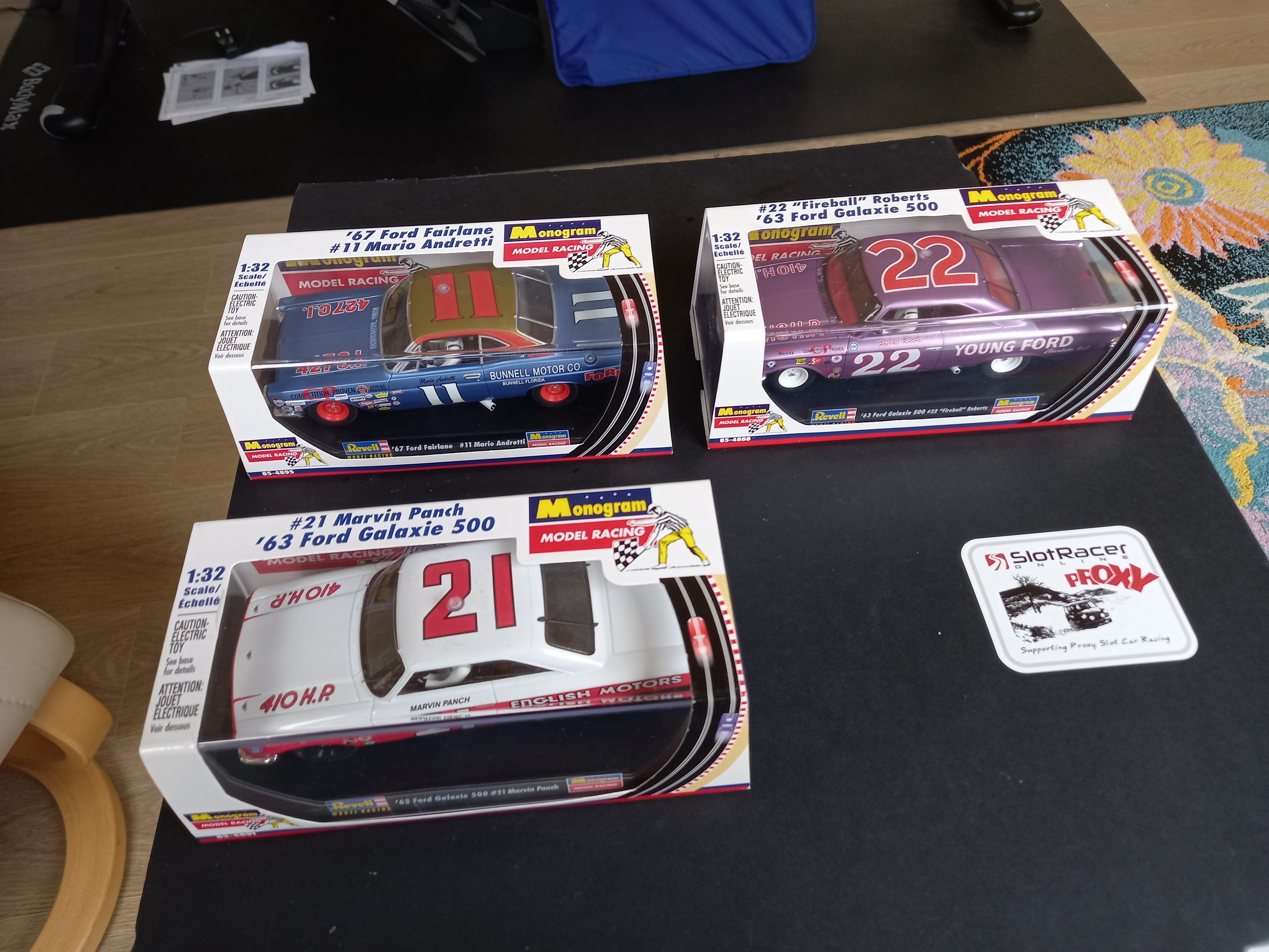

And I have some photos few cars of my own to wet your appetite
The NASCARS
            Revell Monogram                                                                                                      Carrera
And the Classic Trans Am
Scalextric & SCX (Plymouth Barracuda)
