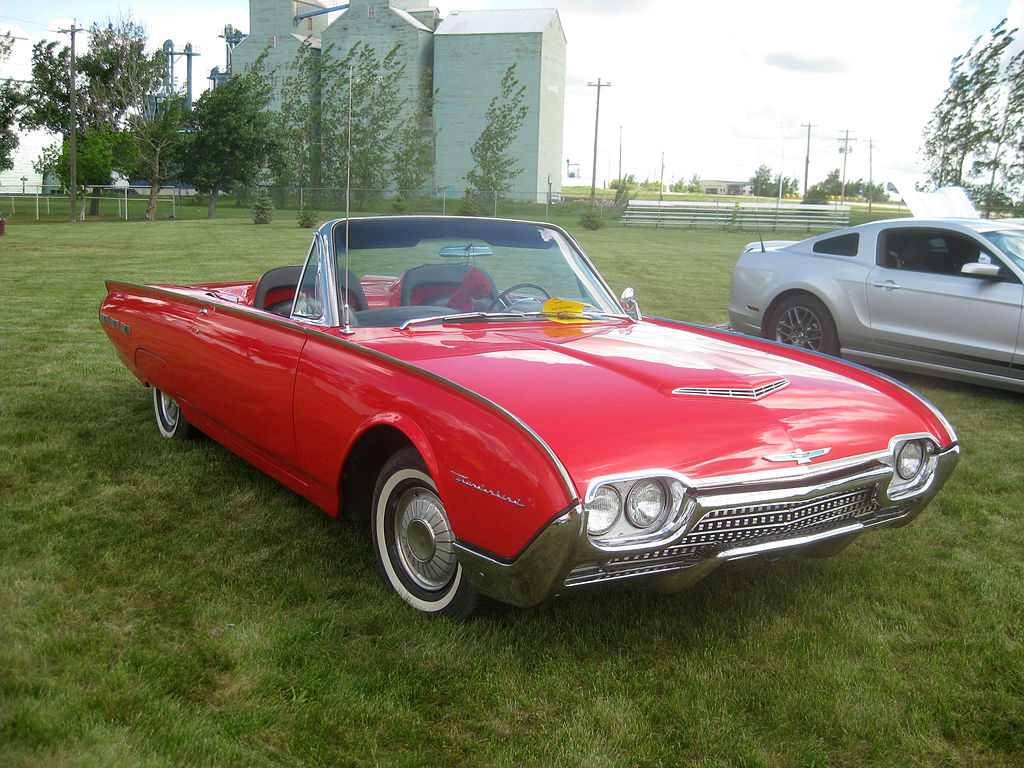

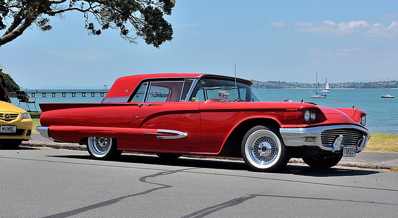

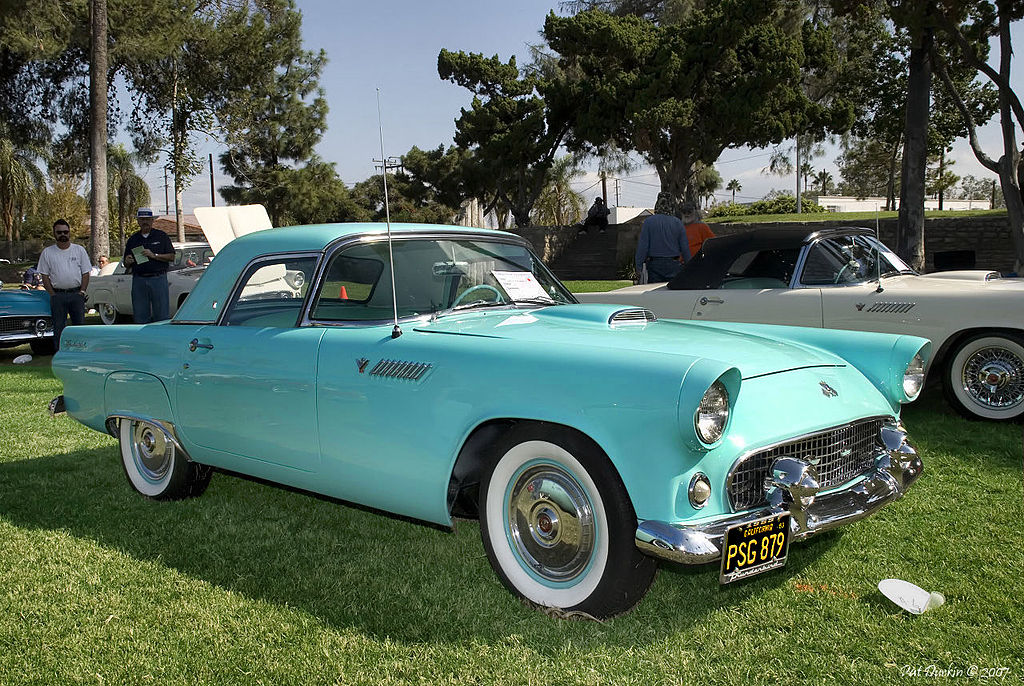

#19
So the 1955 T'bird
...and 1958 T'bird
...but not the 1961 T'bird
#20
Yes I would like them all really  Idea
