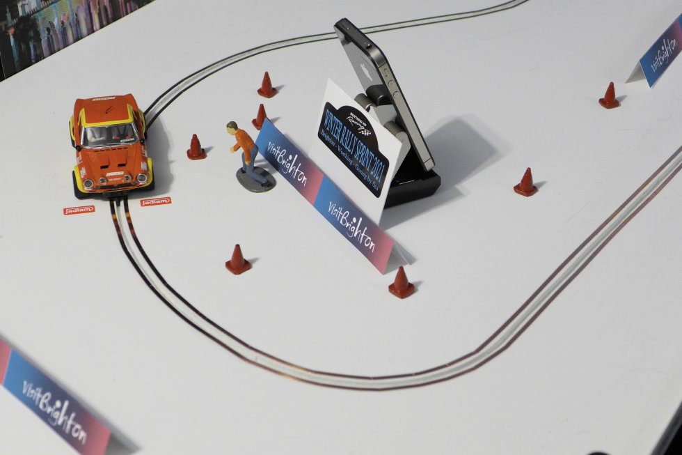

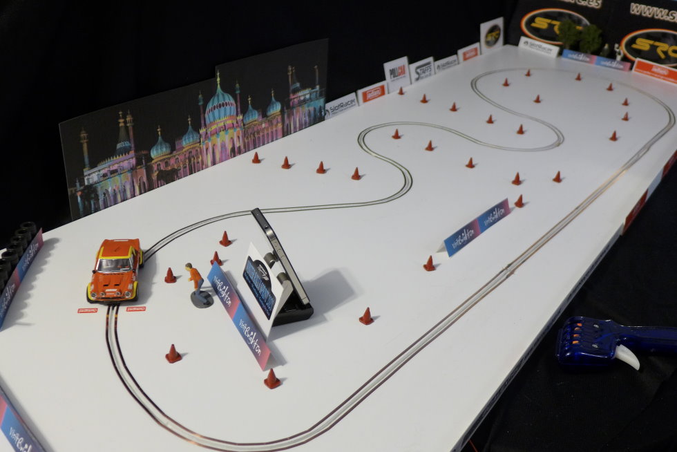

The origins of the layout are an experiment that didn't lead anywhere - apart from a fun little track. The shape is based on the Grandvalira circuit in Andorra, which is an ice track in the winter (part of the Andros Trophy series) and tarmac in the summer. I may still convert the board into more of a representation of that track, with snow banks etc... However it is the perfect size to be an imaginary circuit on the ice rink that's created in front of the Royal Pavilion in Brighton each winter (apart from this year, of course). It made more sense at the start of the Rally-Sprint in January, but it's a fun way to end the event.
The track is routed into a 10mm white Foamex board, giving a slippery surface, usually getting more slippery with the dust and dirt the surface attracts... I wiped it down just now with a damp cloth, but I won't touch it tomorrow. I've used copper tape for the power rails - braid would be better, but I found it hard to route the Foamex smoothly enough to create those shallow pockets. I do have my soldering iron, flux and solder ready for repairs tomorrow. Fingers-crossed we get through all the cars without needing it.
I shall be running the track at 12 volts, using a 45 ohm Parma. I've given all the cars a good recce this afternoon and - apart from one - they all ran well. I'm looking forward to driving them again in the morning.

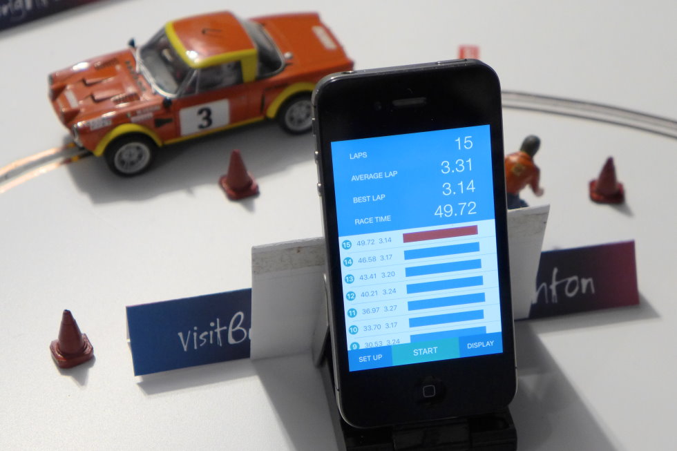

There was no timing when I ran the cars today. Tomorrow, each car will get 15 laps. The Fiat did that in just under 50 seconds, but I'm sure some cars will go quicker than that.
