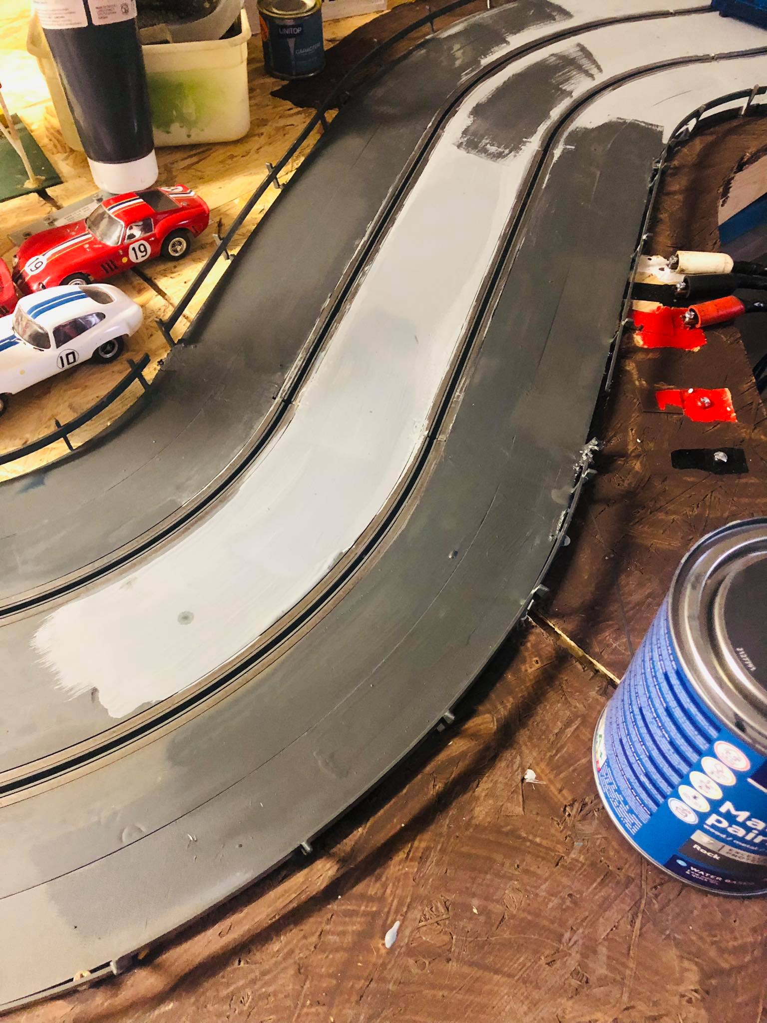

Hub - I have added foliage, but then stopped as I need the correct colours (currently all my purchases sitting with my daughter in the UK - collecting in Nov :) )
In the interim I have been adding more to the base - plaster bandage laid on the board. And with colours on the track.
Initially bought a tin of grey but it was far too light.
As can be seen here
I then bought some more paint (after failing to darken my original grey purchase) with a tin of paint called 'Stone'. It is a floor paint, so is not gloss smooth when painted on.
This is the update:
Looks good so this will be the solution for the whole track.
