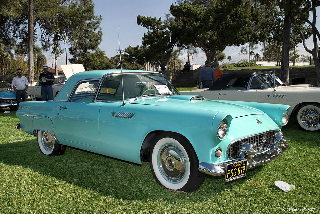

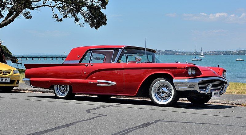

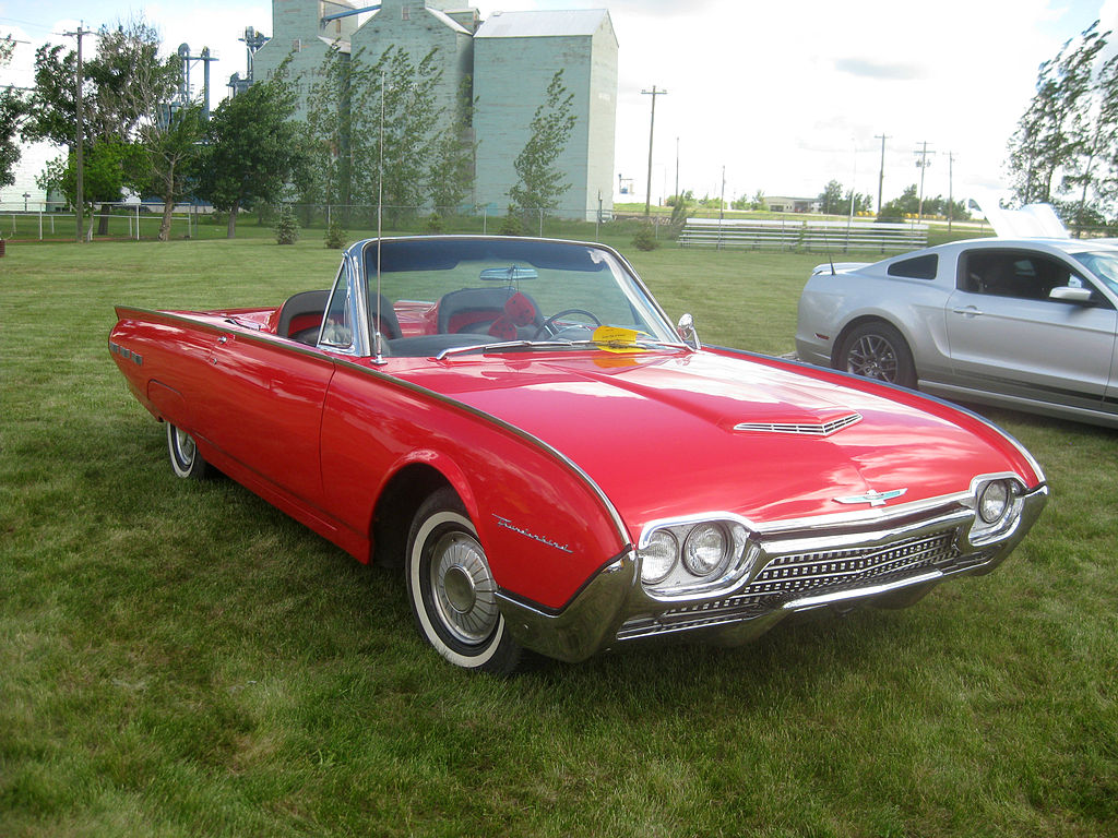

Additionally after abit of research, I have added the Ford Thunderbird model year 1955-1960, but if the Thunderbird is of a later model it will be placed in the Class C.

So the 1955 T'bird
...and 1958 T'bird
...but not the 1961 T'bird

Yes I would like them all really  Idea
