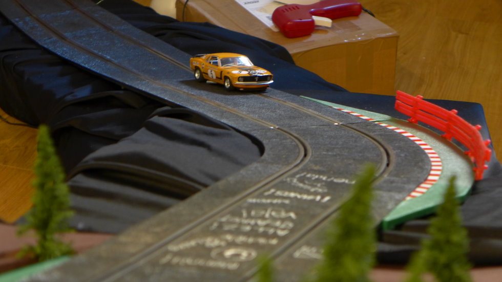

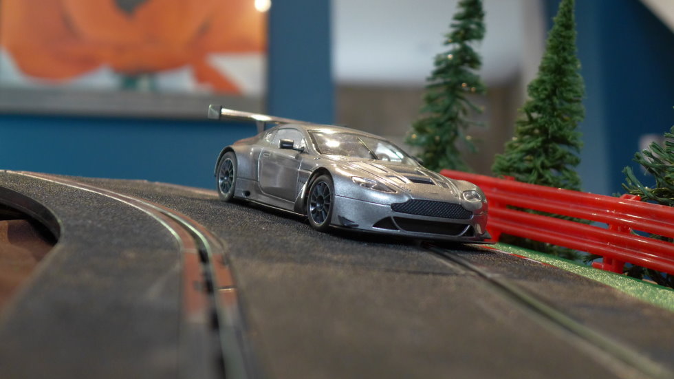

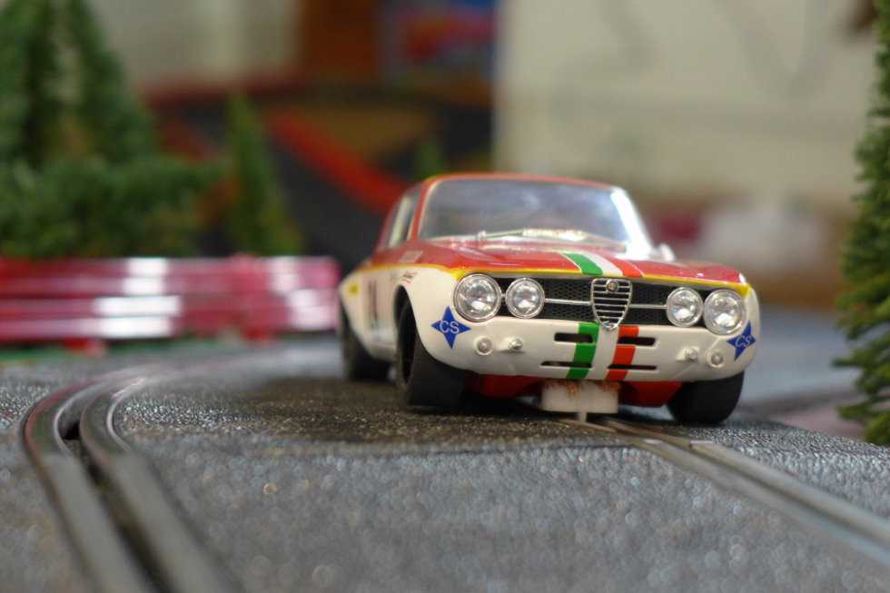

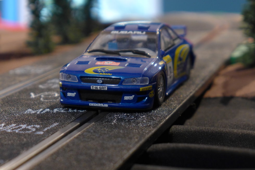

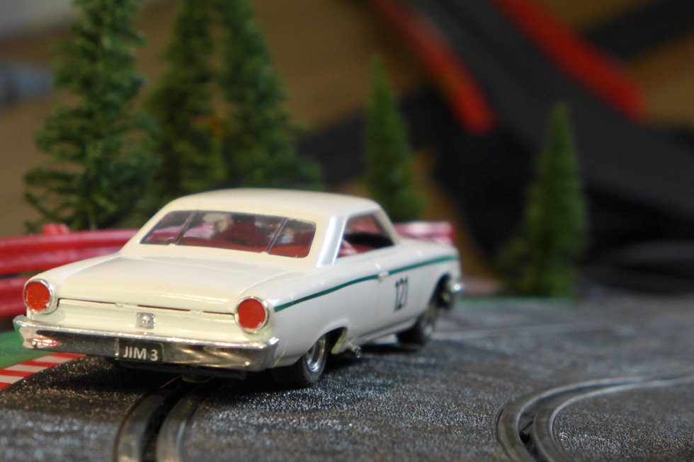

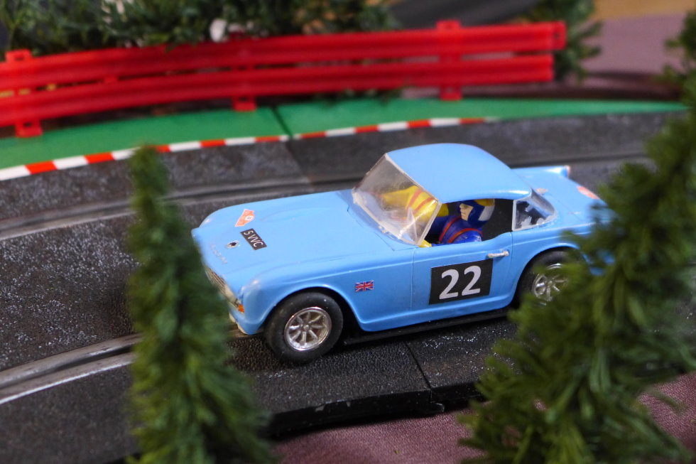

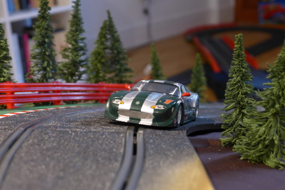

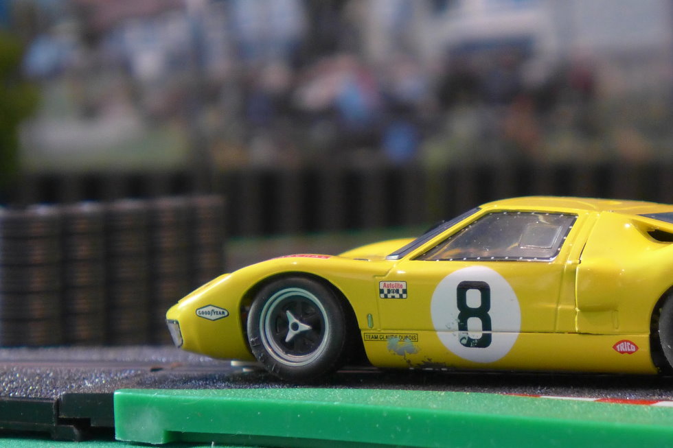

I had time to take a few pictures today. These are my favourite six...
Before I dismantled the hill, I did do a little bit of testing for potential future use - we might be seeing it again before next February.

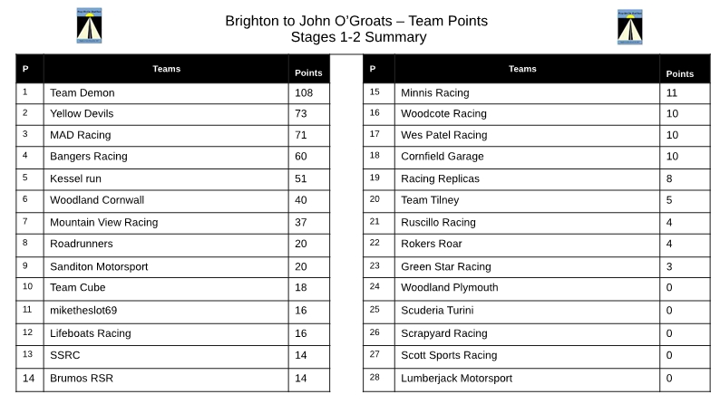

Wavegreen  Good Morning, after the exciting coverage and careful nurturing of our cars around the stages at Brighton, the cars will be shortly moving onto Hereford.
But before we depart we should take stock of how the cars & teams are doing so far,
I have added the full results as PDF files

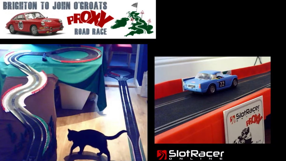

Although the bells and whistles on the video stream didn't quite go to plan (I'm thinking  a CPU process priority issue with Race Coordinator...), I'm glad you enjoyed what I cobbled together. With the camera on the start line, I thought it was a small step forward from last time...
Paul - YouTube have a reasonably good guide to streaming. The easiest way is to simply plug a single webcam into your PC, Mac or laptop and hit 'stream now'. I used these cheap ones with manual focus - auto focus tends to focus in and out with any movement. However, using the OBS software (with the help of Jason's guide here) does give you the option of extra cameras, plus some images, like Jason's banner image I pinched from the SlotRacer homepage. An OBS 'broadcast' will need setting up and scheduling on YouTube beforehand - but it wasn't too hard. The nice thing about YouTube is that you can embed the feed on the forum, share the link on Facebook -  and it automatically posts a copy of the stream on your channel for posterity. Sadly, YouTube won't allow you to live stream from a phone or tablet - unless you have 1,000+ subscribers to your YouTube Channel.
