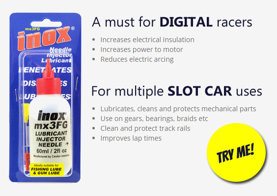

I just bought Inox MX3FG, like in the picture.
FG is food grade. Different from MX3. Is this gonna achieve the same benefit as
the original MX3, it's a lot cheaper?
Which do you guys use?
