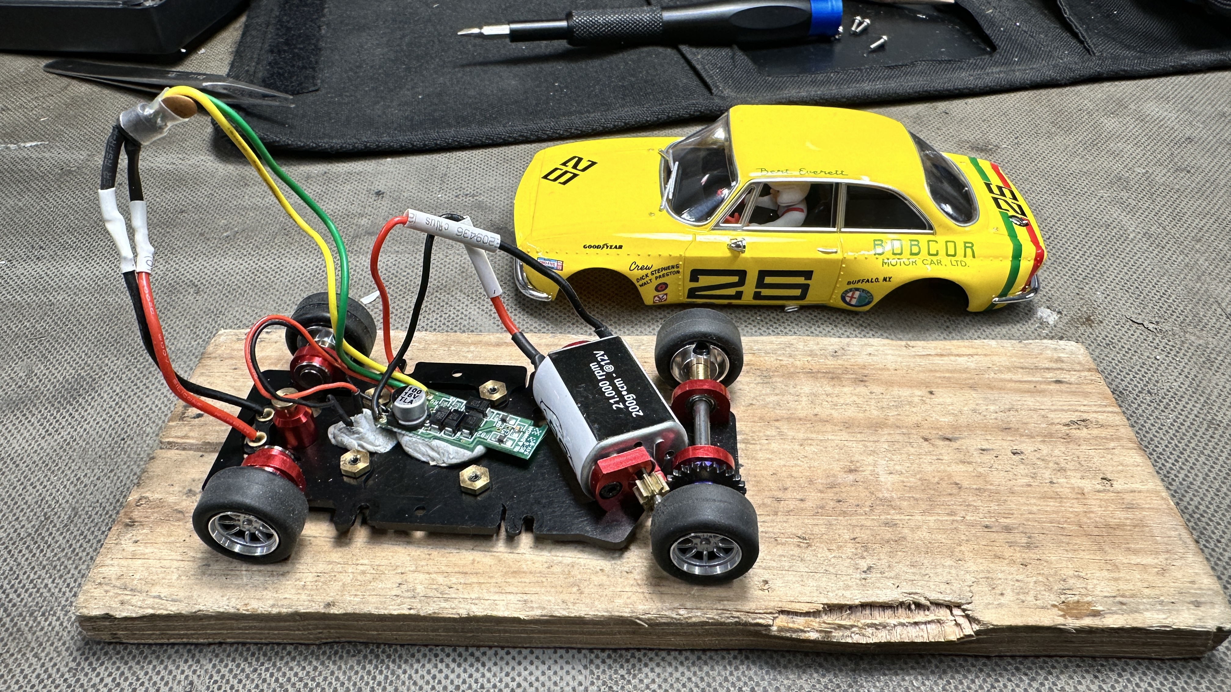

Hi
I bought a RevoSlot Alfa Romeo GTA. Trying to convert it to digital using a Scalextric c7005 module for single seaters.
Is using this module a mistake? The car runs and changing lanes fine, but only if I use minimal (5%?) throttle. As soon as I go beyond that in throttle the car stops and behaves as if it is dead. When I take it out of the slot and put it back it resets, but works the same again.
Anyone who think they can help me with this?
Thanks in advance

@niklasw
It seems like when the car is lifted from the track and put back on it is actually reseting the microcontroller in the c7005. It's possible the motor has a fault and is crashing the microcontroller with electrical noise. If this is the case then this motor will damage car decoders.
A good test is to run just the motor on a bench power supply and measure how many amps it draws compared to another known good motor of it's type. Another test would be to run the motor in an analog car and see if it gets excessively hot with moderate speed. Also check the commutator for excessive wear if the motor has had a lot of use.
If the motor checks out 'ok' , fitting a "ferrite man" to the motor may improve things.

Also as you can see in the original picture I only have one 'ferrite man' and for the next step I will make sure to add a 2nd one on the motor side.

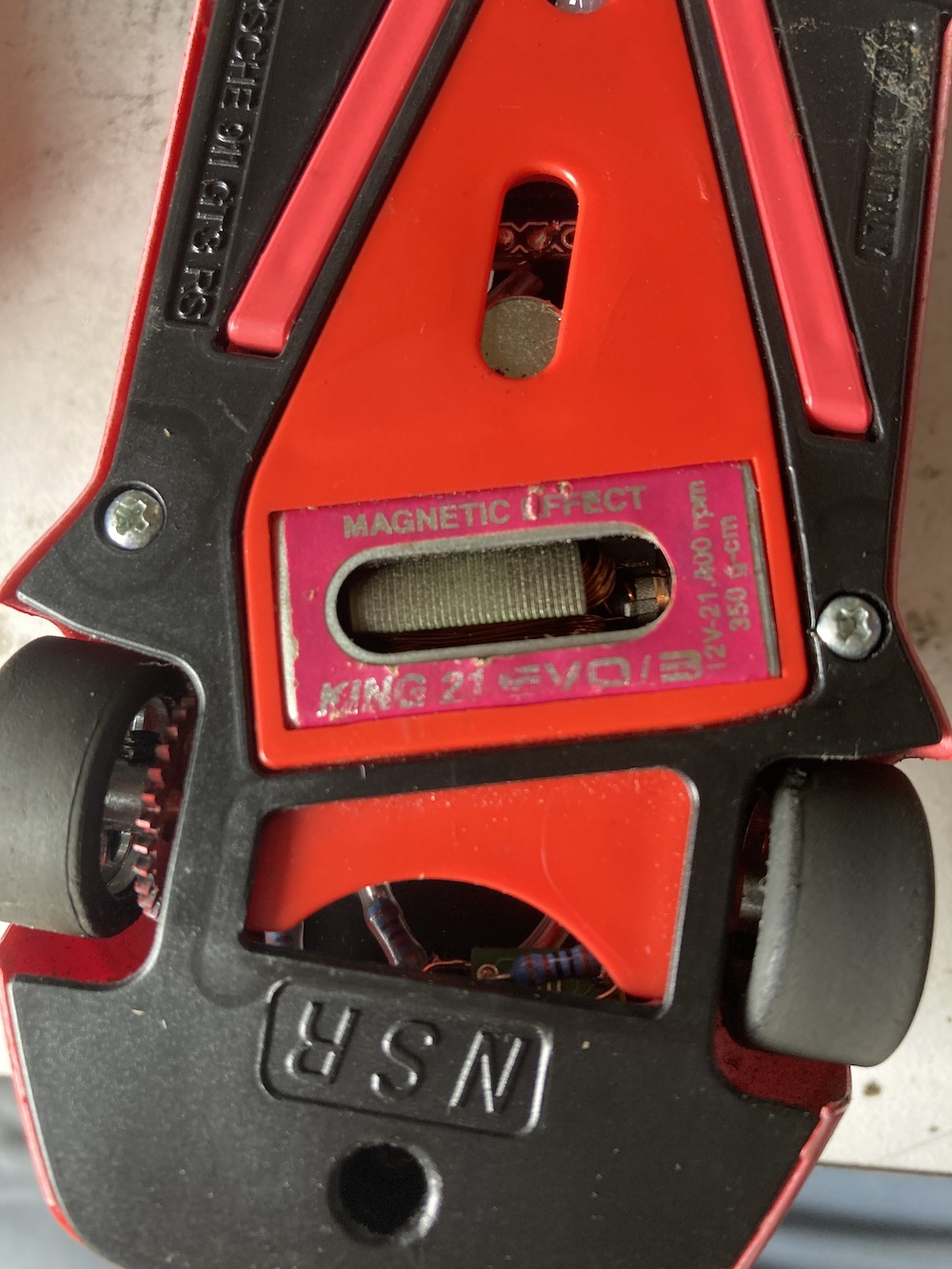

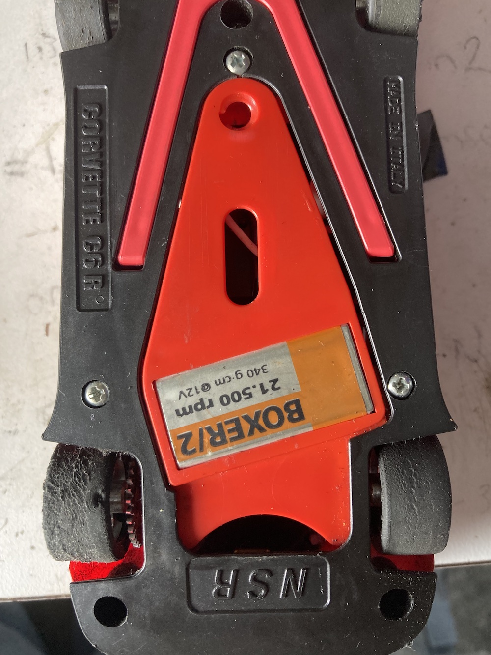

I just tested a couple of motors at 12v, I don't have any like yours but for general comparison here goes..
This one 0.350 amps at 12v free running on the bench
This one 0.250 amps at 12v free running on the bench
Another motor identical to the Red one in the first photo sparks when connected and pulls 2 amps then settles to 0.95 amps and smells like a something is getting hot. It's also noisy, like it needs oiling or something. This motor is "expired".

(17th-Jan-24, 05:30 AM)Drifter2 Wrote: Another motor identical to the Red one in the first photo sparks when connected and pulls 2 amps then settles to 0.95 amps and smells like a something is getting hot. It's also noisy, like it needs oiling or something. This motor is "expired".
Sounds like a burned comm/brushes, you can resurrect by cleaning with contact cleaner spray and carefully poking a wooden toothpick along the 3 slots to clean out the brush deposits but it's usually curtains once a motor has started letting the smoke genie out.
