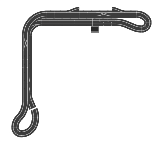

I am currently designing, building, testing and tweaking a very simple L shape Scalextric digital track to go round the walls of my office. I have very limited space, but aim for the four corners to each have a different 'feel'. There are a few Radius 1 pieces there (space is very tight), plus some Radius 2s (including a curved lane changer), six Radius 3s and two Radius 4 pieces. You have more space, so can be more creative!

(5th-Oct-19, 07:29 PM)Skogis Wrote:  Can you post a picture of the track you working on?
I should probably post these in another thread so not to distract from your planning process... but here we are:

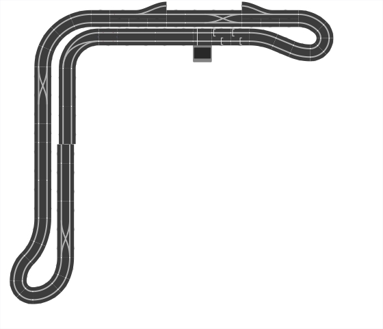

I am very limited with space - the track needs to hug the walls. I have tried out the corner combinations and quite like them, but am struggling with various compromises with elevation (tucking one straight under another) or losing another foot (30cms) of space in the room. I started with the plan of two-layers, but am now tending towards more side-by-side with just a little elevation for aesthetic purposes. Anyway, I will start another thread...

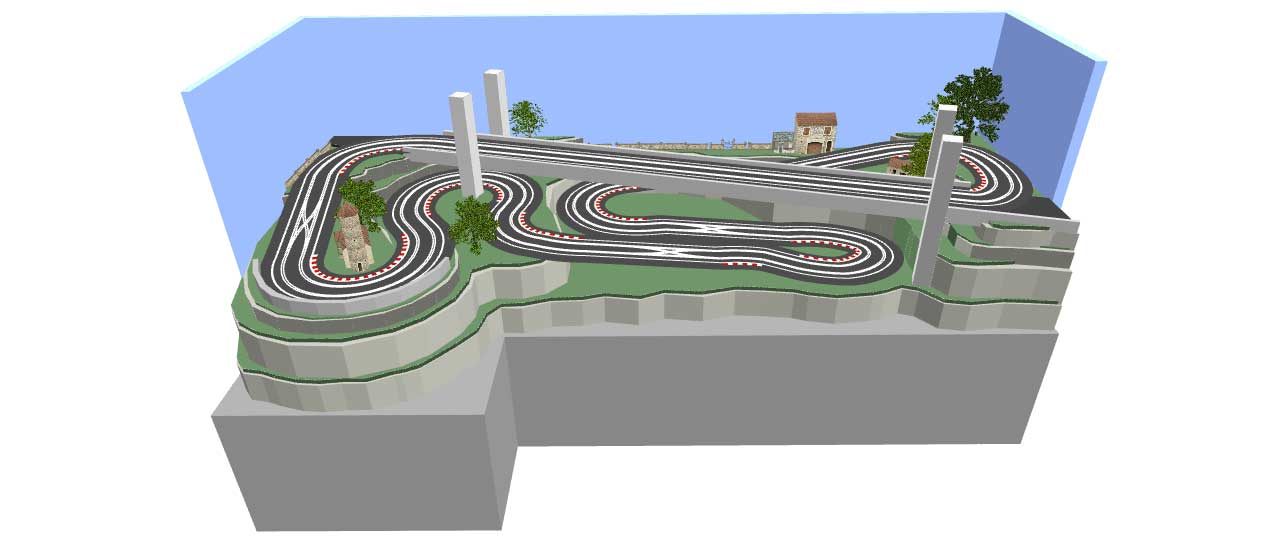

I always find T shaped tracks difficult to design, because the leg of the T always seems to make things awkward. However, if it's possible to make your layout more triangular, then more options open up. This one is 3.7m x 2.4m and has a 20cm elevation change, rising towards the back of the layout.

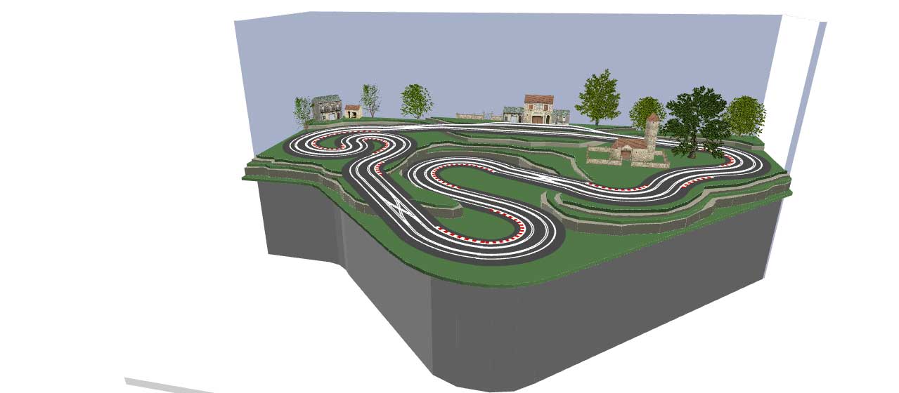

This one is actually larger than you have space for, as I started it before your update. But it could probably be adapted. It's 4m x 2m, and has an elevation change of 50cm. It  should probably have another lane changer at the end of the bridge.
Thank you Jason for these tracks. The first track you posted that looks like a triangle did really speak to me. it left room to reach from each side and also contains some scenic patches. That's a big plus.
The elevation isn't as high as I want it. But I am sure it is high enough since we are working on such a limited space. Important to not overdo it either. I like the tracks with difference in elevation because I think it adds a new dimension of the whole track and scenery.
I like the turns that are on the left so I can make them part of the climb up on top. That looks really nice.
