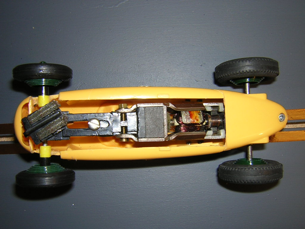

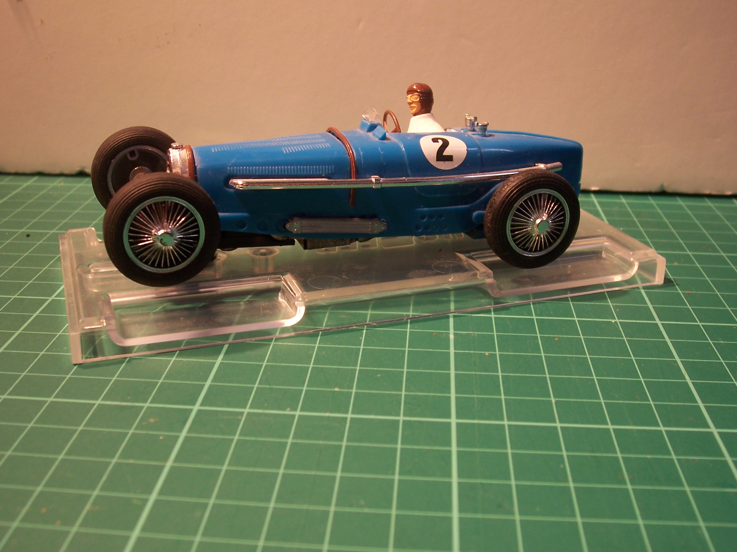

However, in the powersledge thread I mentioned that Scalextric used Bugatti bodies to test out their new power train and it is perfectly possible to convert the Pink-Kar version to this type of motor which will transform its handling and give you a very nicely performing, if somewhat sedate, race car. NSCC member Mike Ronald had the original idea and wrote an article about it for their magazine many years ago. I have updated and reproduced his instructions below. Build photos provided by Clive Mills (Mazda). The full article can be found in the March 2008 journal copy on the NSCC website.

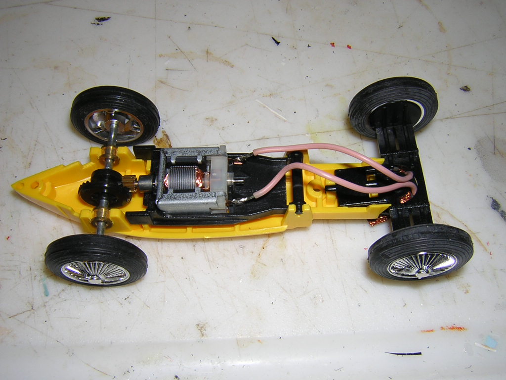

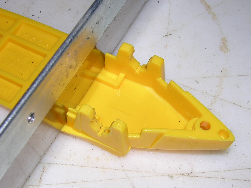

Compare underpan to photo. Cut with very fine saw and deburr. There is a groove just behind the original motor mount which is a guide for the cut. Once you have cut the chassis there is no going back, so take care.

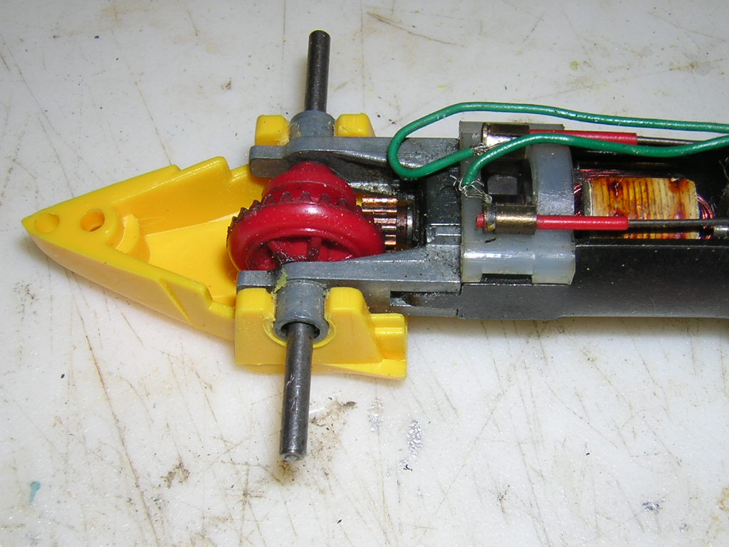

Offer up a pre-tested, strong running sledge motor - if tight fitting, open out the rear axle holder with a half round needle file. This should be done a bit at a time, as you require it to be a loose fit but not sloppy.

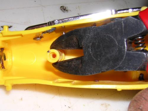

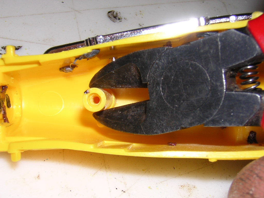

Now to the upper body - remove front body screw pillar. I did this by simply snipping away with narrow wire cutters but a Dremel will also do the job.
The powersledge rear axle is too long so replace or cut to the size of the Pink-Kar original then re-assemble body top to the short underpan and sledge motor. You will find the guide sliding bit has to be at its shortest, which puts the guide nut in-line with the radiator. You may find that the nut on the side of the motor just fouls the bodywork - in which case remove the tiniest sliver of plastic with a craft knife to enable a perfect fit.

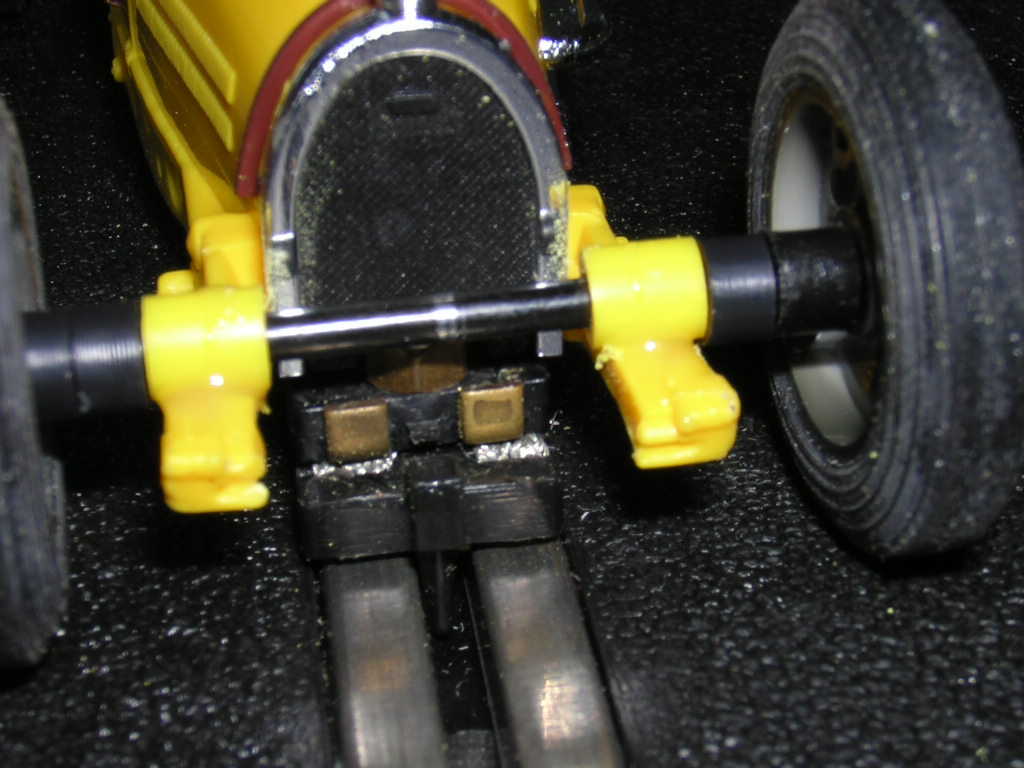

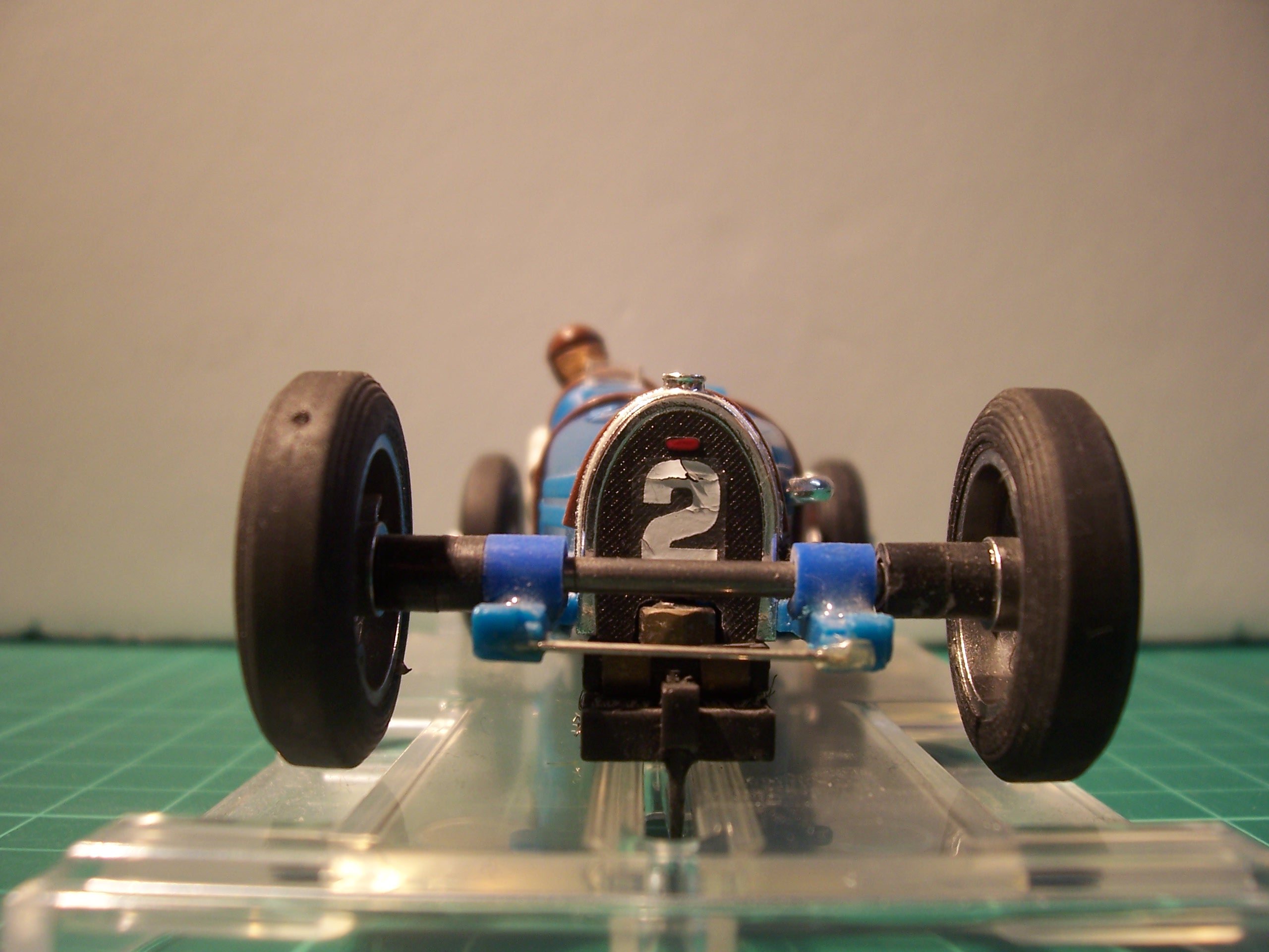

You now need some "HAMA" beads which are kiddies’ play items - they are normally used to make pictures and can be found here: LINK. Take a round needle file and make a half round slot in the two sticky out bits at the front of the body top. Take care here as there is not a great thickness of plastic at this point and over-enthusiasm in the filing department could lead to disaster. These beads hold the front axle and are glued into the slots you have just made - Araldite is best. They must, of course, be horizontal so insert an axle with wheels and check before gluing. The beads come in all the Pink-Kar Bugatti colours so no painting is needed. Use two black beads as spacers on the front axle.
The front Pink-Kar wheels are a push fit to stub axles so will need to be drilled out to fit a standard axle. If the front wheels do not quite touch the track then you will need to remove a small piece of plastic from underneath the cockpit (driver) to enable the powersledge assembly to sit a little higher.

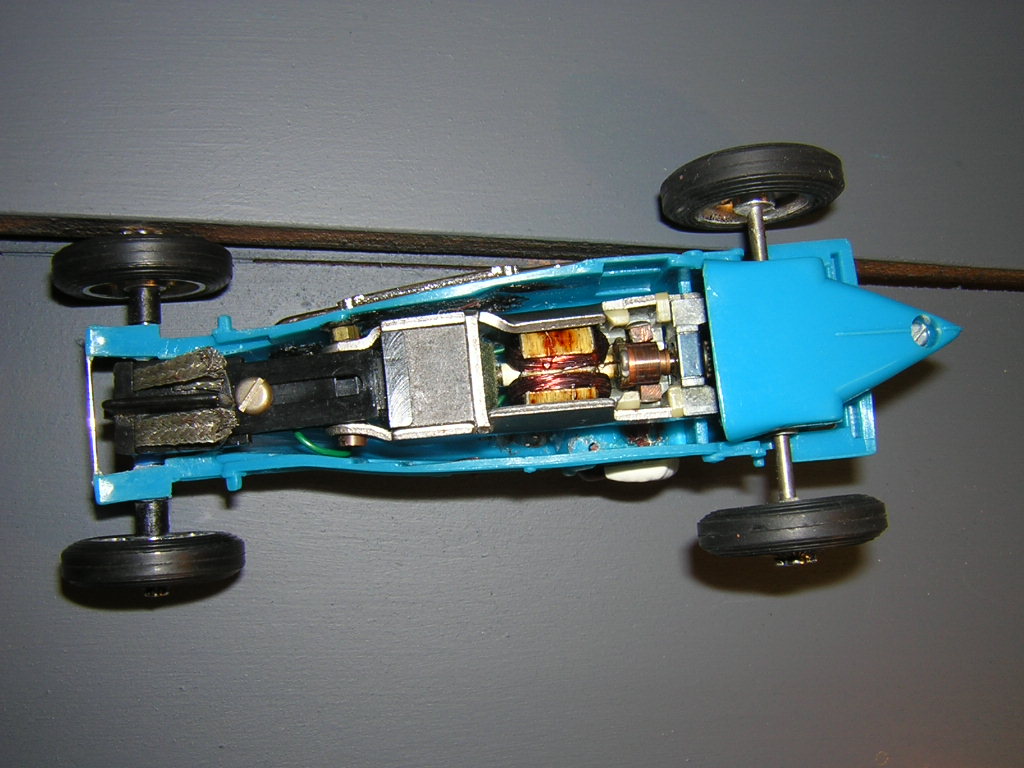

The powersledge motor has been much maligned but a good one has a reasonable turn of speed and is perfectly suited to these cars. The finished version is a delight to drive but don't forget that the motor is ancient and keep the voltage down to 12 volts at the most.

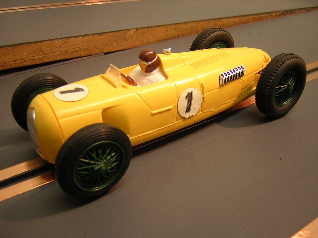

And Finally............ if you like the result then the Pink-Kar Auto Union can also be modified in similar fashion.
