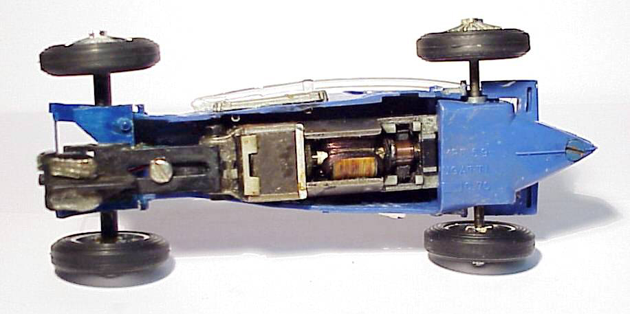

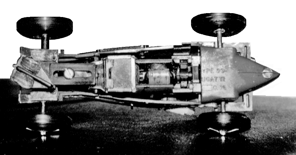

A clever and innovative design, the sledge used a number of specially modified components. It had a modified RX motor [the E8]. The pole pieces were obviously new, the armature shaft was longer and the carbon brushes were smaller. There was a moulded nylon gearbox on the drive end. The power to the sledge was provided by a metal pinion on the motor shaft driving a nylon moulded crown gear. The bulk of the sledge was made in-house, apart from the bought-outs, which would have been the metal pinion, the armature shaft and the magnet – similar to most of the bought-out items with the RX motor.

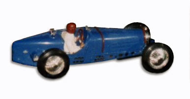

It’s known that spare Bugatti bodies were used in the original testing but train bodies may also have played their part.
The sledge would virtually go round on its own without a car body! You could put anything on top of that – even a locomotive body if you could achieve a method of holding it on! The sledge was a good design because it held the track. It hinged from the back, you clipped it in and you could almost change bodies at a pit stop.
