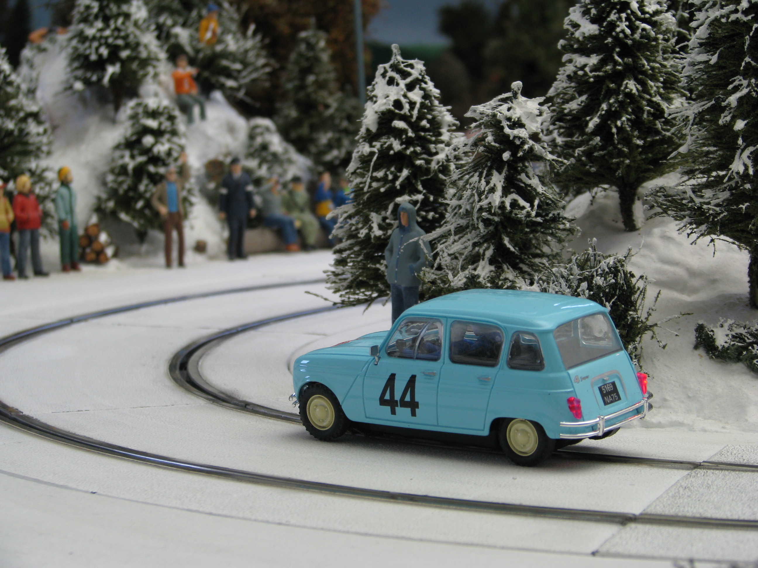

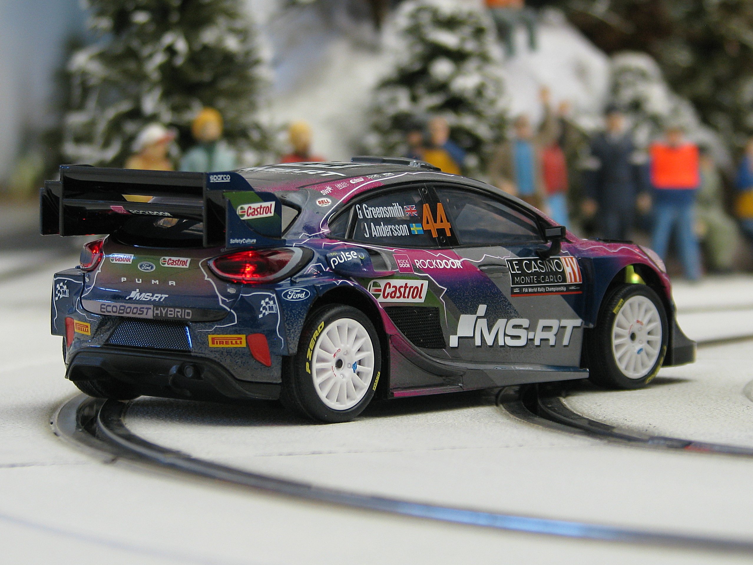

After degreasing the Scalextric Classic track sections, I simply applied a coat of white wall paint, to get a snow effect. That paint has now lasted for about 25 years.

The track, and layout, still look amazing
Renault 4, way to go Hub! Great fun on the road, and cool, but tricky, as a slot car
