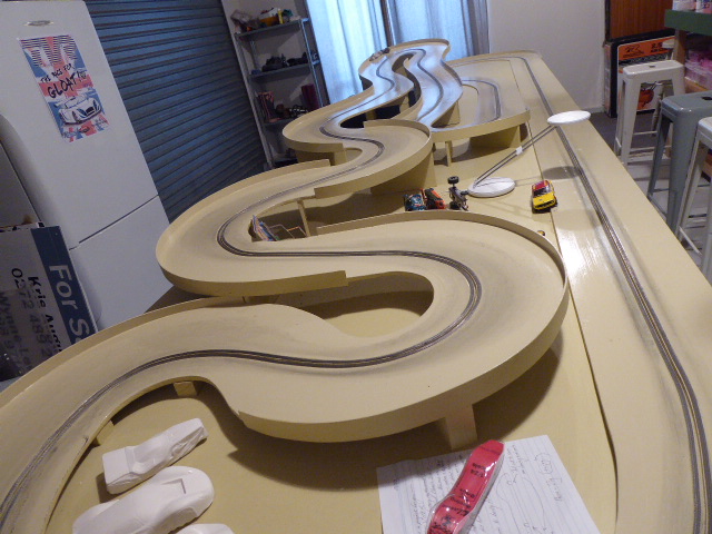

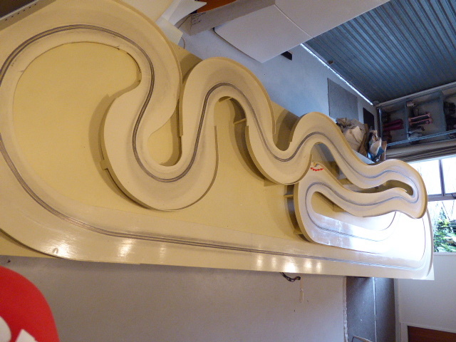

I have built four routed tracks, each one to fit a new space as I have changed premises(house) The available space can dictate things somewhat.
Other thoughts could be in regard to elevation and flat or banked corners.
You would think that is a harsh corner with a little rise and a little banking and a change in radius but no, things flow....the worst corner on my track is where there is a sudden change in camber and some proxy cars with shallow guides rue their time here.
Another pet hate of mine is a short straight...better to have continuous curves.
Please ignore the thingie plaster masters...I should put them away.
[+] 1 member Likes munter's post
Lovely lines there, and a perfect example of how tight, twisty corners can still flow.
Love the racing line, and if there's a straight heading out of picture to the bottom right, even better.
