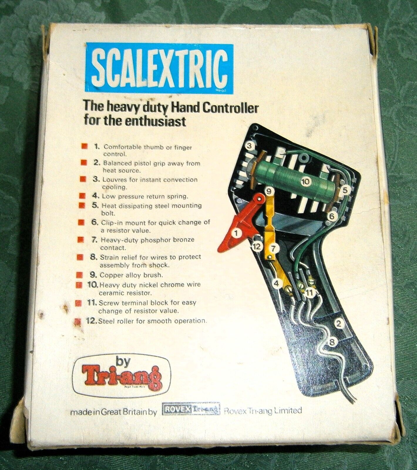

Cheers Brian. They certainly look robust. The instructions mention ability to easily change resistor assemblies but I have never heard of any alternatives being available.
Probably to low ohms for standard modern motors but I'm really looking at them being part of the Scalextric story. I guess I would need to get a race-tuned car to get the full experience and then get the motor re-zapped...
Photo credit to Ebay seller.
