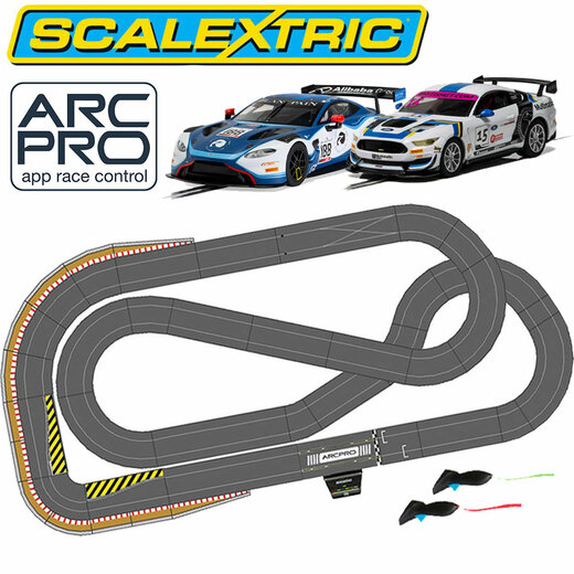

HELP! Just bought a Jadlamsracingcars Set called SL2 2020 ARC PRO for my young grandchildren.
To my surprise got both cars working on both tracks first time! BUT - once I connect the BLUE - TOOTH  ARC PRO App (ALL Green Lights) and get into the 'calibration' screen  NOTHING WORKS! Does anyone know what TRACK I should choose?  As it might simply be that. (Am putting in ARC PRO)

The Jadlam SLS sets are great -  nice step up from the basic sets. The SL2 is particularly nice as it has a mixture of standard R2, tight R1 and fast R3 curves - something you never get in basic sets.
This is the 2021 version. Did you get those two cars? Or are they different in your set?
