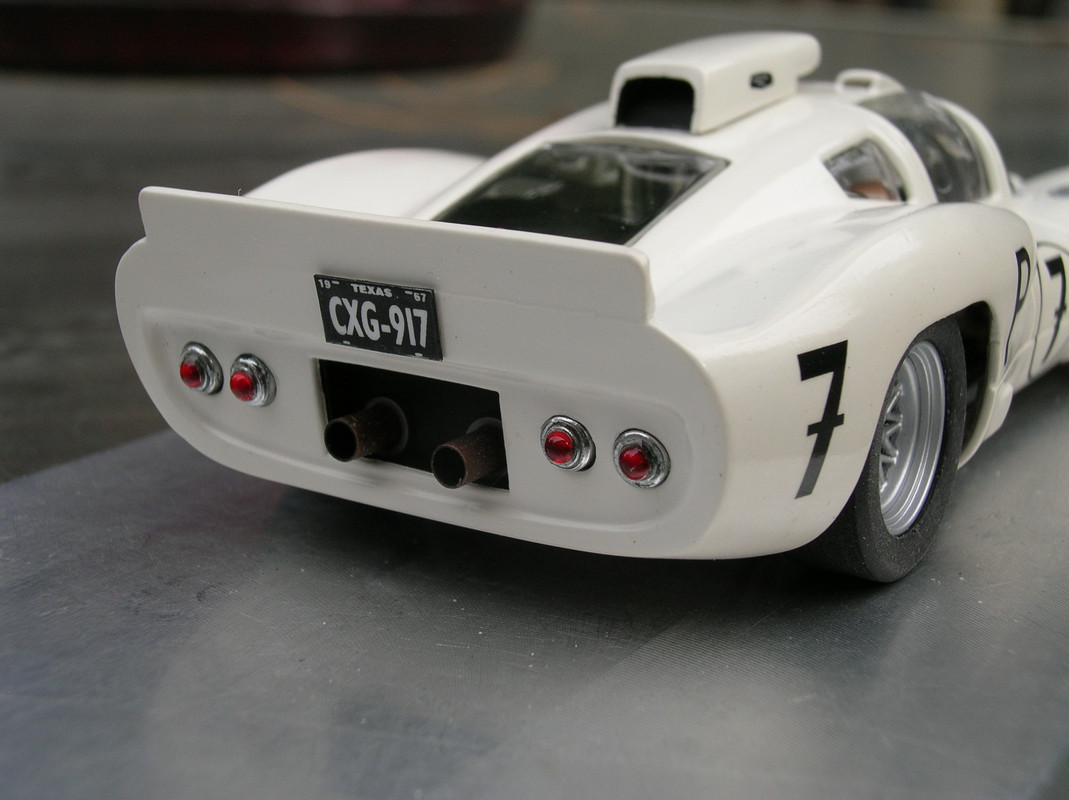

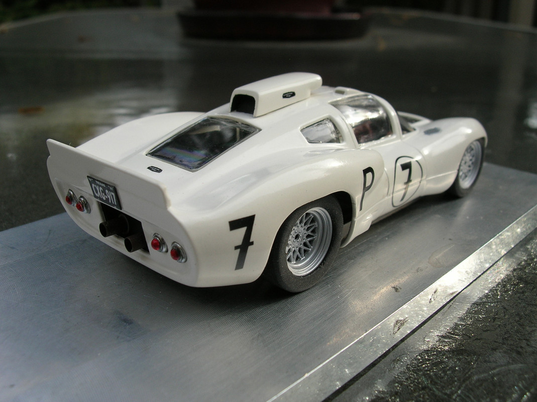

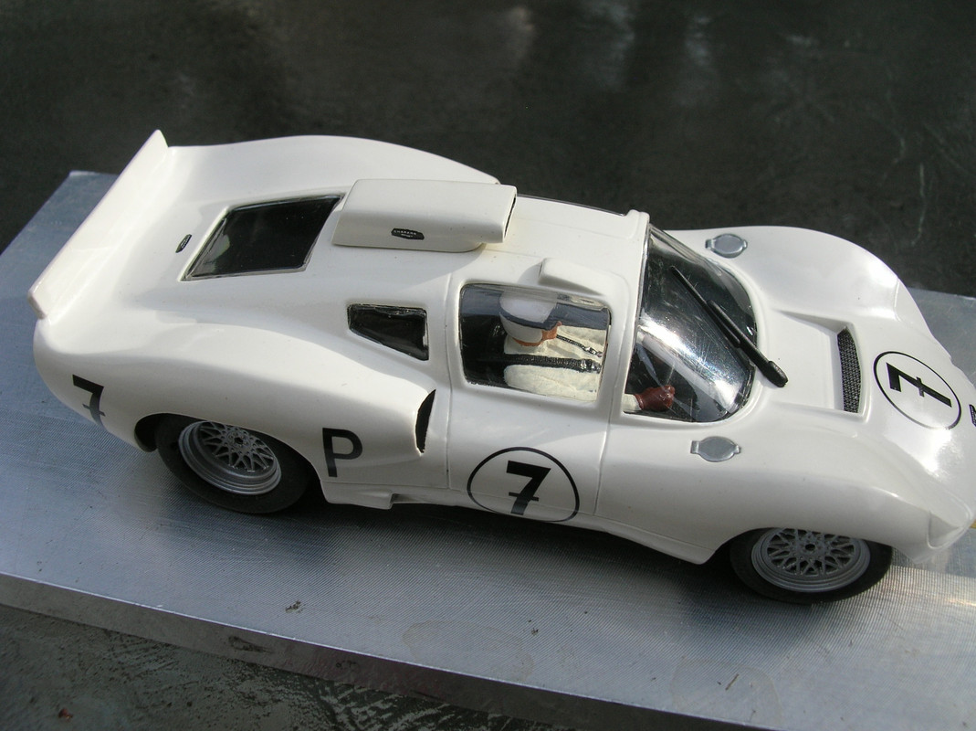

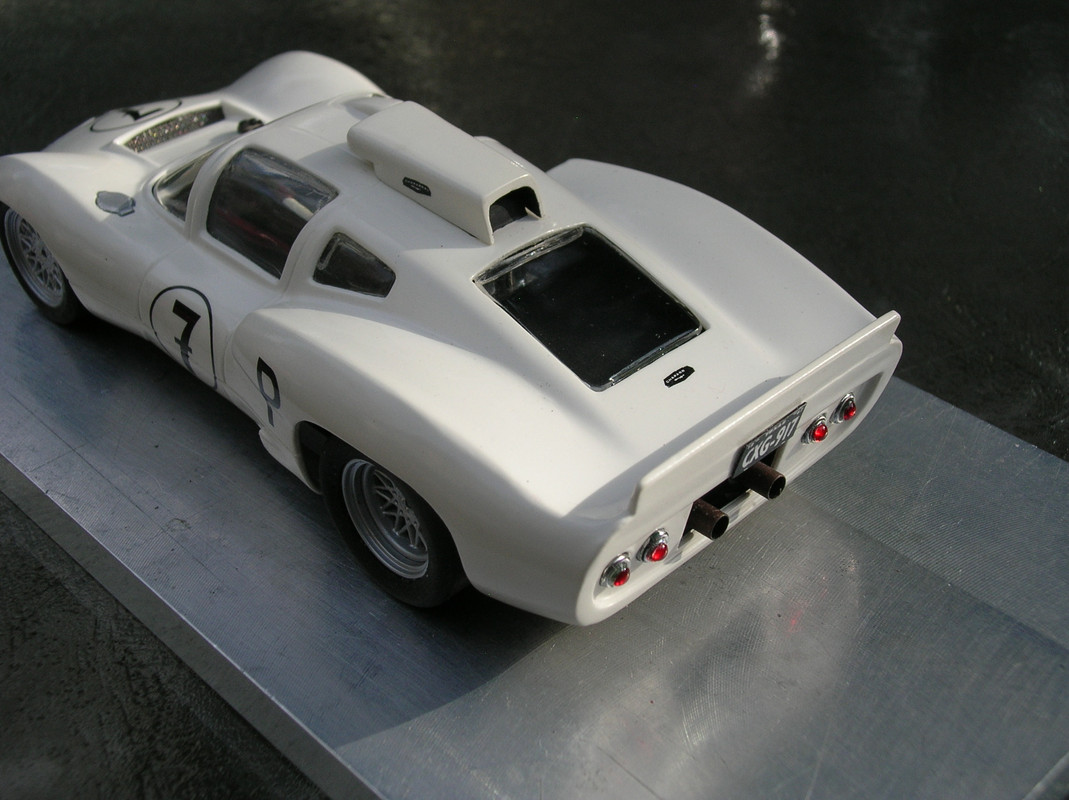

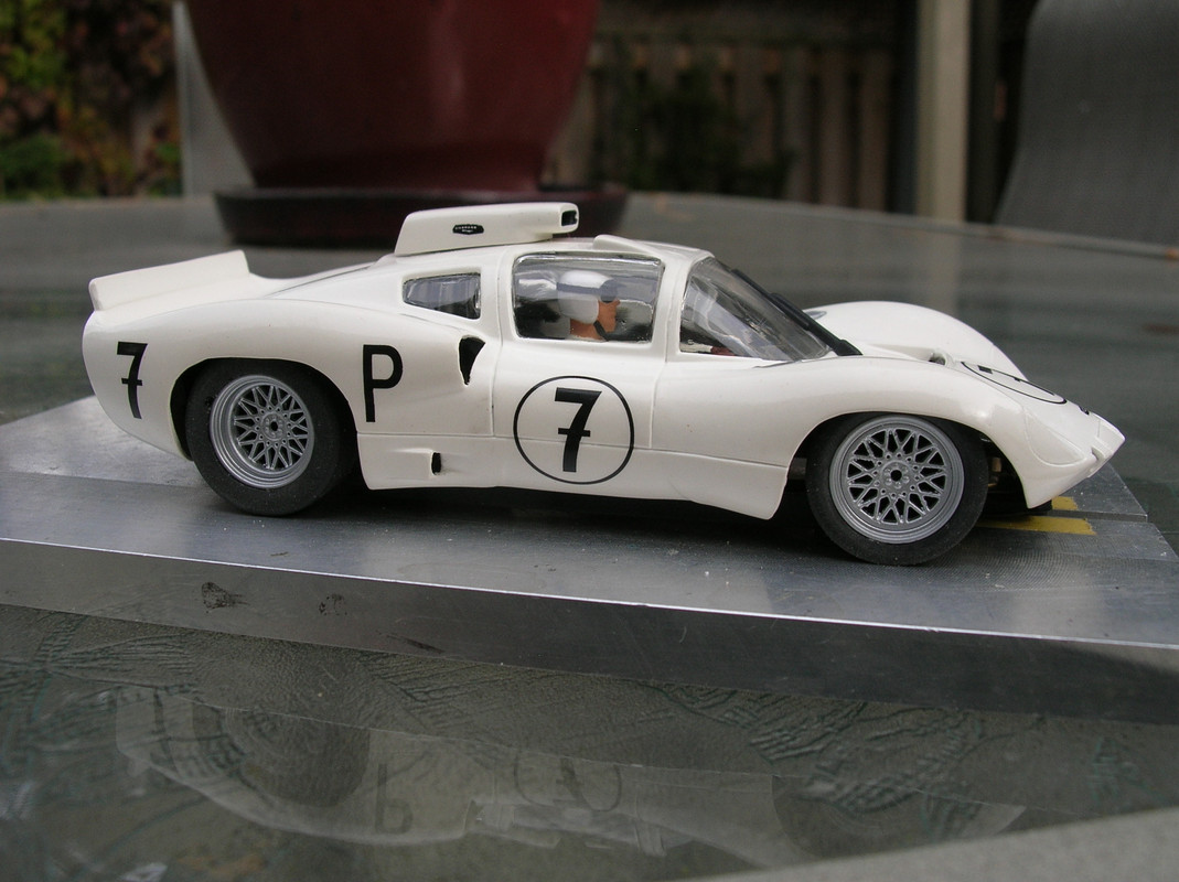

Finally finished the 2D.................
Chris Walker
[Image: DSCN4976.jpg]
[Image: DSCN4972.jpg]
[Image: DSCN4956.jpg]
[Image: DSCN4963.jpg]
[Image: DSCN4964.jpg]
[Image: DSCN4971.jpg]
[+] 6 members Like chrisguyw's post
