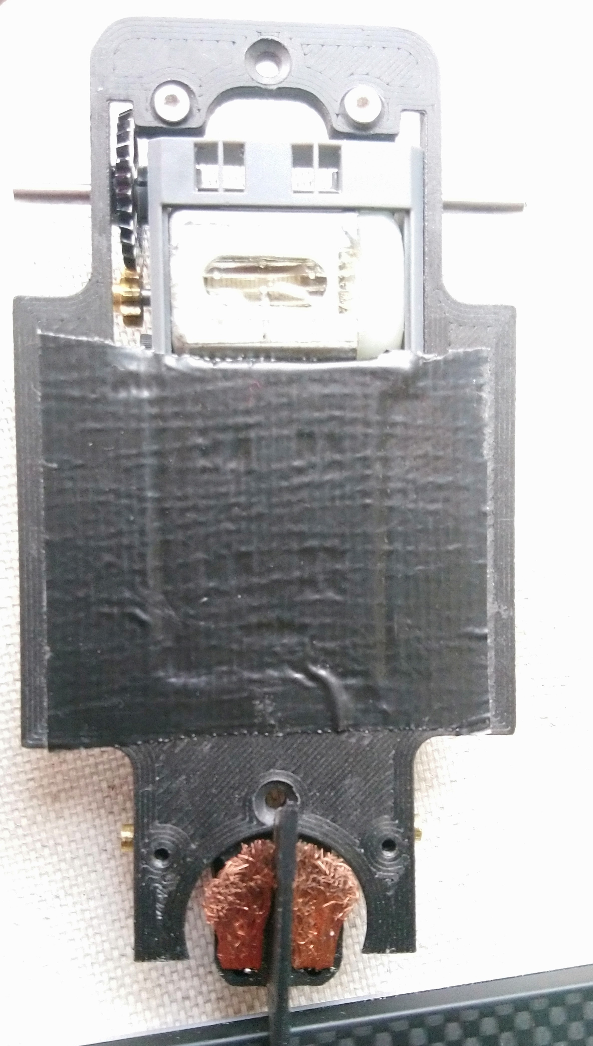

Doug, here's the answers to your questions.

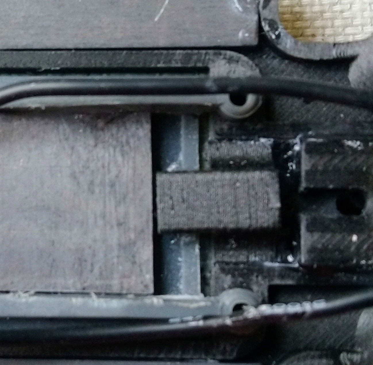

Quote:1) What is the curious black bit ahead of the guide carrier - opposite end to the body posts/spacers on the separate sprue?
2) Should the flat 'sills' on either side be cut back to the edge of the side rails, as the body sits too high with them in place but they might be serving a purpose I'm not aware of?
I think that's it for now, other than to say thanks - and I like your sliding guide holder idea. Very neat.

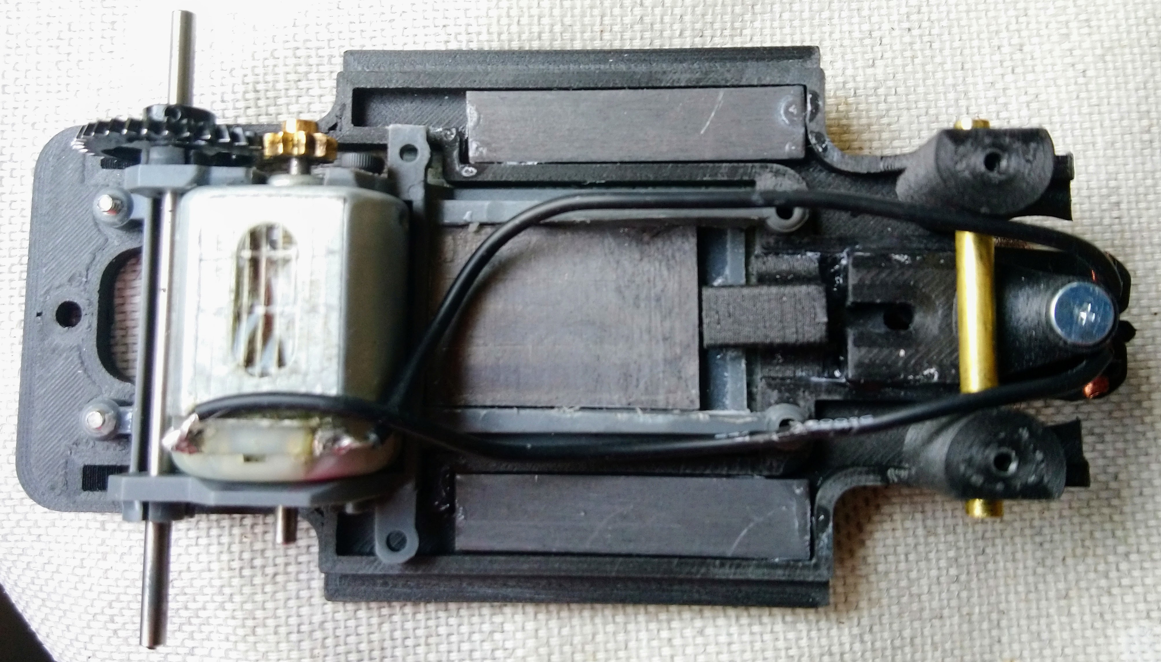

1) I knew you'd miss my note about that bit. It's an optional centre pivot that I prefer to use without the front two screws. It's glued onto the chassis to stop the front of the pod lifting but allows the pod to float freely if you use damping tape under the chassis.
Here's one I did for a George Turner AC Cobra, although this is a SW setup it's the same use. I made this one first but the car currently has an IL setup for our class rules, I haven't tried the SW setup but it'll be quicker as it's 4mm wider overall.

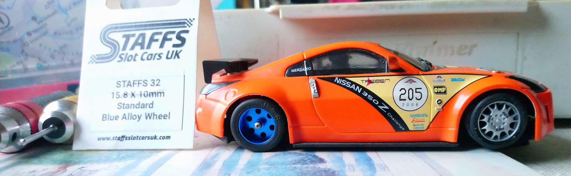

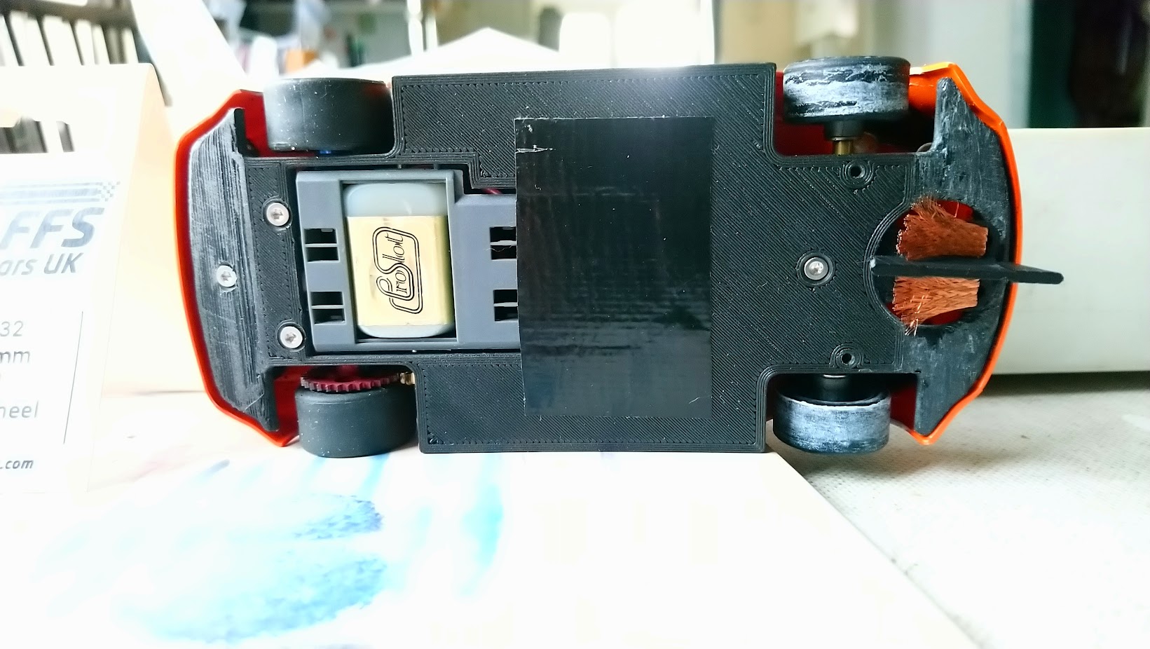

2) No, the body sits on those, trim the body posts so they're just long enough to allow the body to sit a few thou' above the sills. Here's my 350Z
