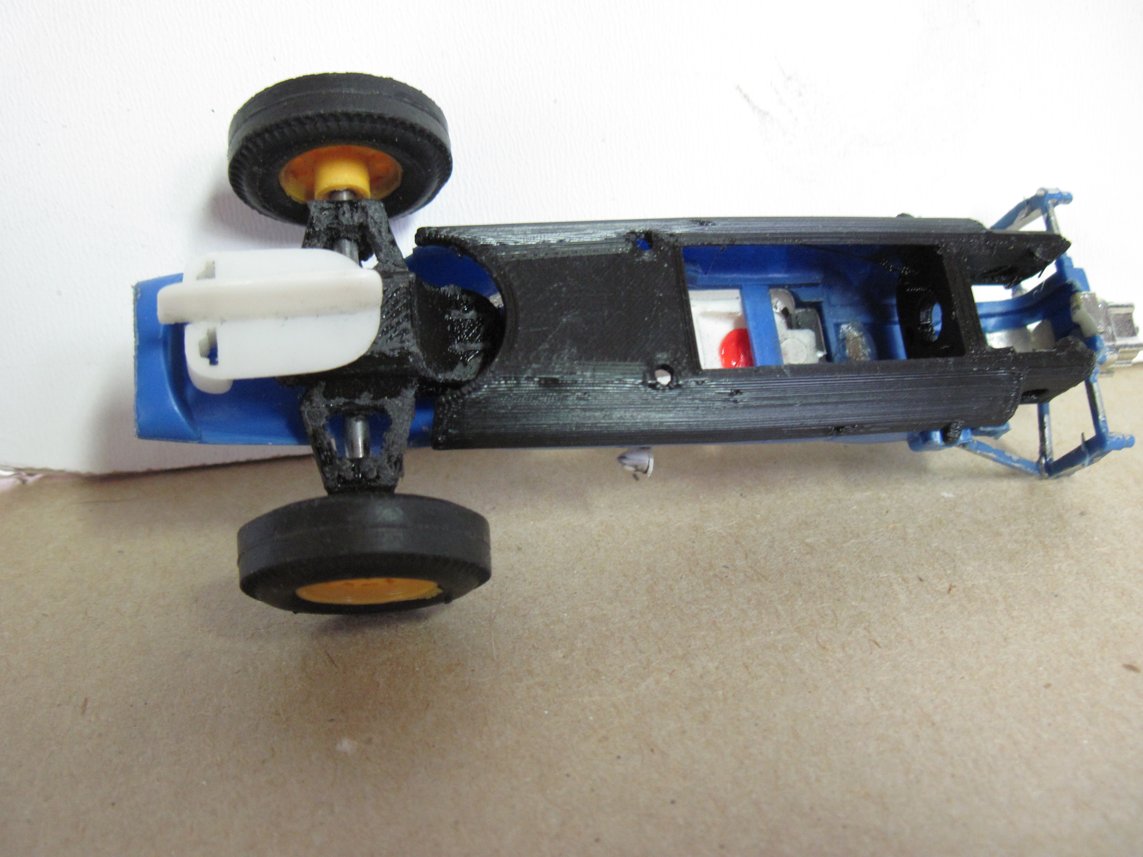

(24th-Jul-22, 09:23 AM)OXO cube Wrote:  how would one install a solid front axle ?
With some difficulty! It really needs a revised front end as can be seen from post #48 HERE on SFI from Graham.
I suppose the question is whether you want to turn it into a proper racer or are happy to run it as is with all its faults and charms. If the former then you might as well throw everything away apart from the body and start from scratch. If the latter then the wobbly front wheels won't make a lot of difference to the overall performance as the rest of it is so poor. The motor is terrible and the carbon brushes are unique and unobtainable as spares.

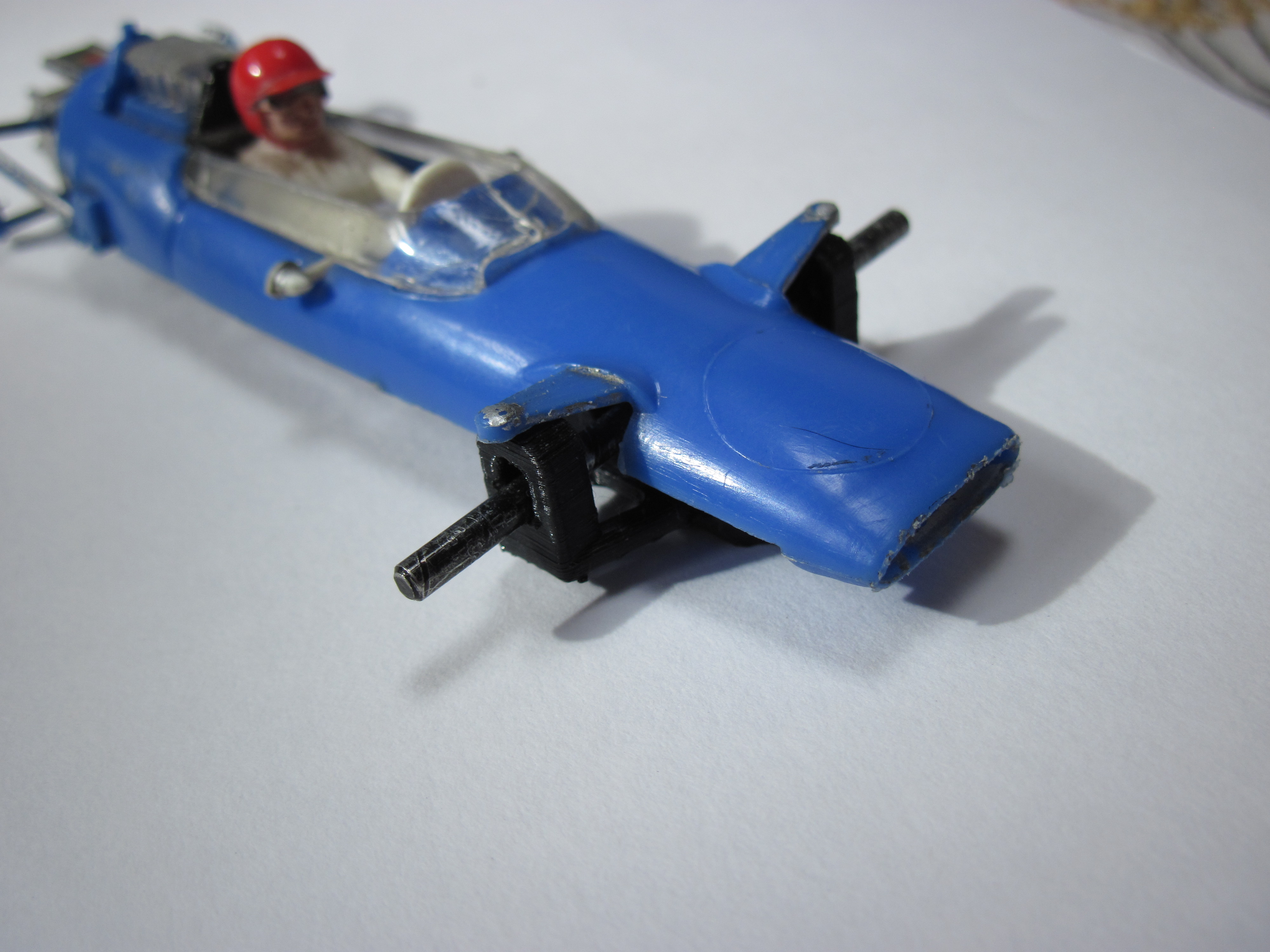

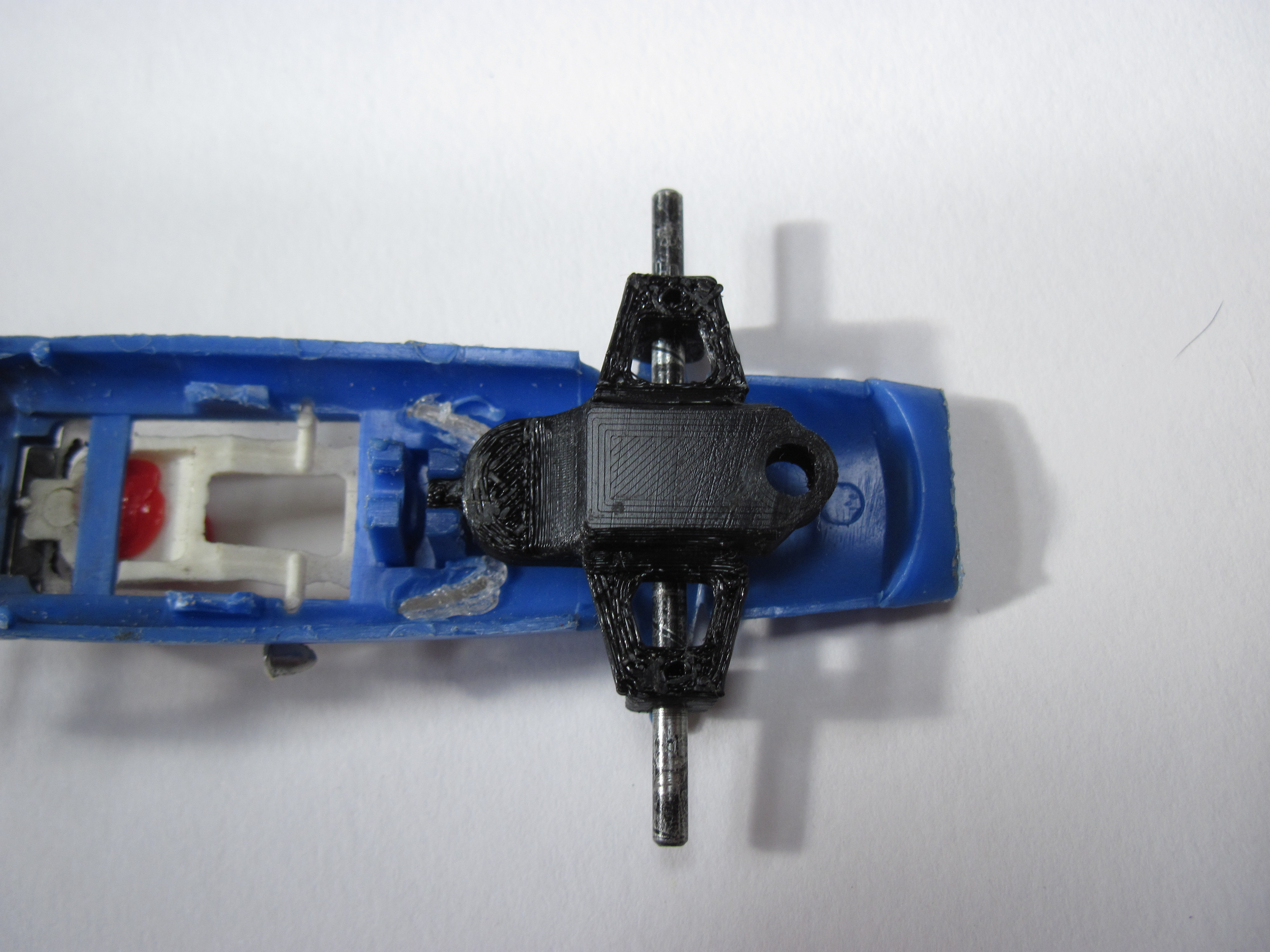

Kev,
      I can supply a 3dp front axle holder to take a solid axle which will clip into the original Scalex junior body as below, and will take an NSR blade guide.
Have a look at my JS Chassis thread under Traders and if you need any more information then use the Forum IM system.

thankyou John
i design and 3dp my own chassis , guides , body posts etc
but i must admit your idea never even occurred to me
will give it a go myself , but if i fail will contact you deffo
would be nice to get these cars running atleast somewhere near decent
will keep you posted

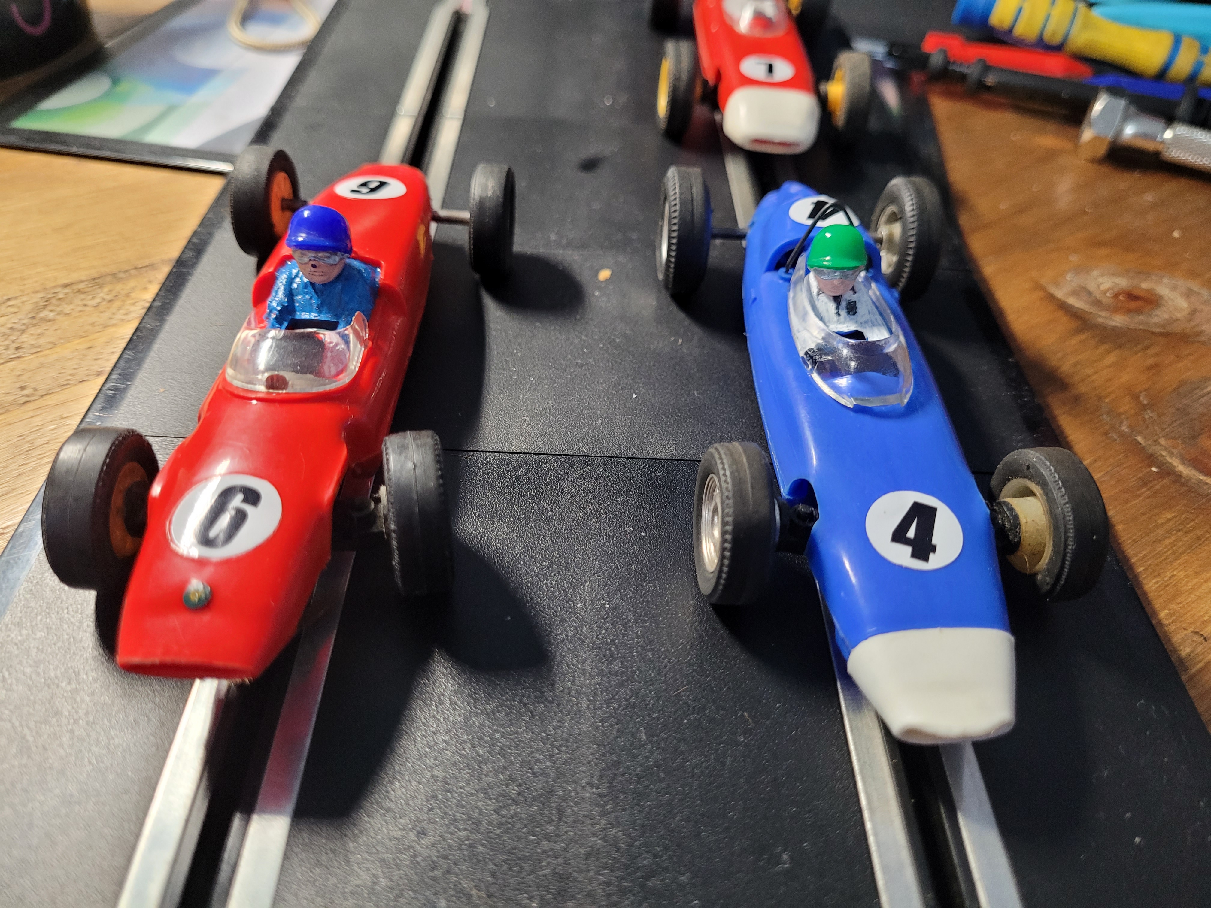

Juniors were a poor car by modern standards but so was a Ford Cortina Mk2 (or any other heap of 1960's tin) however the Juniors provided great fun if raced against one another.
I have just thrown my Junior BRM on a simple track that I have laid and I still think they are good fun cars.
To answer the OP question about the front wheel wobble, as stated else where they were always pretty loose and most of the slack on my Juniors is actually between the axle and the wheel, I would think a fix is quite possible on this.
If you want to know just how bad these things were then have a look at the last post in this thread: LINK
Very interesting account of production being completely out of control and was then rained into a good product.
I love the Scalextric Juniors.
