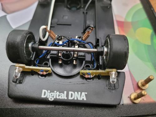

as suggested
now with minimum side to side / vertical / front / back movement
zero wheel wobble
glued and trued wheels and tyres ( zero gripped )
small trimming required to the guide holder
wheels now turn very freely , this imo is a huge upgrade to the original setup
but the proof will be when it runs against other cars
guide flag wiring may be next , because the guide centering spring can no longer be used
therefore the wires will most likely be needed to reposition the guide straight after any de-slot
but thats another story

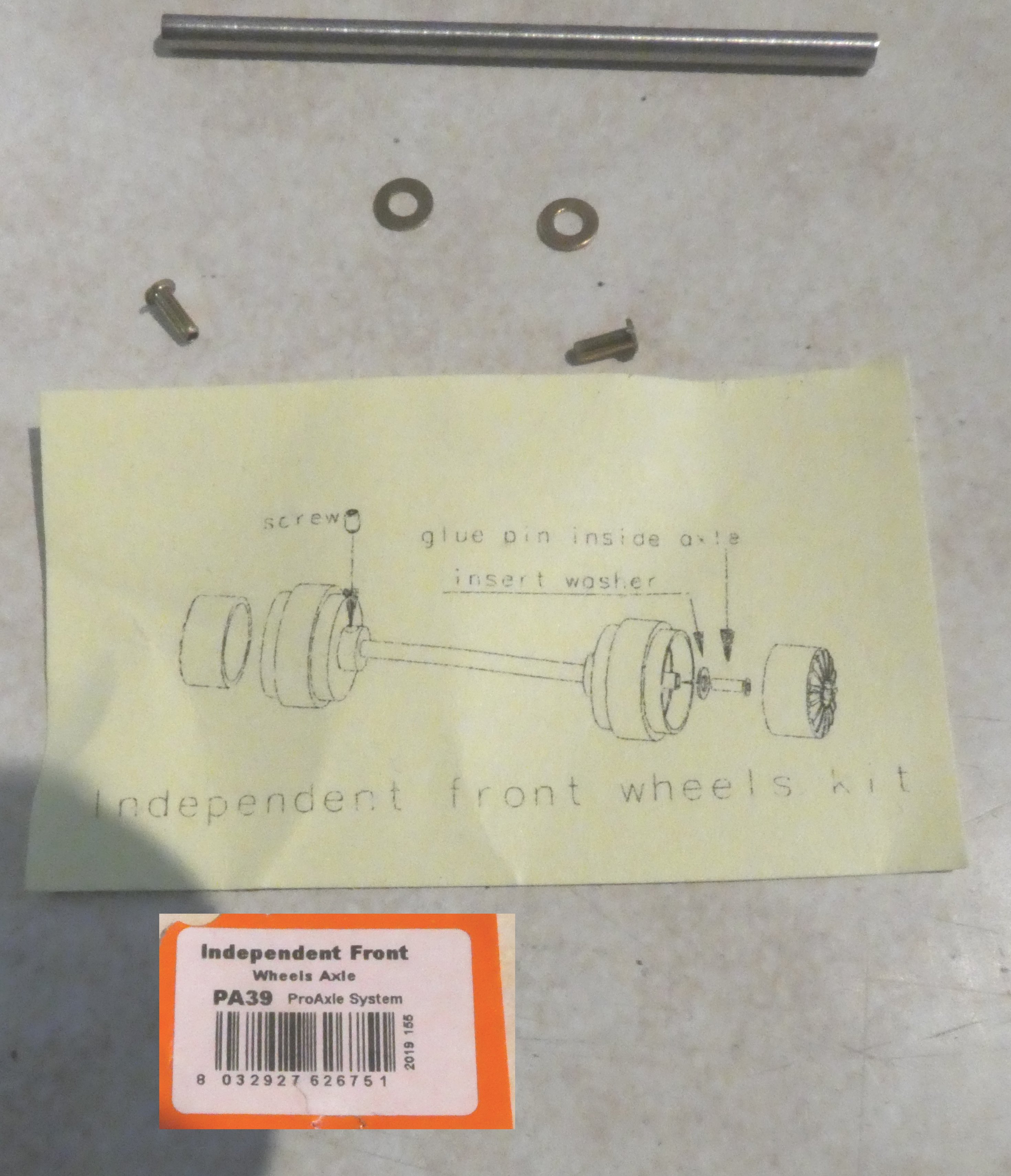

Hello Kev,
You might as well go all the way and fit an axle that allows the wheels to rotate independently.  Slot.It do a kit comprising a hollow axle with ferrules that fit in the ends with a washed to hold the the wheel in place - PA39 "Independent Front Wheels Axle". Uncle Dennis (apologies if it was Uncle  Chris !) showed on the chat a trick of having one wheel fixed to the axle and the other rotating freely.  You could do that with the PA39 kit so you would only have to modify one wheel.
Available at a Slot Car Dealer near you.
Linky to Pendle SR
thanks Leo
will definitely look into this PA39 axle kit
but for a different car
don't want to mess with the look of the plastic wheels on this car
will however keep in mind for alloy wheels where i can also add inserts  Thumbup
