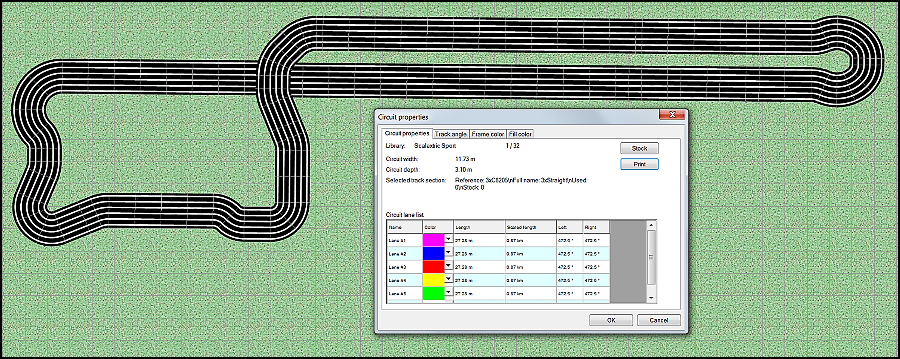

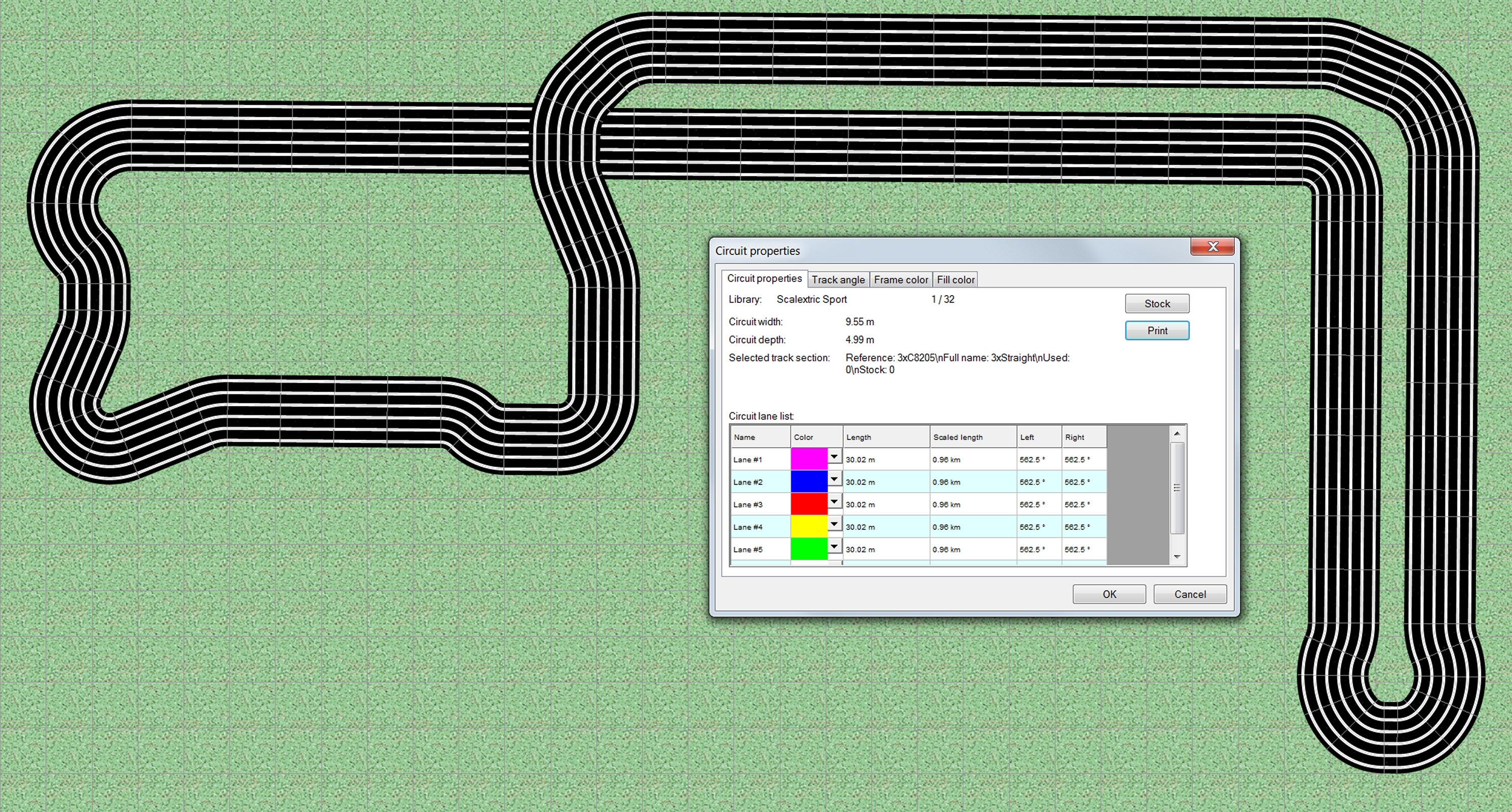

The cars would be running on these Scalextric Sport tracks at 11v:
Lap length 98'. Main straight 23.5'.
Lap length 89'. Main straight 31.5'.
