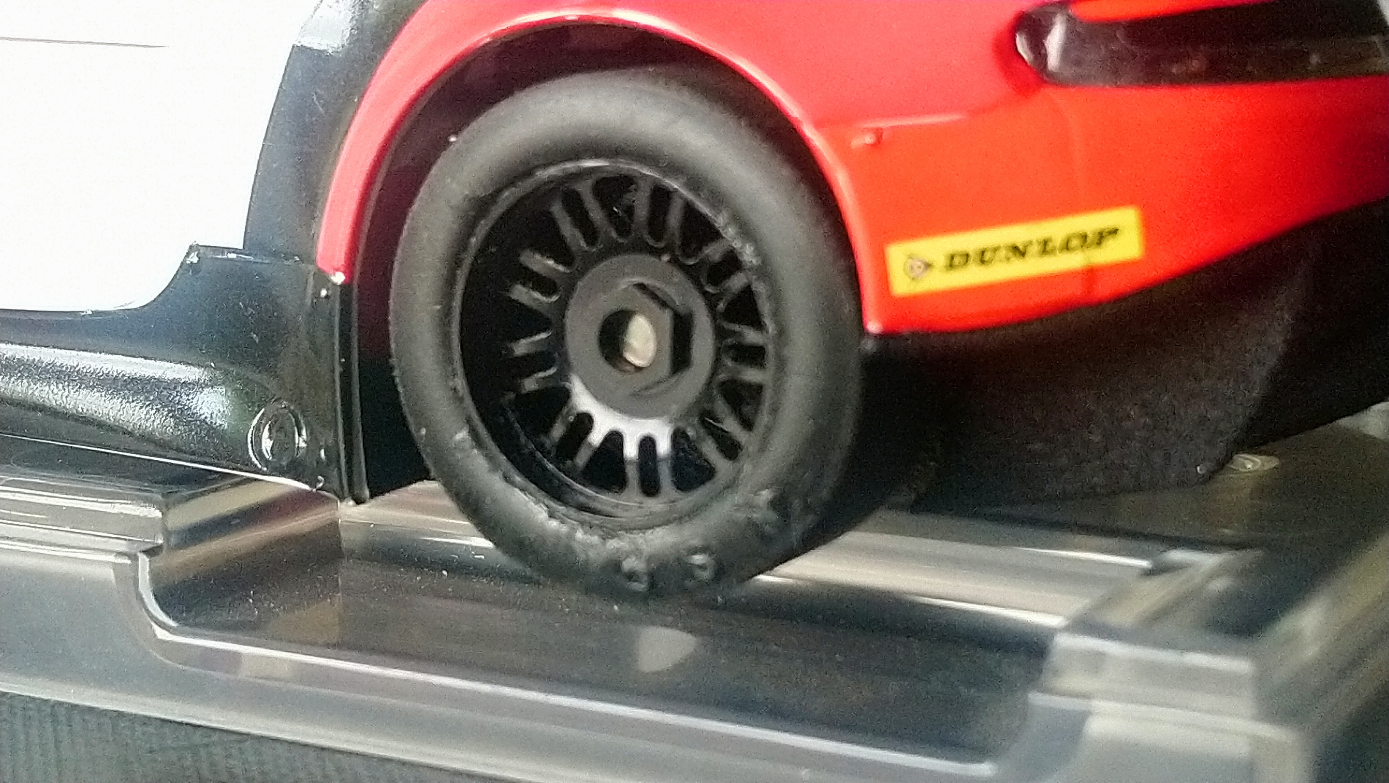

I am just finishing off a rally car white kit build. Here is the original...
Here is my interpretation, Slot.it hubs and inserts...

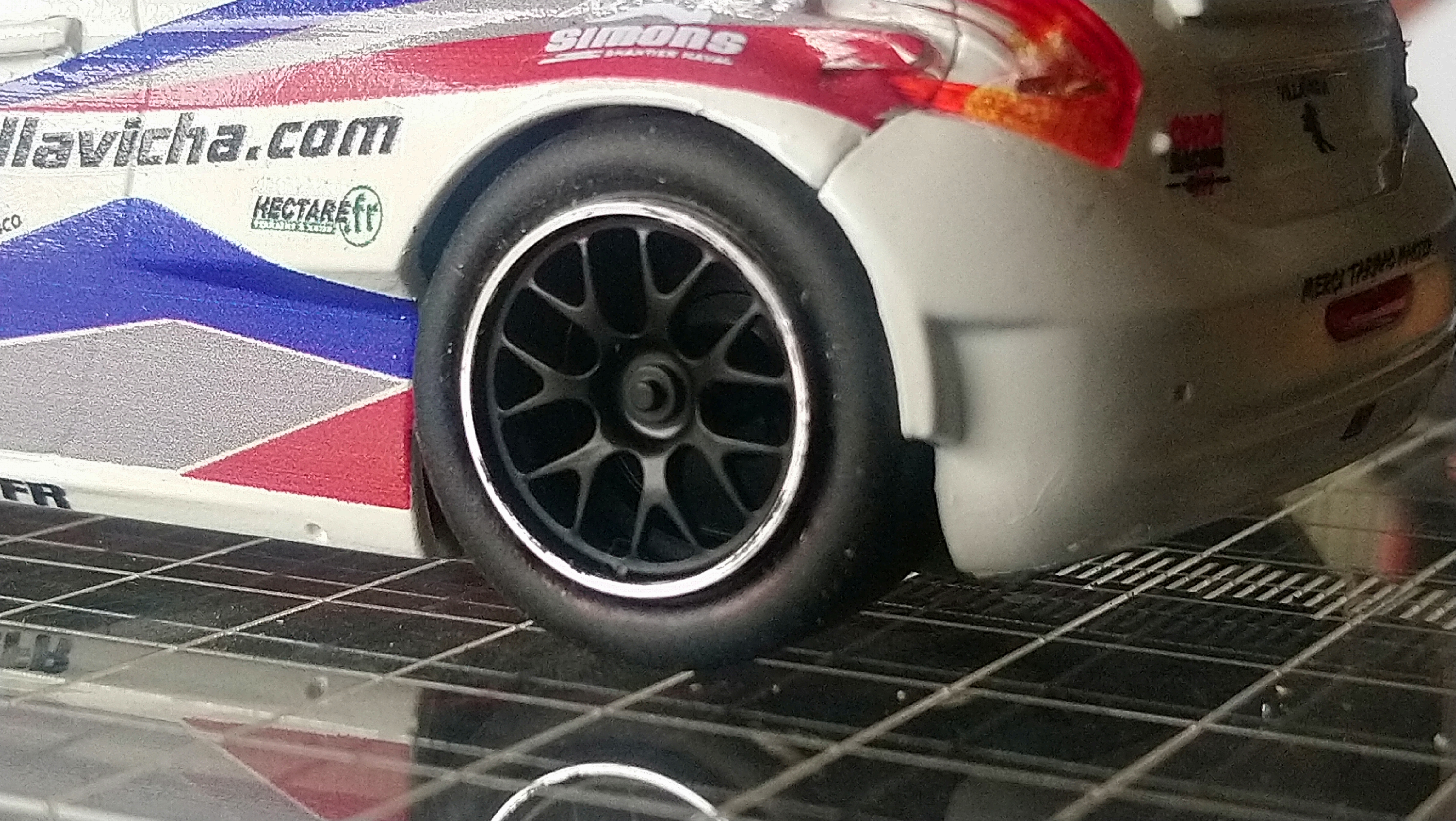

And here is the Staffs equivalent...
I really like the Slot.it BBS inserts, but I want to do them justice. And as noted by Mitch, due to the Humbrol paint's lack of adhesion, I have to live with the 'silver ring', hence my original query.
