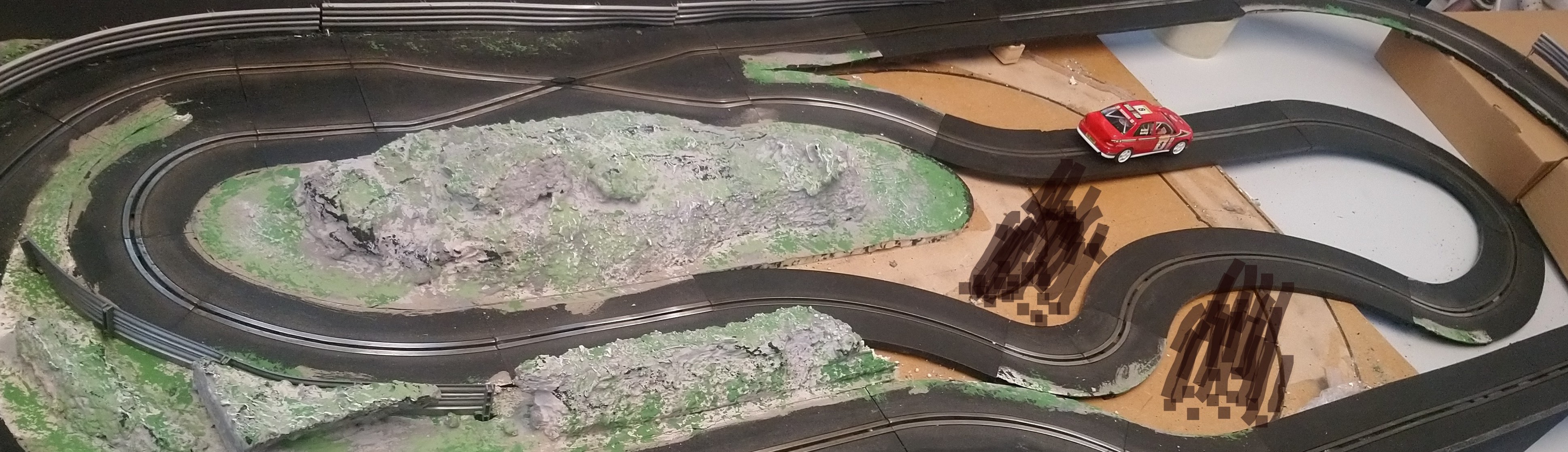

I have some ideas in my head for scenery on my forest based track I am developing...so tried to sketch it on a photo to see if I can visualize what it might look like.
So here, I am proposing two piles of felled trees to make sense of the curves in the layout...
And if possible, I'm going to make them out of real wood/twigs from the garden.

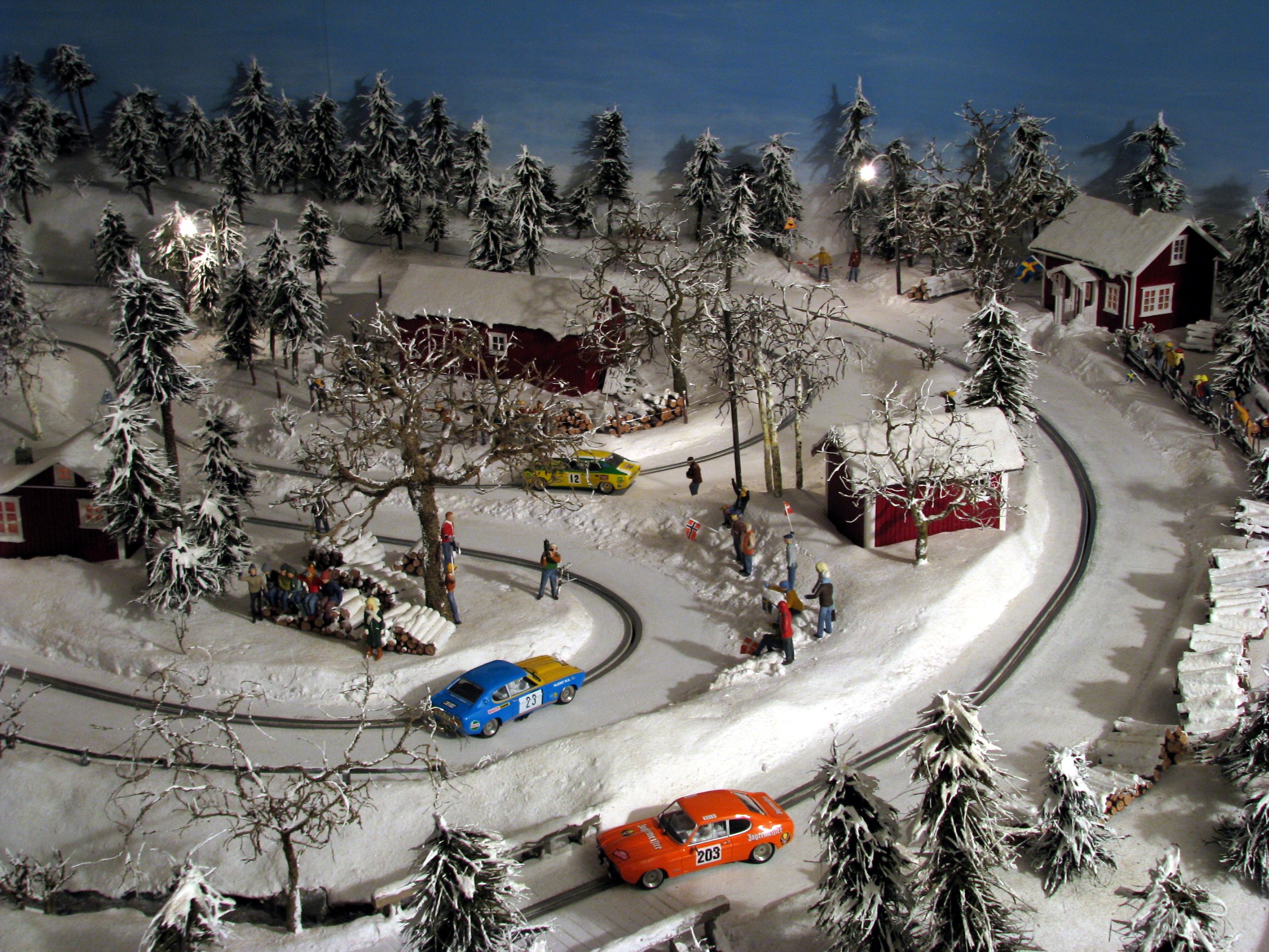

There are piles of wood everywhere on the Swedish Rally Track:

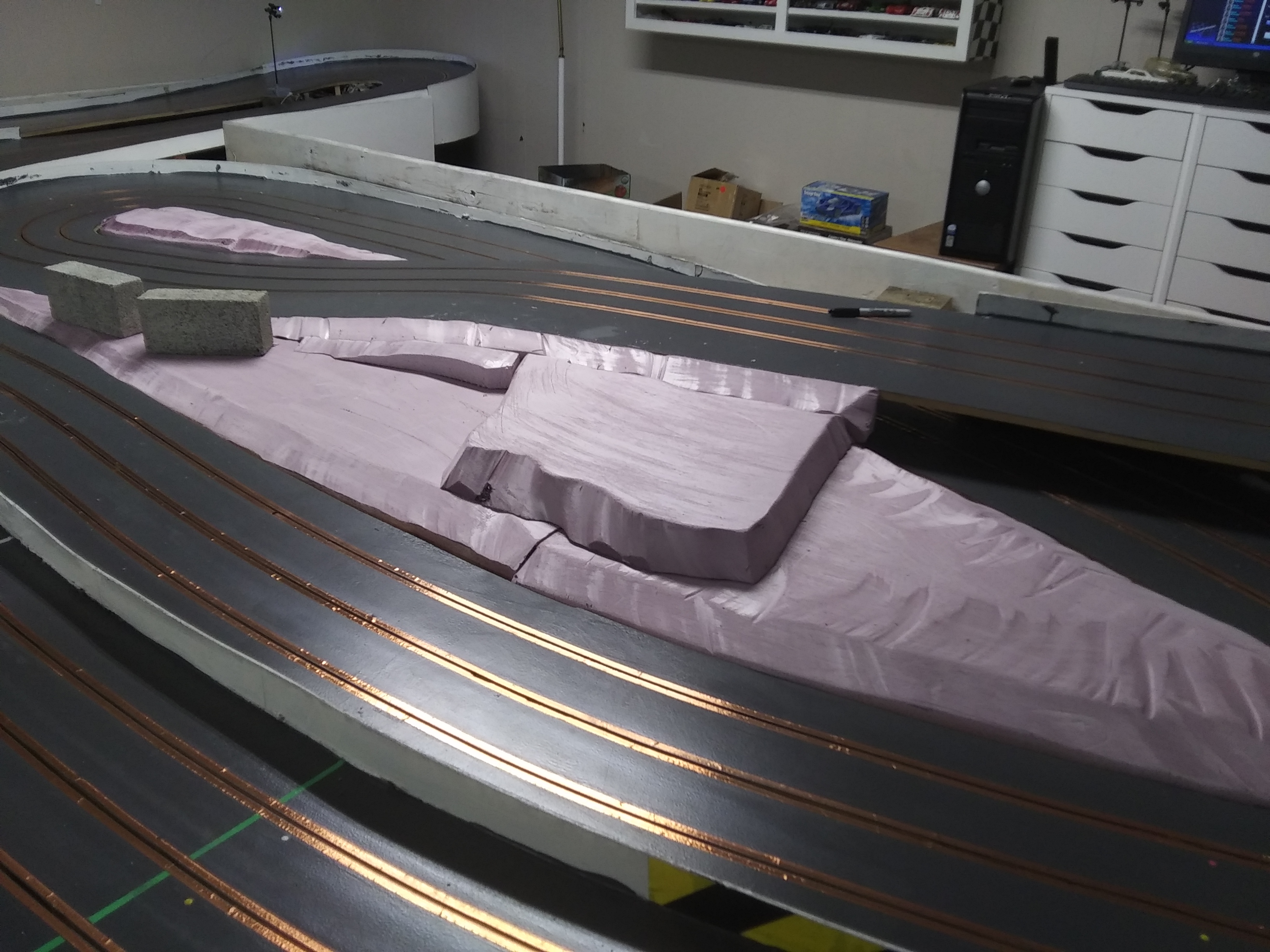

I used a roll of 7mm camping foam matt, for sleeping on. Technically 7mm thick XPE foam.
I used paper templates to get the correct sizes/dimensions,  and then just the cut the foam matt to size. Glue in place with a tub of glue designed for scenic flock matt, or whatever works for you....
Very cheap, just buy the cheapest you can find,  unless you actually plan on sleeping on it  Tease

I'm beginning to wonder whether I should NOT go flush with the track. Thinking about forest tracks, alot of them have ditches either side, and I'm thinking that having a small track with drift zones everywhere will make for a unrealistic driving speeds and too short lap times.
So on that basis, I might elevate the track on some packing in the twisty bit to create ditches and jepody!
