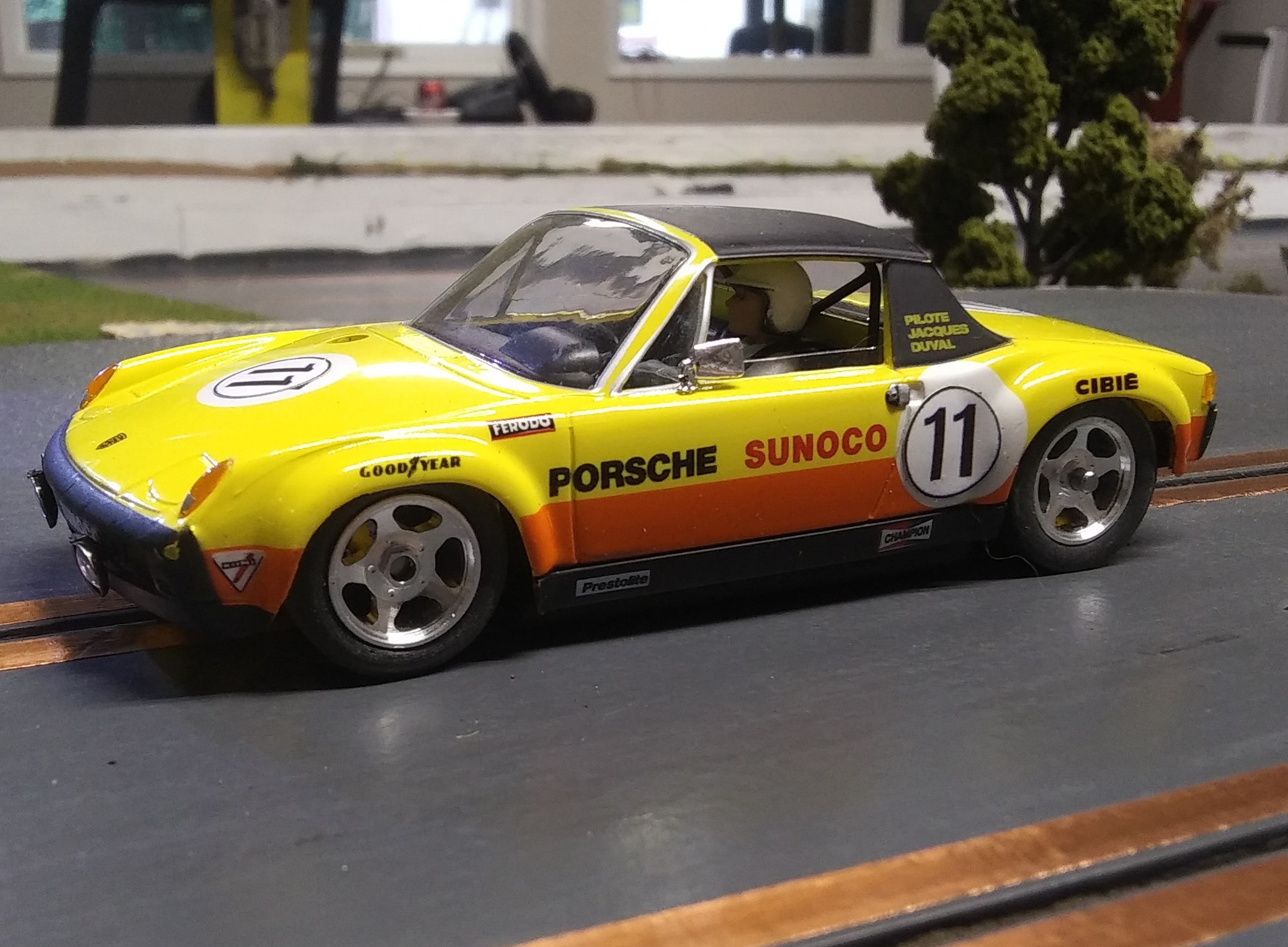

 I have one of these I built for a proxy with a 21.5K motor. I always felt that was too much motor for this small of car. When I got it back I replaced the 21.5K with an 18K H&R motor. Now the car is much more drivable and a blast to thrash around my home track.
The Chrono 914 chassis does not have any additional magnets, so no need to worry about removal. The motor provides plenty of downforce if needed as well as plenty of power. If you want to swap out the motor, the chassis will hold both a short can or long can so you can reduce or add magnetic downforce based on the motor you choose as a replacement.  Below is a tuning review on the SRC PORSCHE 914 Chrono model.
