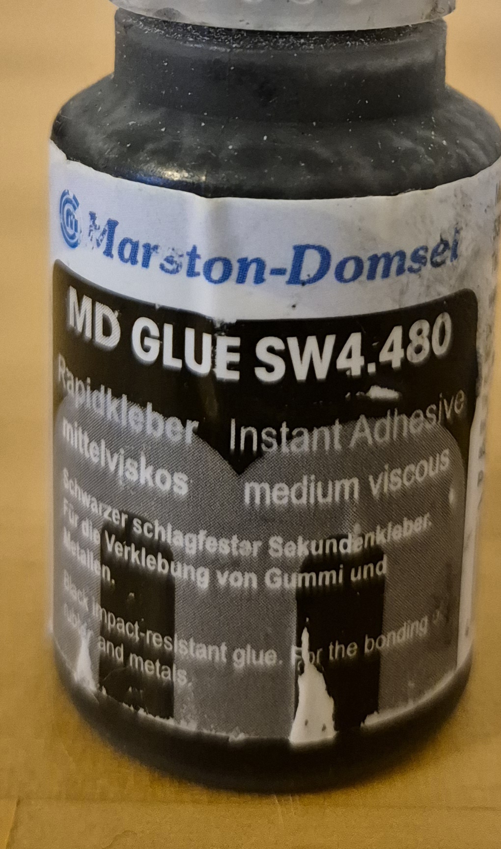

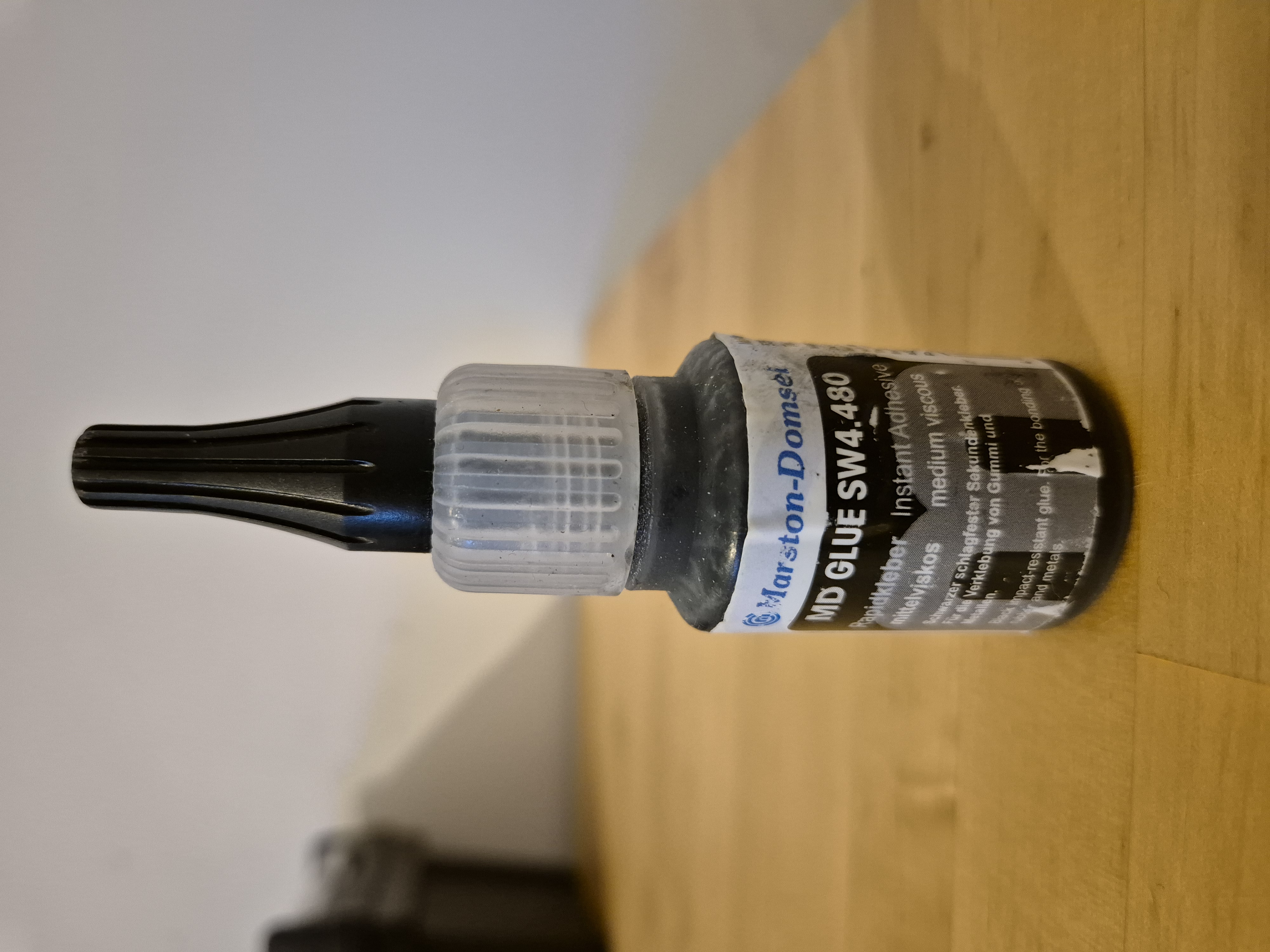

#26
    See pic,
Works well but takes a little time to cure.
Good for initial fitting.
Not so good for track side inter-heat quick fixes.
Takes longer to cure on nsr reds for some reason
Alan.
