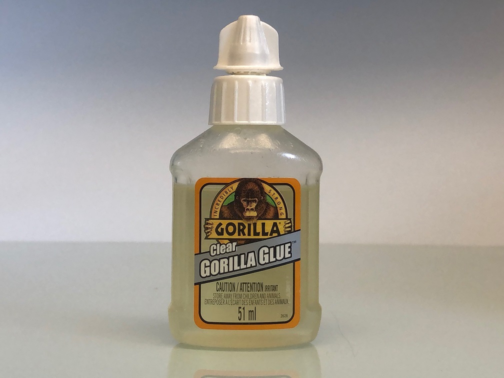

I have used clear Gorilla Glue on the recommendation of the club members before me. I've had zero failures since 2018. It works amazing. Just keep in mind it's gap filling, so less is more. Put a small drop on the end of a toothpick and swipe it on the center of the wheel. Spread it all the way around the wheel and install the tire. Squeeze the tire to push excess glue out the sides. Wipe excess glue off with a shop towel and leave it for about 3-hours. Then begin truing.

I forgot to mention that if glue does not seep out both sides of the wheel/tire. You didn't install enough, and the glue/tire will fail.
The perfect amount is when just a little seeps out both sides. If you put too much glue. There's simply more to clean up, and you waste glue. Better to err on the side of a bit too much rather than too little.

I've used gorilla glue clear before, it's not the stuff that foams like the light brown stuff...it works well but I stopped using it because I couldn't wait 24hrs before truing.

Yes, don't use the brown expanding stuff. Use the clear stuff. The instructions on the bottle say you can remove any clamps after 2-hours. Full cure in 24.
You only need to wait 2-hours if you're really in a hurry to true a set of tires. There's always other things to do on the car while the glue dries such as... have lunch, coffee, take a shower, etc.

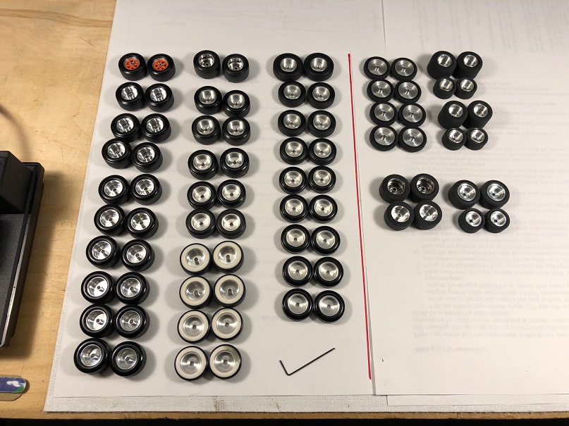

I have since got into the habit of glueing the wheels and tires as soon as I get them. I'll work on the entire build a few days later. I'll buy a dozen pairs of wheels/tires and glue them all in one sitting. Then eventually use them all up when I figure out what cars go on the workbench next. That's why I have that funny pic with all those wheels/tires.
