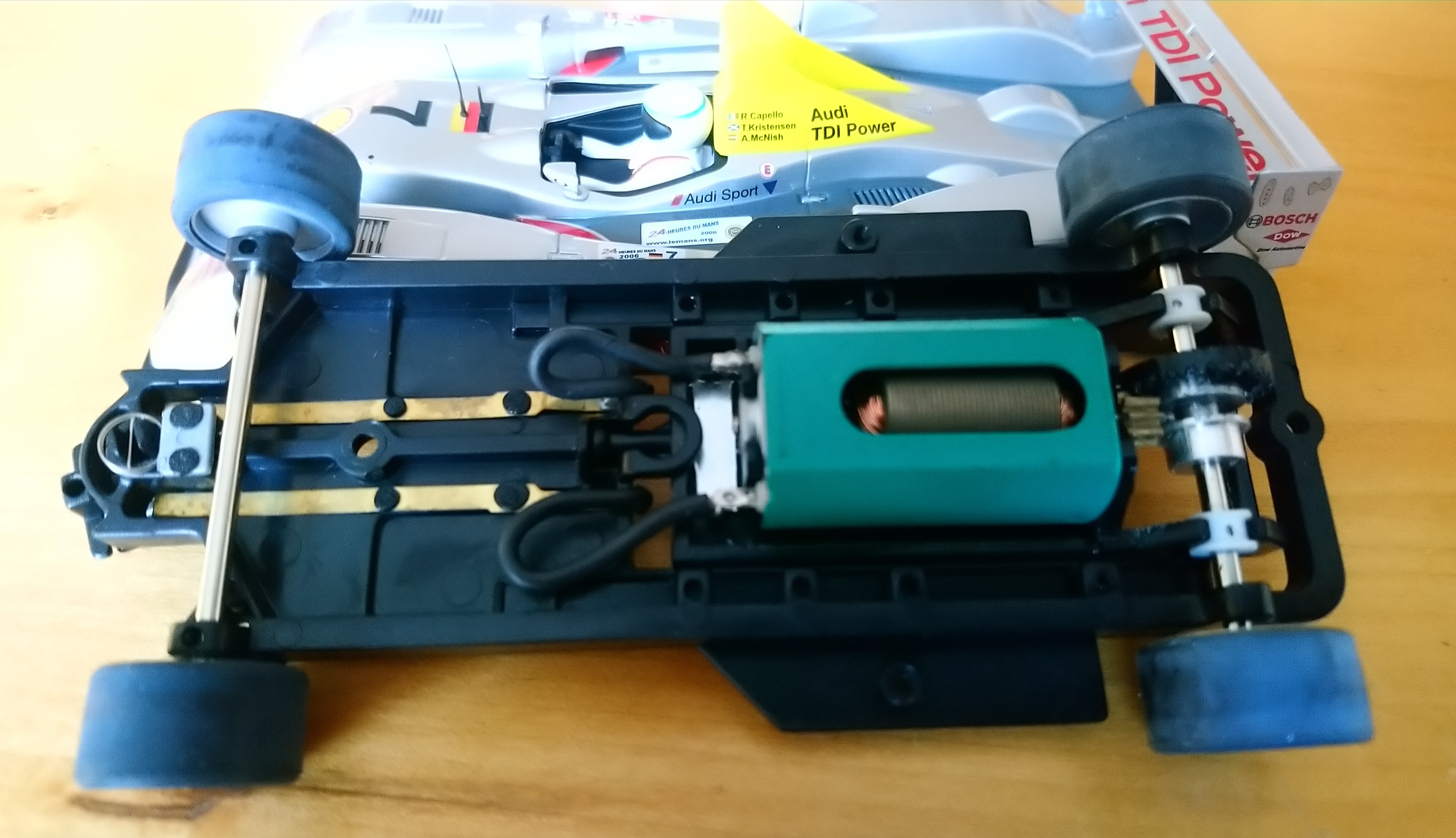

Does anyone have any experience or tips on tuning an Avant Slot LMP? Specifically, the pod rotates on a single peg at the front, and just seems to be held in place at the back by the axle running through some slots.

Interesting, mine has 2 thin pieces of metal running along the veins on the outside of the pod that then sit under the rear axle and act as leaf springs. 99% sure mine also had independent stub axles at the front. Must have been different chassis at different times.
Mine ran ok on a woodtrack for an inline, chassis very stiff, deep guide out the box (relative to nsr/slot.it, not a "wood" guide). I swapped all the mechanicals for slot it stuff (wheels weren't true, plastic bushings, gear mesh was awful etc) and it was fairly competitive. I think the chassis was also compatible with the Porsche rs Spyder and the Peugeot 908 so if you get it running well you have 3 cars in one!

I’m not massively experienced with standard Avants but from what I have experienced, the degree of freedom the peg and slots give the pod vary wildly between cars. Just a tolerance thing.
I’d suggest you want to minimise movement as much as possible because it’s no use flopping about, all that achieves is tyre rub on the body and body rub on the track.
Same goes for the body which for some reason, counter to every other car, runs better tight than loose.
They do run quite well despite the interesting design choices, providing you can minimise the extent of which the car resembles a jelly. If you have a “tight” car then you may not need to do much work, just keep an eye it doesn’t become looser over time as the first Audi R10 I purchased has done.
Ashley is quite right to say that a couple of their models share chassis. Front stubs were also fitted / provided with some cars / kits.
Hope that’s helpful.

Yes it's interesting that the pod/rear axle rocks completely independently of the chassis/front axle.
Body float is fantastic, as you say, just need to control/exploit that.
I wanted to give the existing hardware a chance rather than look out a more traditional 3DP chassis. But with plastic push on hubs all round there will be limits to what might be achievable.

Not that I gave the existing plastic hubs any chance to shine...on with some Slot.it BBSs.

All avant cars have 16.5 dia wheels if you wanted to match, although they use fairly low profile tyres so a 15 with a bigger tyre might work too.
A shame they’re so “under wheeled” but that’s they way they’re made, any bigger fouls the body and there no room to cut a larger aperture either.
