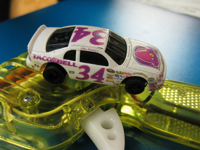

The HO series was equally friendly and helpful. I turned up to me first race at Pinewood Raceway with two cars that I enjoyed running at home. I was gently told (and brutally discovered on track) that they weren't competitive. Instead I was told what to get, the tyres to use and some simple preparation tips. It turned out I already had the cars (one had cost me £8, the other £12.50!), so spent £5 on spares in the club shop and another £20 on a Parma Eco 45 ohm controller. I did much better at the second event in Kings Lynn, qualifying in the middle of the F1 race (everyone took part in that one) and briefly led the Nascar A final. It was a different track at each event, so that was a bit of a leveler. And I could be competitive on a realistic budget.
Having the right cars gave me confidence to concentrate on my driving. Although we all blame our tools sometimes, starting out in club racing should really be all about learning to drive the track and then some race craft. As Alan said, "Diligent preparation and good driving skills ARE the main factors".
I stuck with HO and gradually developed those two cars, initially with help and encouragement from more experienced racers and then - as I gained in confidence - on my own. Podiums, race wins and championships followed. Those two cars have both remained competitive and the Nascar helped me to the WHO club championship in 2013 and 2019. I've also had a lot of fun building and developing other cars - some of them quite eccentric choices requiring a huge amount of work to get anywhere near competitive. That might suggest "don't always choose cars the front-runners are using".
