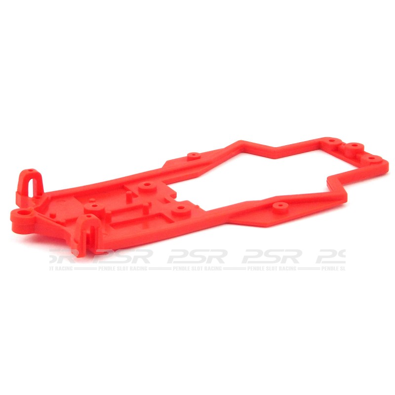

And am I correct in thinking that this Avant chassis advertised on a Lancashire shop's website takes a slot.it pod?
I ask because it is a different chassis to the one on the car but is said to be suitable for the R10.

(21st-Nov-21, 10:39 PM)BARacer Wrote: And am I correct in thinking that this Avant chassis advertised on a Lancashire shop's website takes a slot.it pod?
If memory serves correctly then no, the holes don't line up, it is for the Avant slot Aw pod (which you can't fit under the lmp cars bodies). The whole Avant slot chassis/pod selection is very confusing.
P.s the attached is just an example, I own all the pieces shown in that picture and it is absolutely not possible to use the flat 6 in AW with that pod with out cutting or jacking up the body. They seemed to have released chassis and pods with no idea how/if they can be used together.
Best bet is a 3d chassis. At SMSRC a 3d chassis, AW slot.it pod is now flavour of the month, surpassing the mosler. Even with the slot.it pod you have to jack up the rear of the body to get a full fat motor in there, a flat 6 will just fit.
