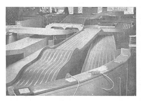

 Drop arms were essential in the early days of commercial raceways to cope with hills like this one at Wonderland in Southend-on-Sea
 The second track in the background also had a series of ramps which climbed to almost head height before dropping back down again but by about 1968 most commercial raceways had flattened out the hills so drop arms were no longer needed.
