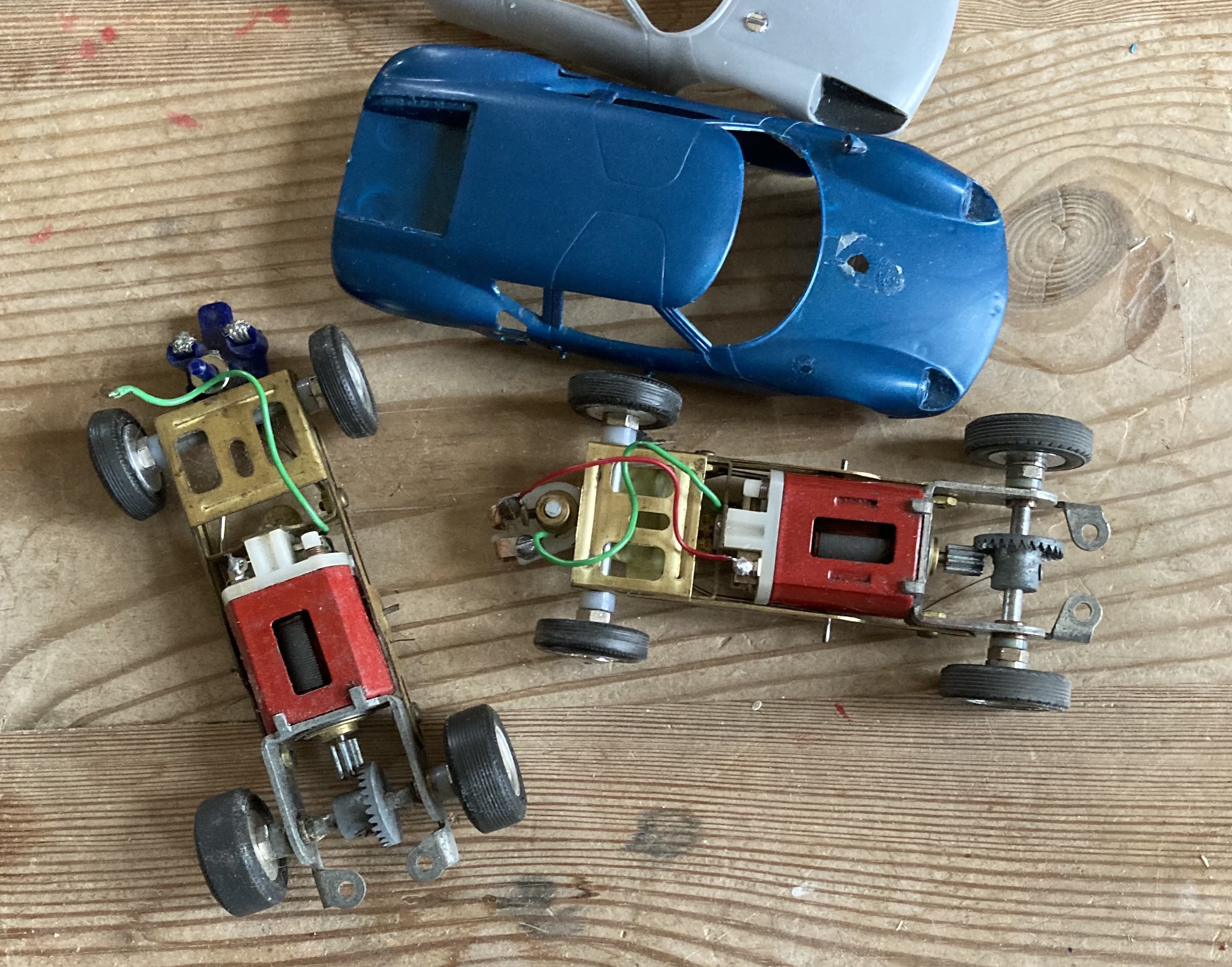

I am trying to resurrect a couple of second-generation Monogram 1/32 chassis, those with a drop arm.
[attachment=18867]
These wrecks are missing the suspension parts, I've tried to add weight to the swingarm for compensation.
Maybe I should fix the arms rigid instead?

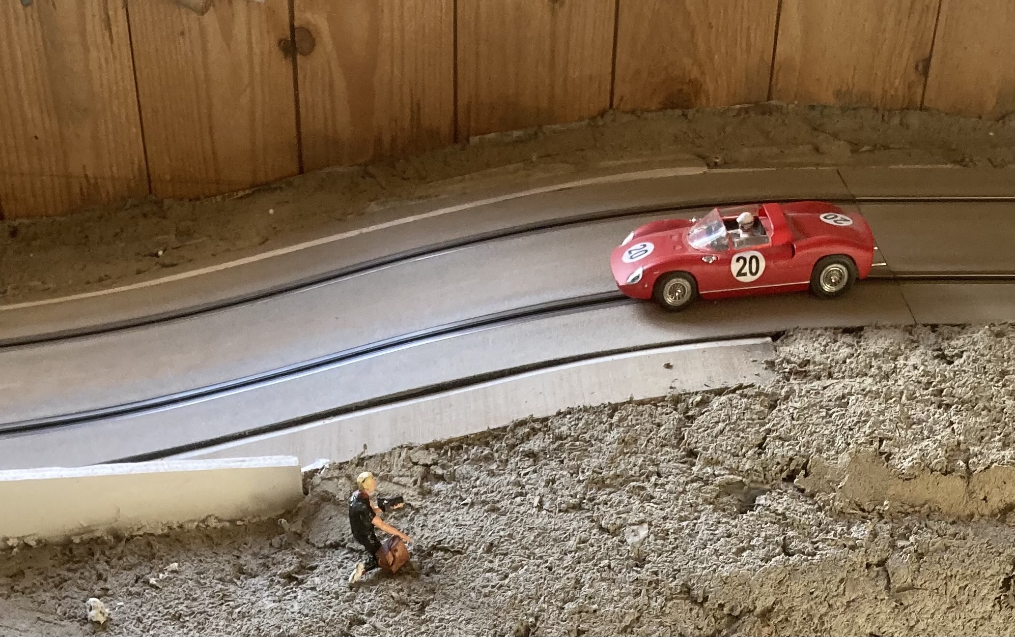

Since there is one section of my track where a drop arm possibly could be an advantage I will, just for fun and nostalgia, test both possibilities.
I am talking about this downhill bridge section where cars tend to jump.
[attachment=18888]
Btw, I am a genuine home tracker, the cars will run nowhere else.
Carver

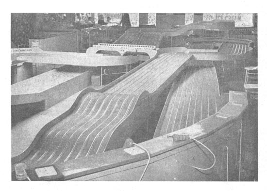

 Drop arms were essential in the early days of commercial raceways to cope with hills like this one at Wonderland in Southend-on-Sea
 [attachment=18889]
 The second track in the background also had a series of ramps which climbed to almost head height before dropping back down again but by about 1968 most commercial raceways had flattened out the hills so drop arms were no longer needed.

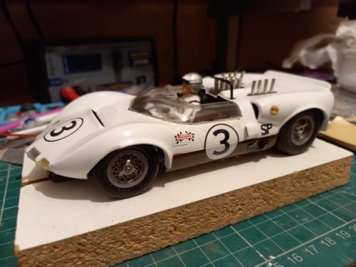

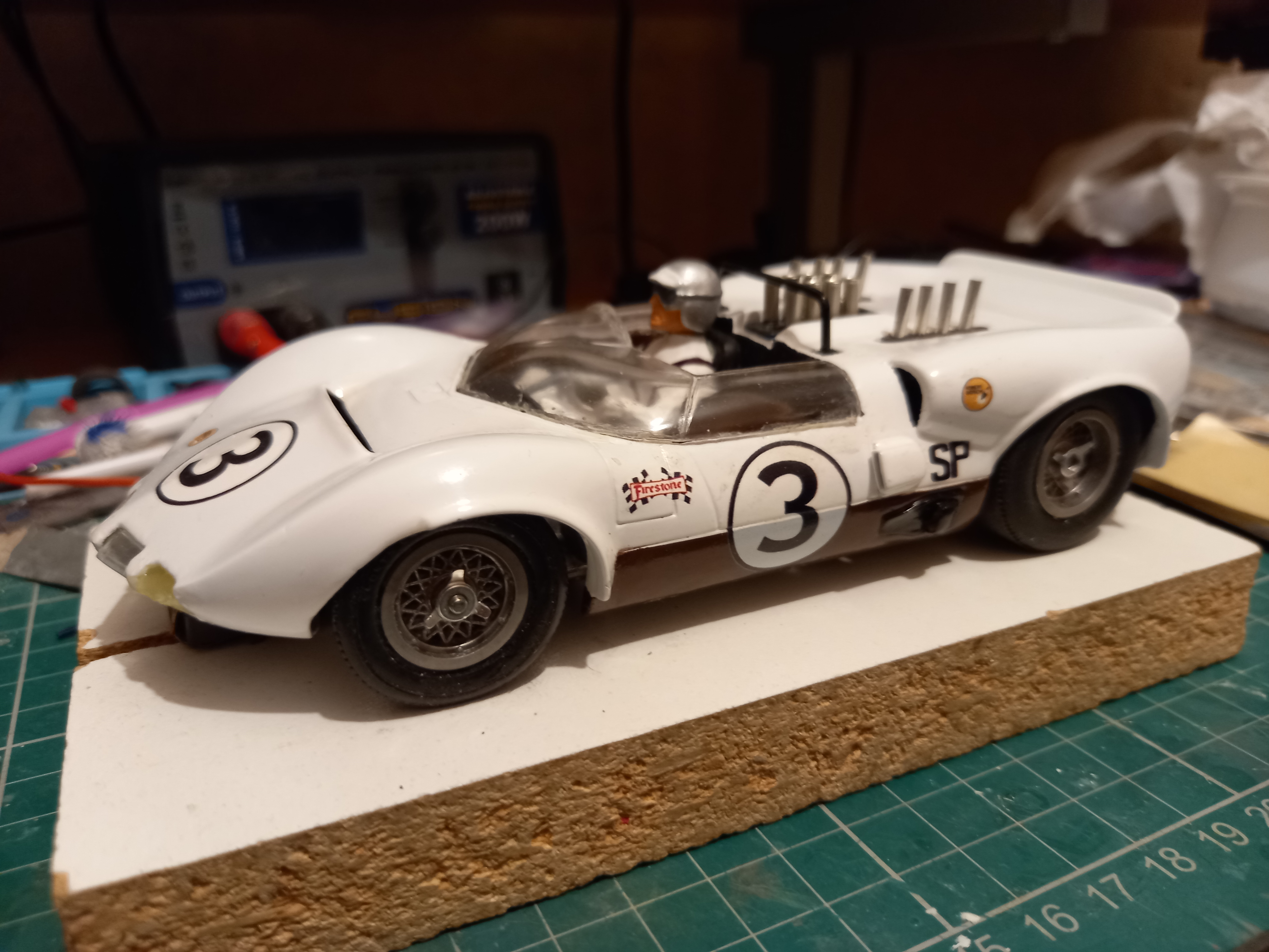

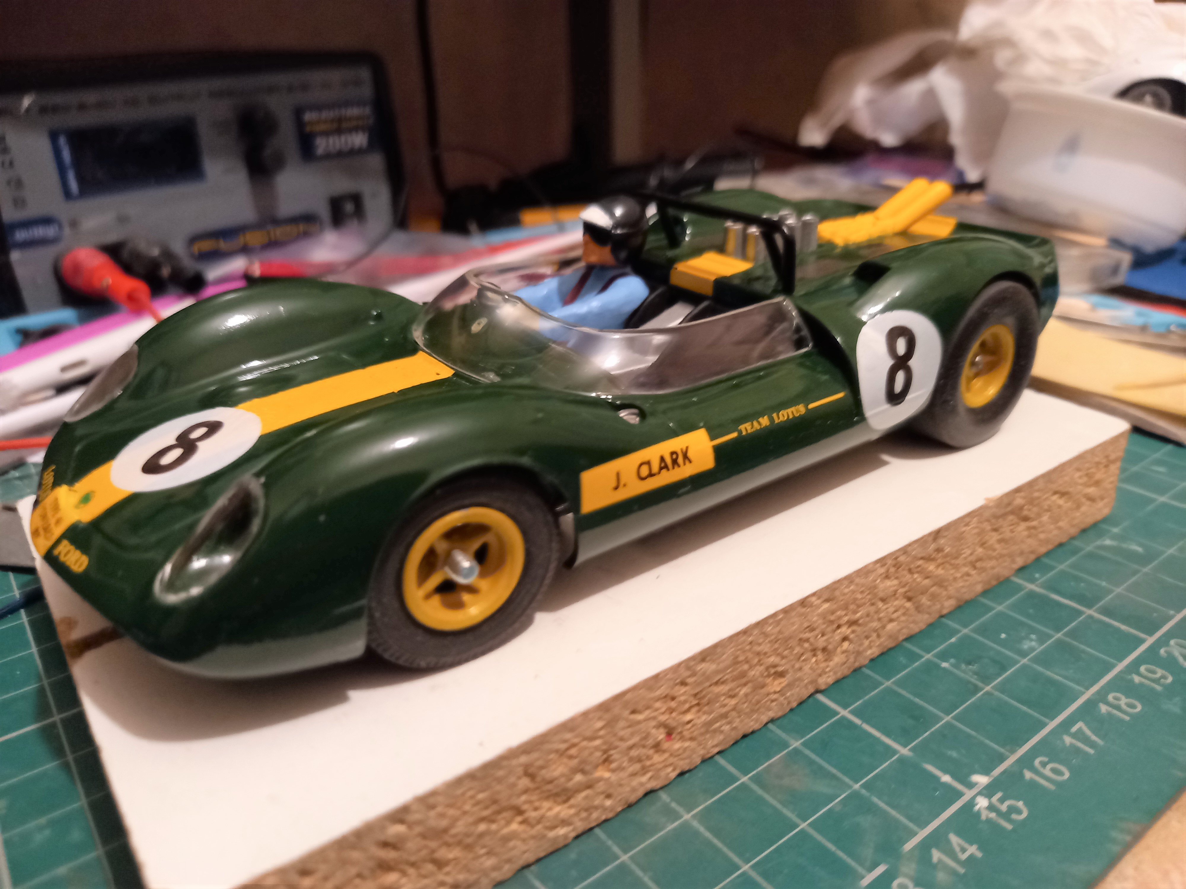

 Nothing wrong with not going for original. My 1/24 Cox Chaparral had no engine intake trumpets or exhausts so I made them from scratch along with the brake lights and my Lotus 40 was missing the roll bar so I built a replacement from brass tube and fabricated some brake lights. Both were built to be raced so non original parts which don't increase performance were acceptable under club rules although we are also allowed to lock the drop arm and fit a restrictor to stop the guide turning right round.
[attachment=18943]
[attachment=18944]
 I must admit it would have been a lot easier to buy copies of the original parts but those that were available were expensive and shipping form the USA added even more to the cost so I went with fabricated parts.
 The most difficult parts on your Lola will probably be the rear lights and the rear screen. You might find some modern resin wheel inserts that are a reasonable match if you are lucky.
 You will probably find those thin wire drop arms flex a fair bit which doesn't help the handling especially on a long fast track.

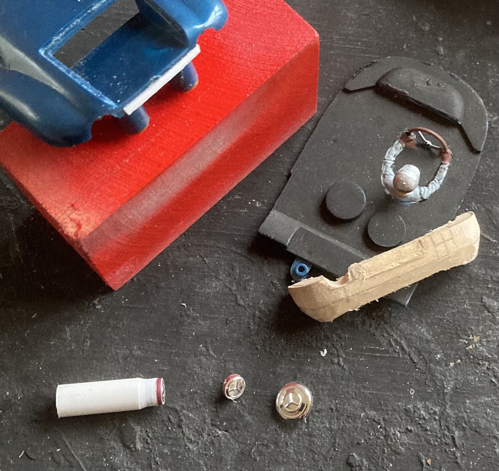

RE: Monogram chassis, advice needed - Carver - 1st-Nov-21

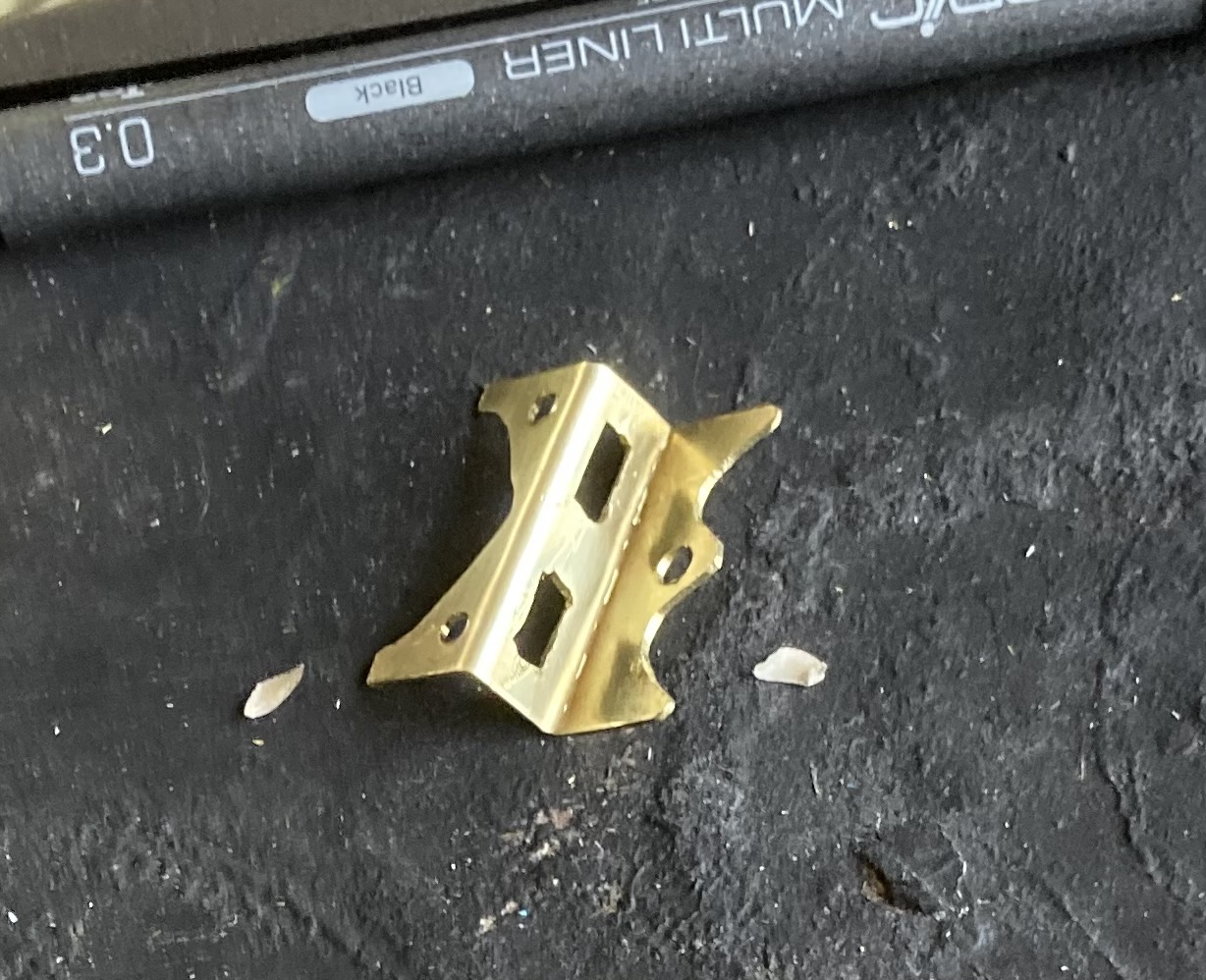

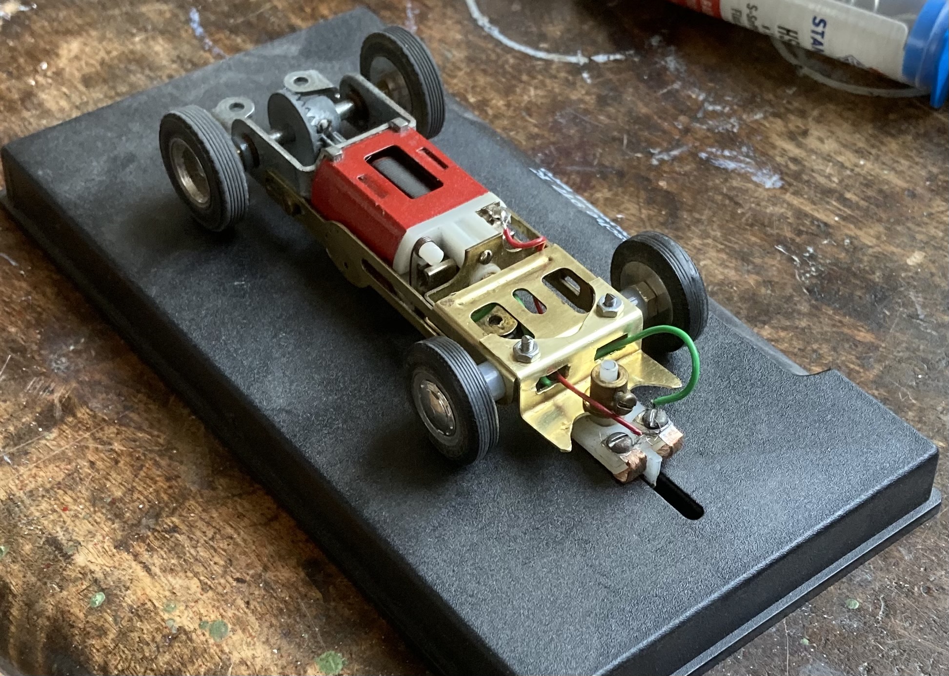

Nothing to write home about... But after some testing, I have followed your advice and abandoned the drop arms.
I ended up with a simple solution, it seems to work rather well.
[attachment=19096] [attachment=19097]

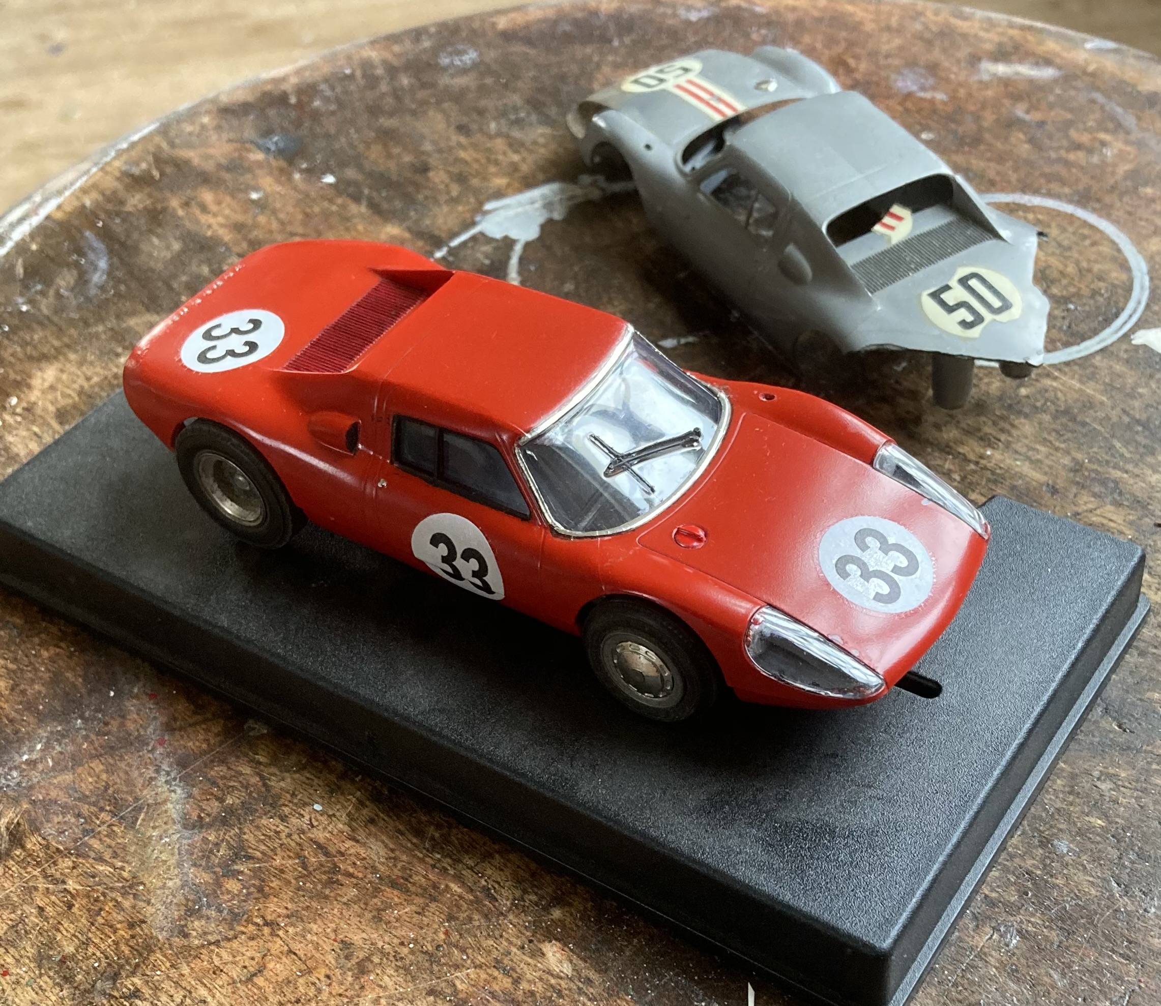

The Porsche body was definitely over the hill, I have been cheating, using a new mrrc body kit. Bigsmile
[attachment=19098] [attachment=19099]
Regarding the Lola, I was lucky to find Mercedes 1/25 hub caps in the parts box, Turned down they look much like Cortina tail-lights. Cool
