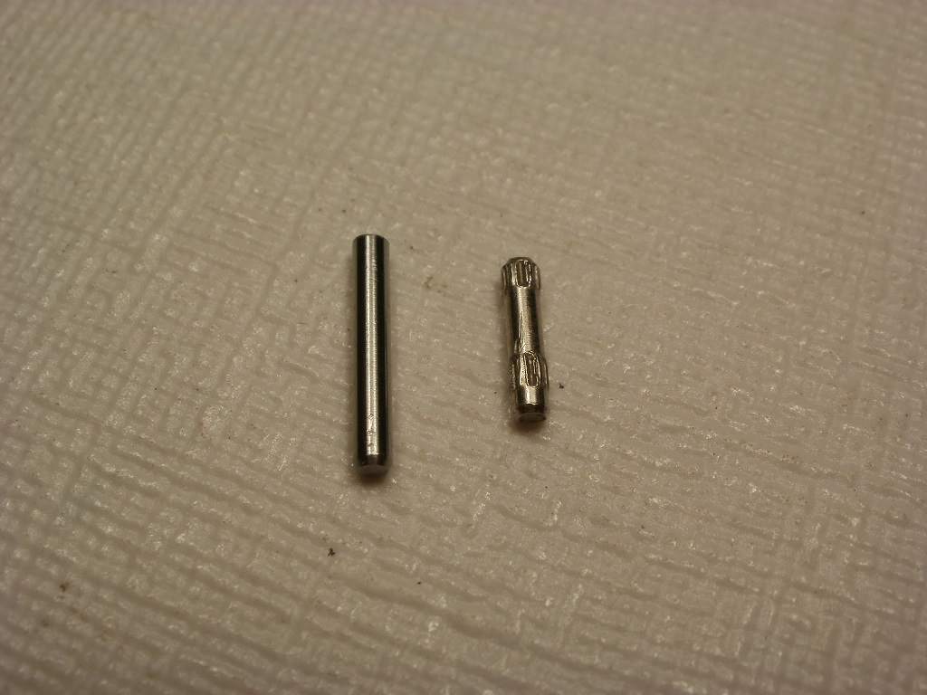

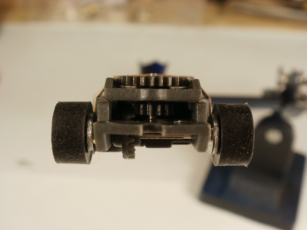

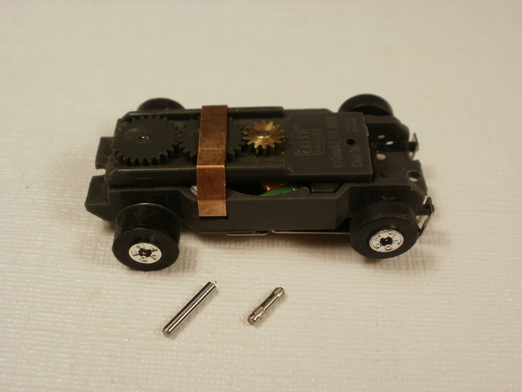

Somewhere back on page 2 of this silly thread, I discovered my worst AW T-jet car was a black Vega with a very floppy cluster shaft.
It sounded like a chainsaw as it slowly made it's way down the track. I also said the driven and pinion gears flopped around like a dead fish.
I recently took the car apart. The cluster shaft measured 0.058", and the knurl was poorly made. The shaft was also scratched from the factory. I had a cut-off from an axle that measured 0.0615" diameter. I just needed to trim the length.
It was actually too tight in the chassis at first. I had to face an axle to a razor edge. Then inserted it several times into the cluster shaft holes until it shaved enough material to spin freely. Then re-assembled the chassis with the new home made cluster shaft.
Wow! What a difference this made! The car runs smooth and silent down the track now. It went from the noisiest to one of the quietest chassis I have with this one small change. You can see that the gears sit closer together. A lot of the backlash is gone. The car picked up speed. This was well worth NOT throwing the axle cut-off in the garbage.  Thumbup

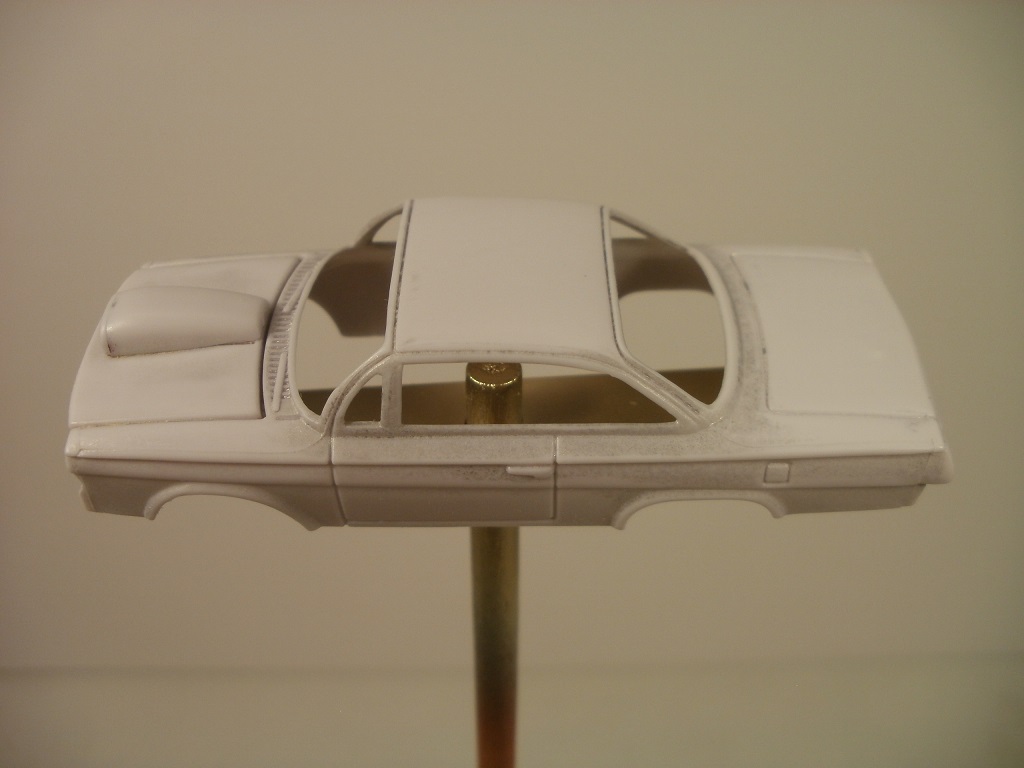

The Vega is almost ready for paint. It went back in the paint stripper for one more night to get all the small spots.

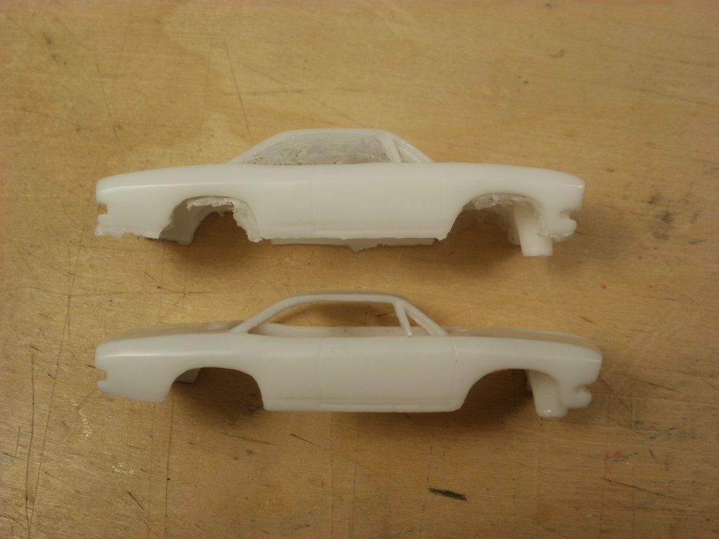

I took the time to remove the flash from a 1966 Corvair. Cool looking little car.
Before and after.

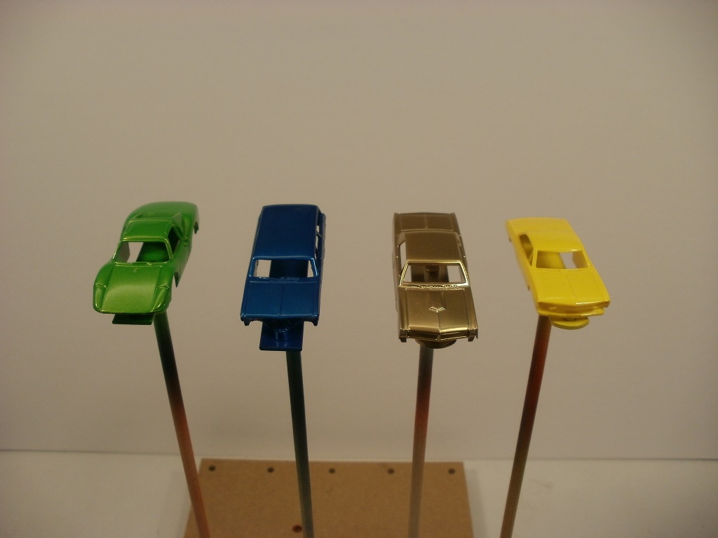

One AW Vega, and two MEV Originals drying.
Vega body was dry enough to set on the bench. Porsche 904 and 65 GTO drying between the MEV bodies.

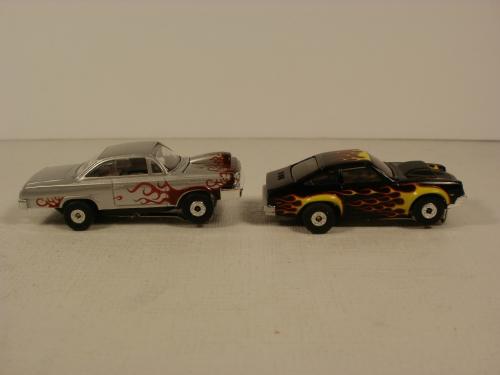

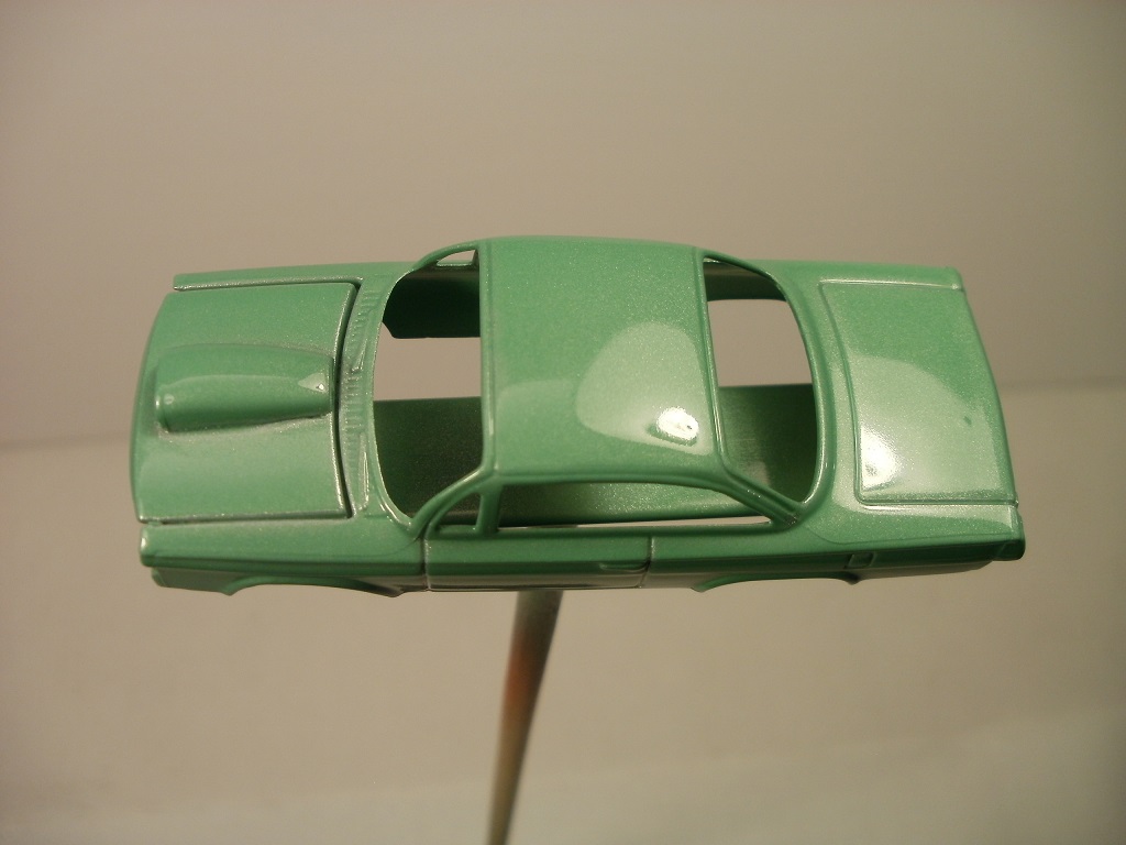

I decided to take my least favorite car and improve it's rank. I really dislike silver on a car. The poorly designed flames don't help.
Tamiya metallic pearl green looks much better on this old car to me. "Sea-foam green".   Sun

Good work there Ken. If all were sprayed with a Tamiya cans, I need to learn your technique! I use Tamiya cans too, but
always seem to end up with a thicker layer of paint. What is the approximate distance between can and target? Thanks for any info. Iain
#97
Hi Iain,
Thank you very kindly. I am happy to help any way I can.
I hold the pre-heated can 6 to 7-inches away. But also move the spray can across the body much faster to avoid runs.
There are a few short-cuts that help the body lines to come through. One is avoid primer unless it's a resin body. 3-tack coats, and one wet coat does the trick.
I hope this helps?

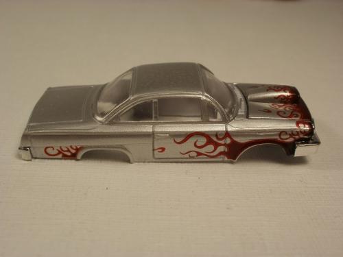

Here's the 62 Chevy with clear coat.
