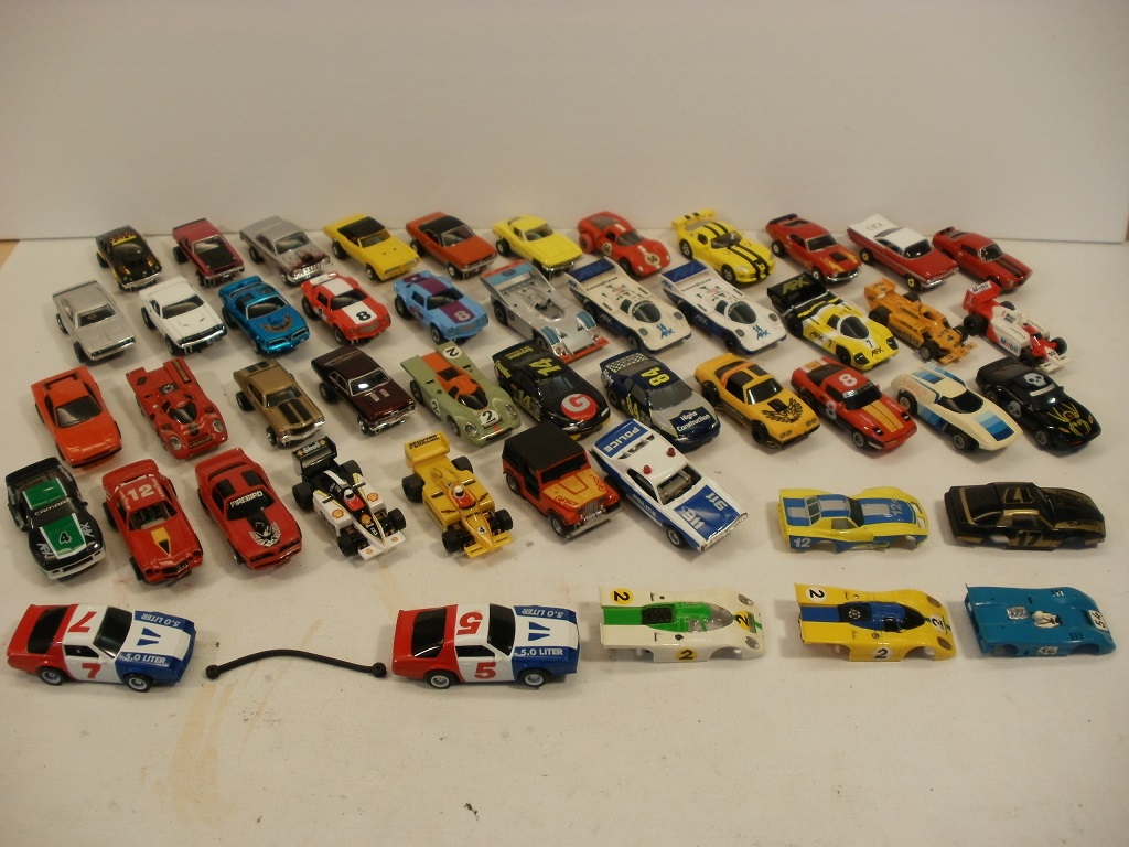

I am noticing a buzz of HO around me, but never got a foot in the door. I traded a huge collection of old Strombecker parts for a used and abused HO car collection several years ago. I've added many new cars to the collection over time. But it never got off the ground. I have a track and tried all the cars. The thing that bugs me most is the tire vibrations on some of the cars.
I see the drag race proxies going on. But have no clue what's what. I'm going to require a small (or large) education first.

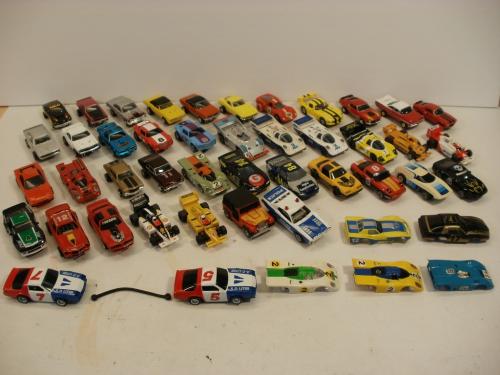

The cars.

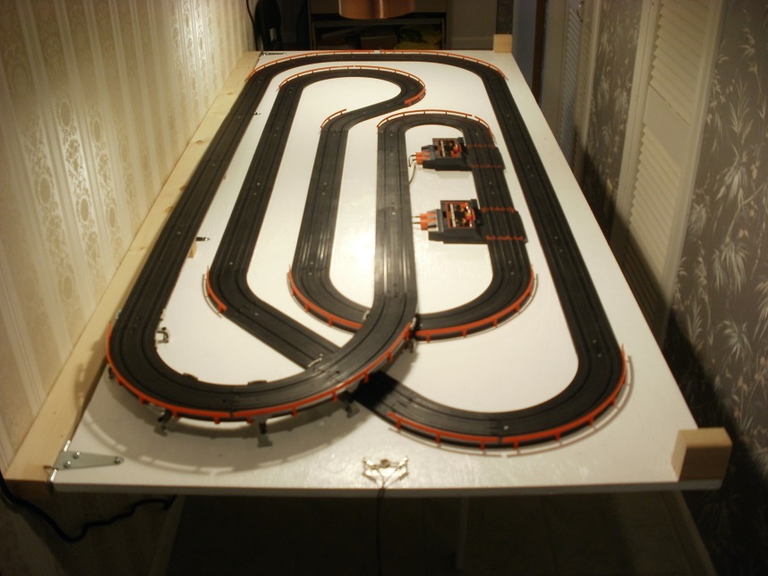

The track.

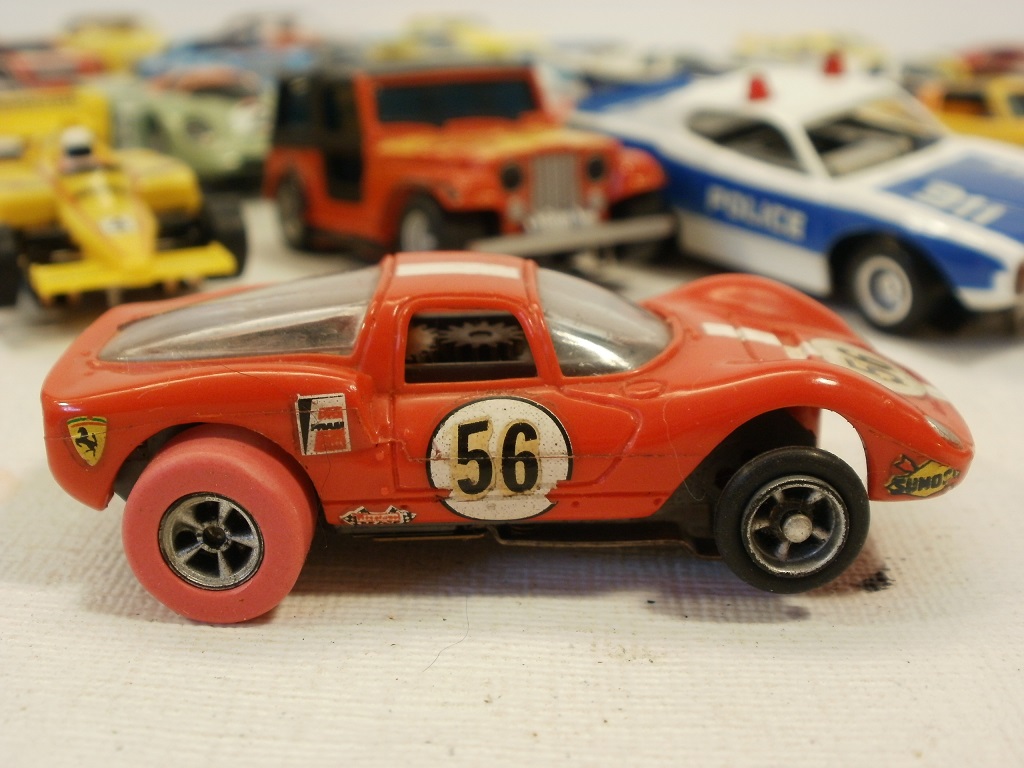

Out of all the cars. The red Ferrari Dino doesn't run. (back row)  Tappingfoot
Thank you very kindly for any help you can provide to this HO newbie.

Oh - and that red Dino's nice but the tyres look huge. Are they jammed against the wheel arches or the chassis?

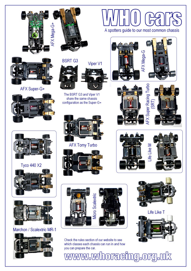

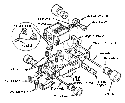

Most of the modern in-line cars are probably on this sheet I put together for WHO Racing...

Andy. Nice chart! Thank you!  Thumbup
Nothing rubs on the tires that I can see. I can't wait to install black tires for some reason. After it runs of course.

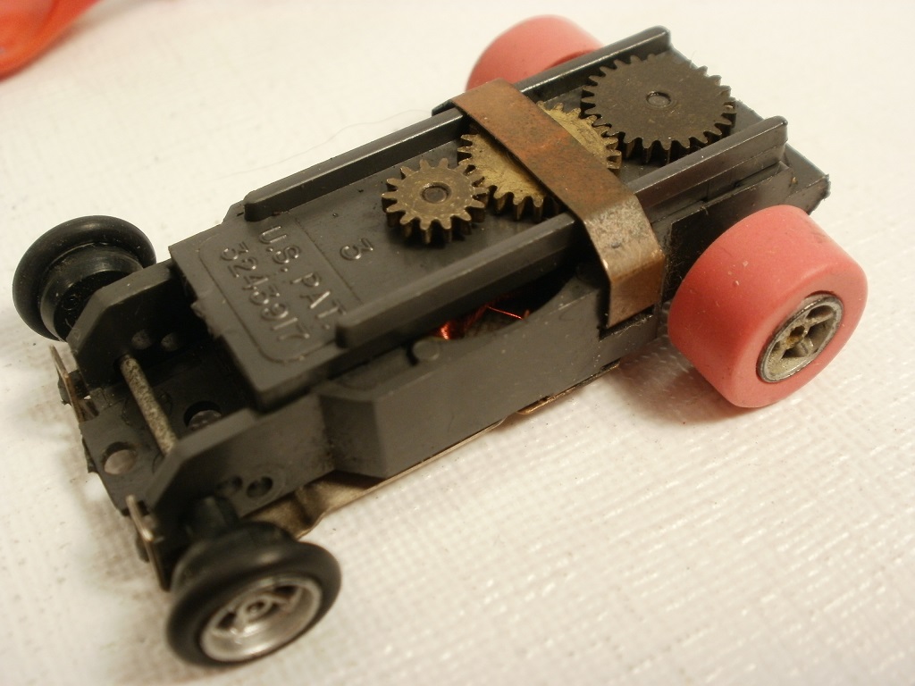

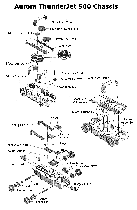

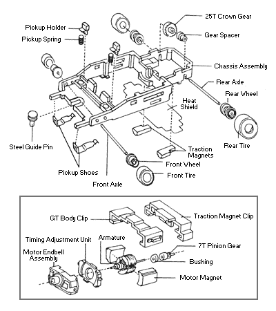

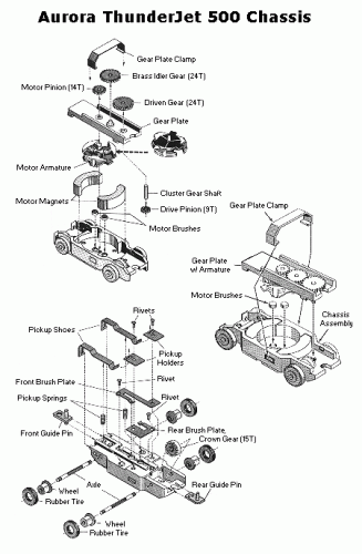

I assumed that was a T-Jet (the Dino is a great Aurora T-Jet body), but those are AFX wheels... The 50-year-old pancake cars do seize up, so a strip-down, clean, lube and re-build is most likely required. This is what you are contending with in a pancake car...
A strange armature orientation and lots of gears! The little motor brushes can be cleaned by rubbing on a piece of paper to remove carbon and dirt. The commutator plates on the underside of the armature can be cleaned up with a pencil eraser (on very fine sandpaper if really dirty and pitted).
These are two more modern inline cars (the Tomy Turbo and Super-G+) for comparison...

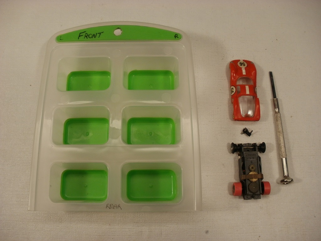

Small tools and working in a tray (to catch the tiny pieces) is recommended - as is good eye wear and a bright light.
Andy. Thanks a million!  Sun
Those are cool diagrams. My kind of info.  Thumbup

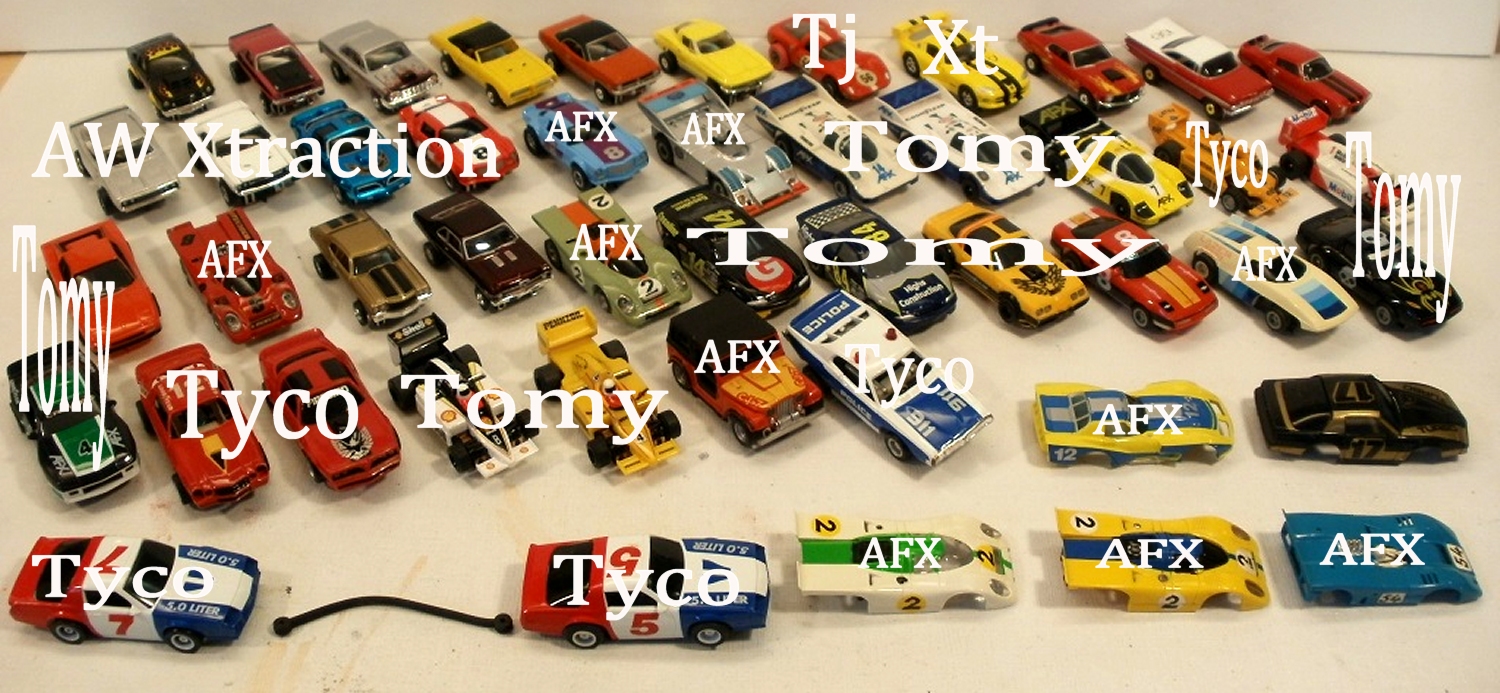

I've tried to identify the cars from the photo for you. The unmarked cars are Autoworld Thunderjets - Aurora TJet chassis clones with TJet like bodies.
Hope you can see this OK. Click on the pic' to enlarge it.
Tj is a Tjet and Xt is another AW Xtraction.
Oops - missed one. Black and gold #17 is also Tyco (bottom right)
Thank you very kindly TD.
You are spot on as you already know. I could have flipped them over for the photo. But that might have robbed you of some fun.  Sun

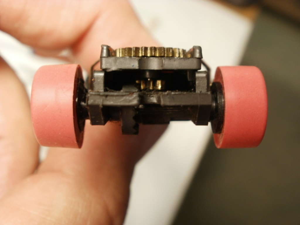

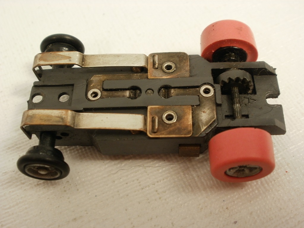

Here's a few pics of the Ferrari chassis. It tries to run when I put power to the brushes. But the armature is rubbing on something. You can actually hear it when you turn the axle and it starts to slowly rotate one or two turns on it's own.
The tear-down tray is ready. Nothing gets lost. Everything stays organized until re-assembly. An ice-cube tray from the dollar store cut it in half.
Could be the carbon motor brushes have popped out, flipped entirely or have turned on their sides. They're devilish things to keep in the right place during re-assembly.
I might be mistaken but it looks as if one or two of your AW Thunderjets on the back row of the photo to the left hand side just have rolling chassis underneath them - no innards. If so you should be able to swap the front and rear axles from those into your Ferrari chassis to return it to a more stock appearance.
