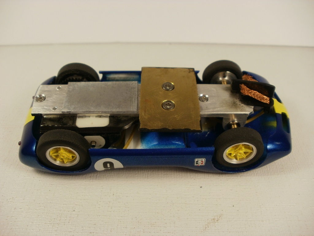

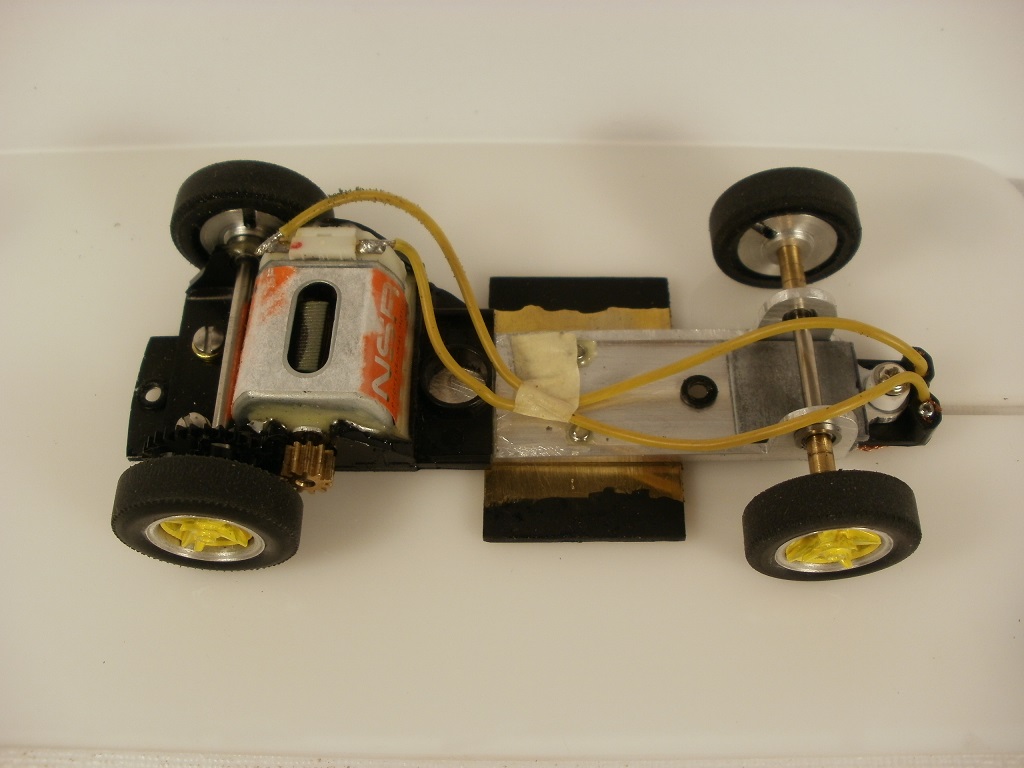

Here's a quick reminder of what went wrong on the first Lotus. A big hole was cut into the interior to try and install an inline S-can motor. I had to switch to a slim-line motor to save that car as an inline drive.
The first step to making the correction was to install an NSR side-winder pod. There's a little more room in the engine bay. It was a bit more challenging than making an inline. But well worth the extra effort in the end.

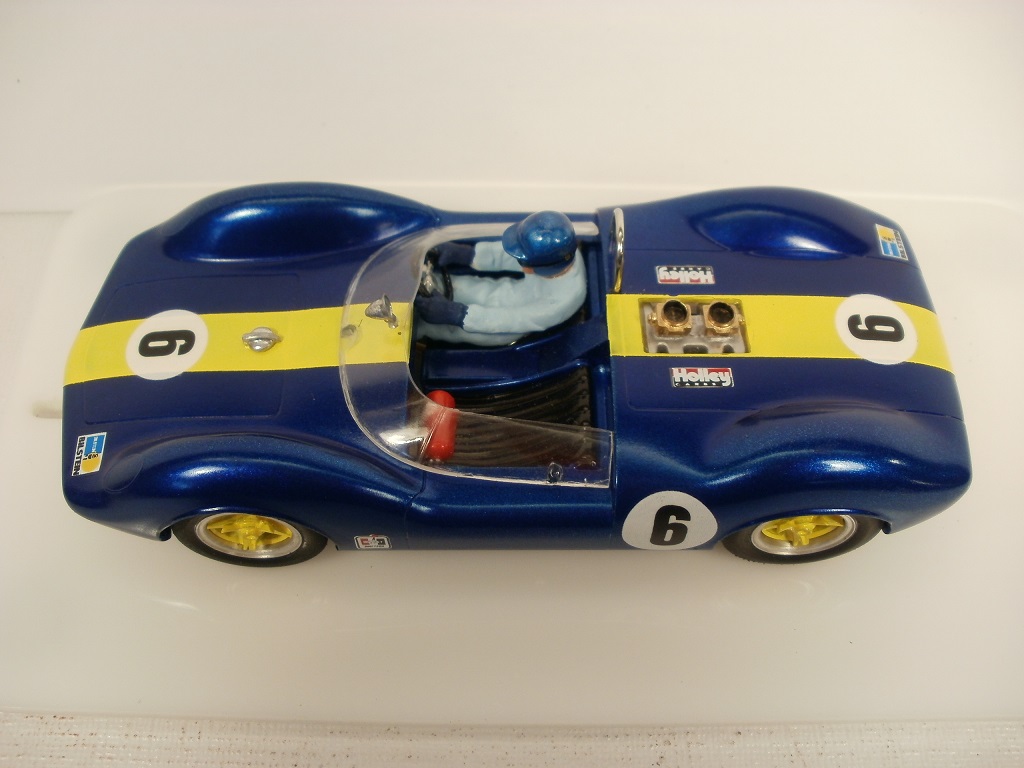

This time the car has a full interior including a fire extinguisher, and a full driver right down to his shoes. It came with a tonneau cover for the passenger side. It was thankfully not needed for this build.

NICE  Thumbup
...but which engine layout drives better?
I love puttering with gears
Very smart. They look good together.
TD, Jeremy, and Jason. I humbly thank you all for your comments.
Jeremy. It's not really a fair question since the SW is a 20k NSR Shark vs a 14k slow slim-line, inline. The SW is a lot faster in the straights. The inline corners just a tad better with a lower CG. However, the blue Lotus easily beats the green one in a race by sheer acceleration.

Ken: Thats quite a pair to draw to. Superlatives fail me. Stance, finish, personality, they both really tic all the boxes. Equally as fun is the tell, of how you wind your way to stunning cars.
