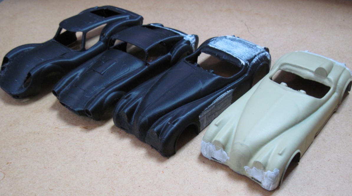

Round up of latest shells I have been working on to add to my compulsive collection of 50-60s front engine sports cars.

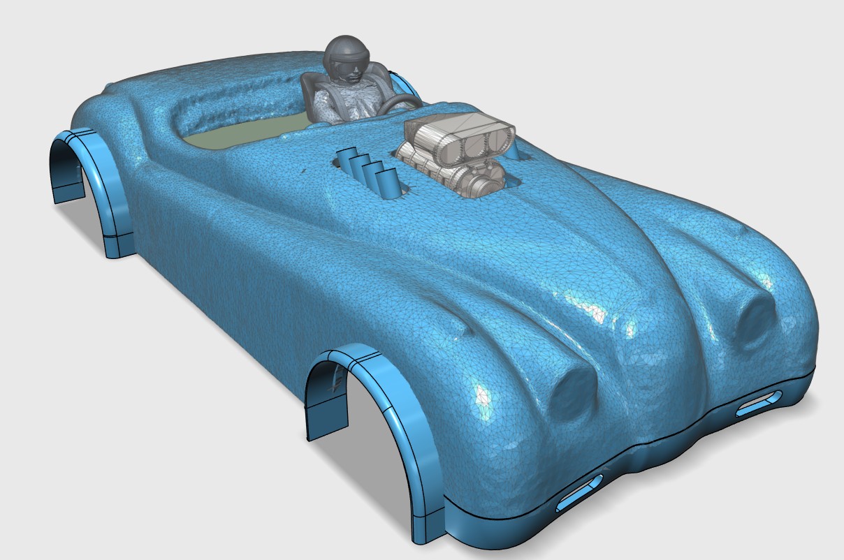

Left to right Lister Costin, AC427 hard top, XK120 UK R/H drive and L/H drive XK120 based on a state side racer from the 1960s that has twin side pipe exhausts and a rear fin (see link below).
https://www.classic.com/veh/1951-jaguar-...6-4Zbyrq4/
The XKs are from 3dp scans then corrected/modified/added to in CAD as required, the 427 is from a download with a CAD generated hard top added. The Costin started off as a scan of a Lister open top and then modified in CAD on the arches, bonnet and then a roof added. It won’t please the purists but it gives a flavour of the car, good enough for club racing.
Shells FDM printed vertically at 0.1mm layers with the JAMG HE PLA + filament, shown with the supports removed rears glued on, and sanding, filling, priming underway.
