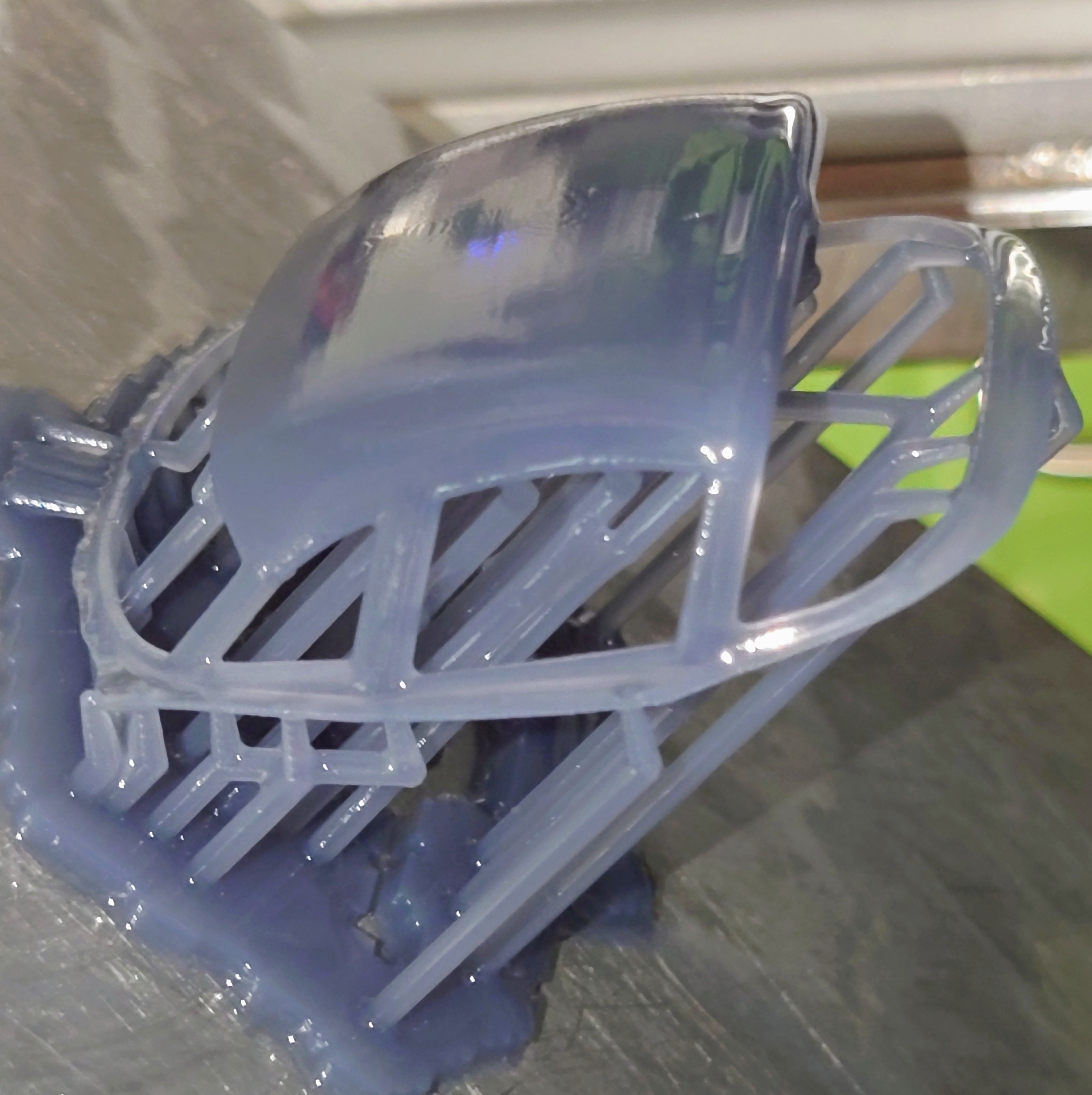

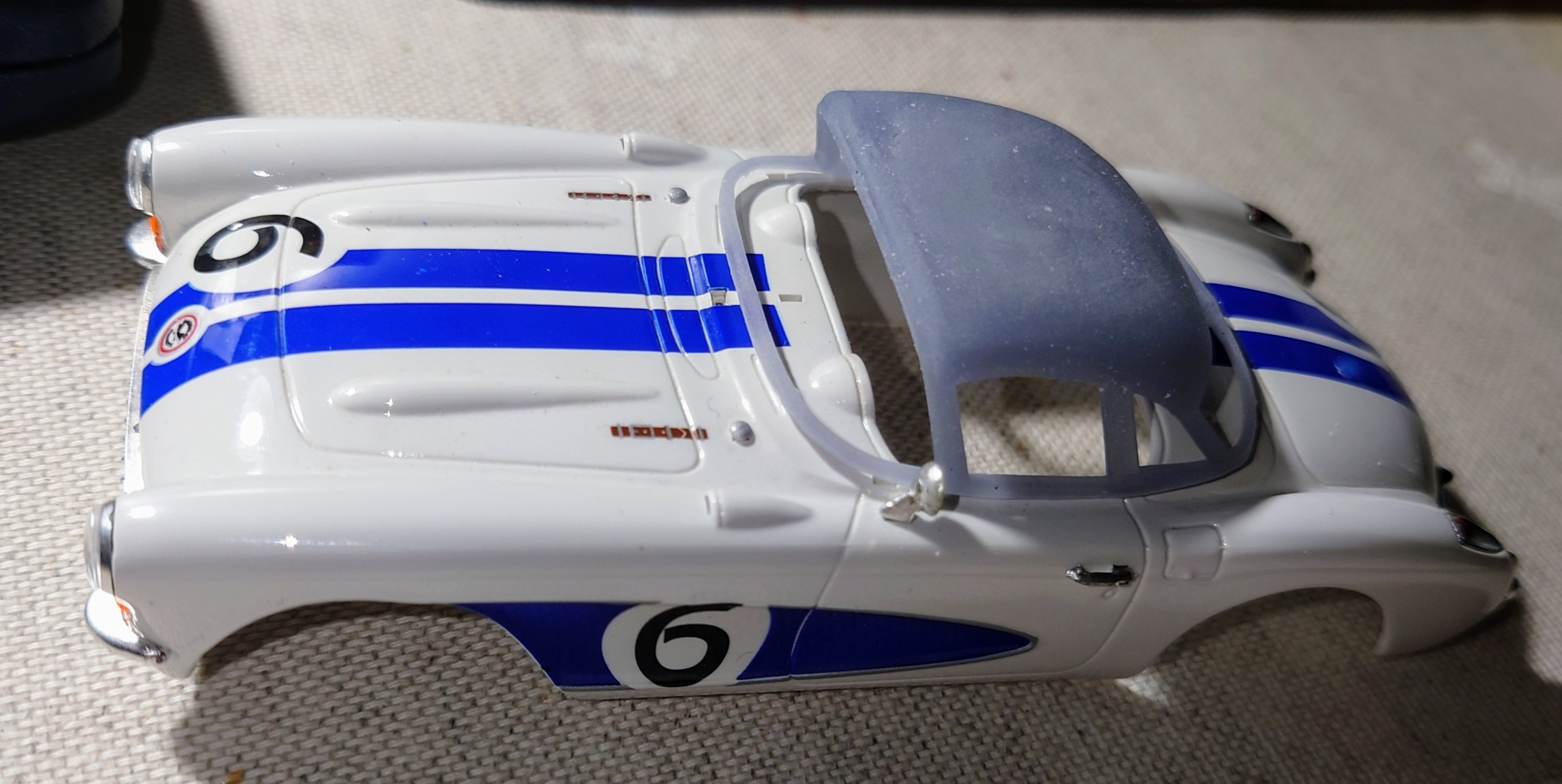

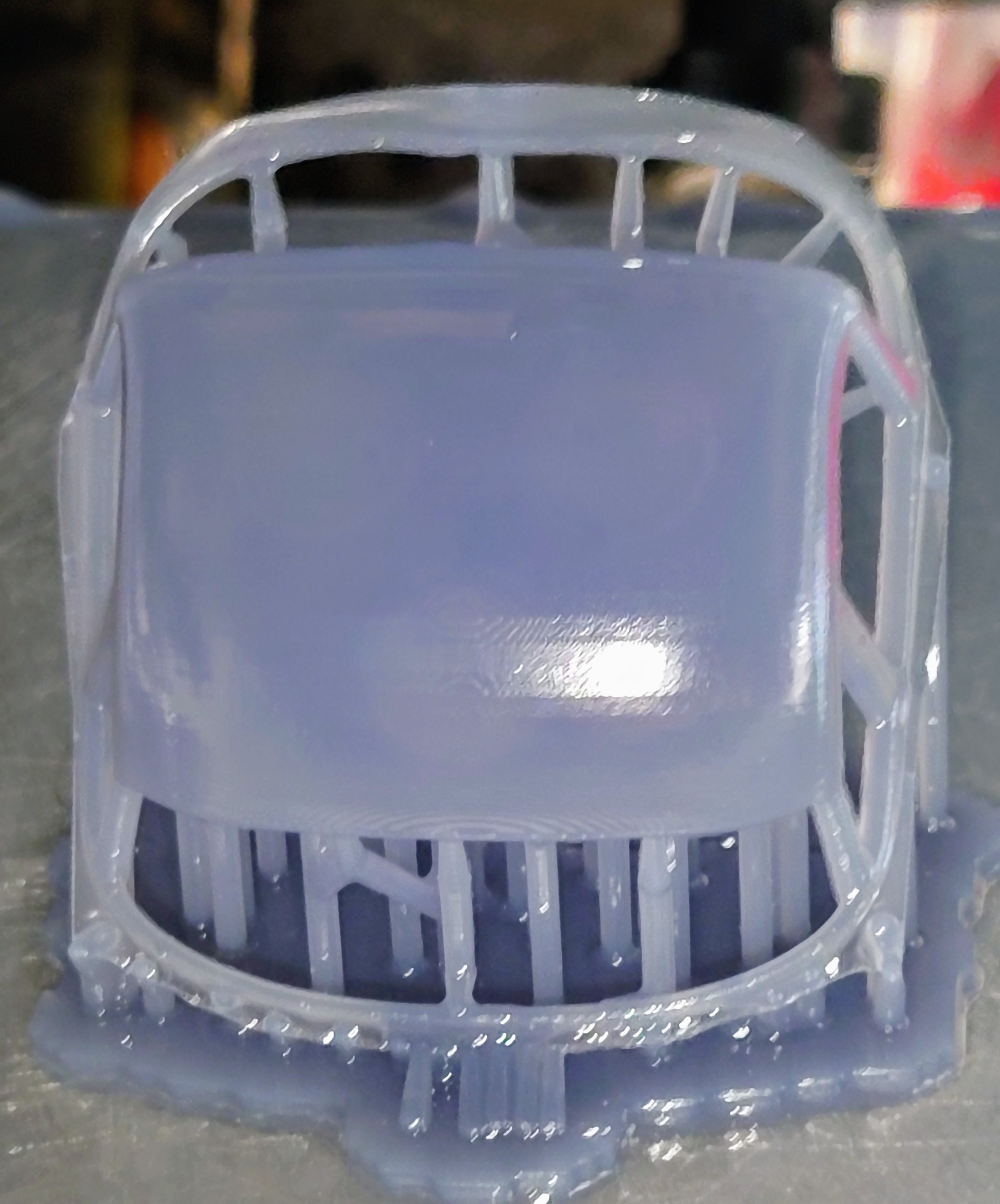

Sometimes a part of a 3D body file is useful for a normal plastic bodyshell.
I have a Ninco Corvette C1 open top but need a roof for the next proxy I'd like this car to enter.
I deleted everything apart from the roof and hopefully it'll fit... it's currently draining on the printer.
It's the first thing I've resin printed for months...I don't miss the smell!!!

Stage 2:
- Remove from printer
- Clean in bio ethanol in a ultrasonic bath
- Remove supports
- Cure resin in UV box for 3 or 4 minutes
- Grind off excess and clean-up

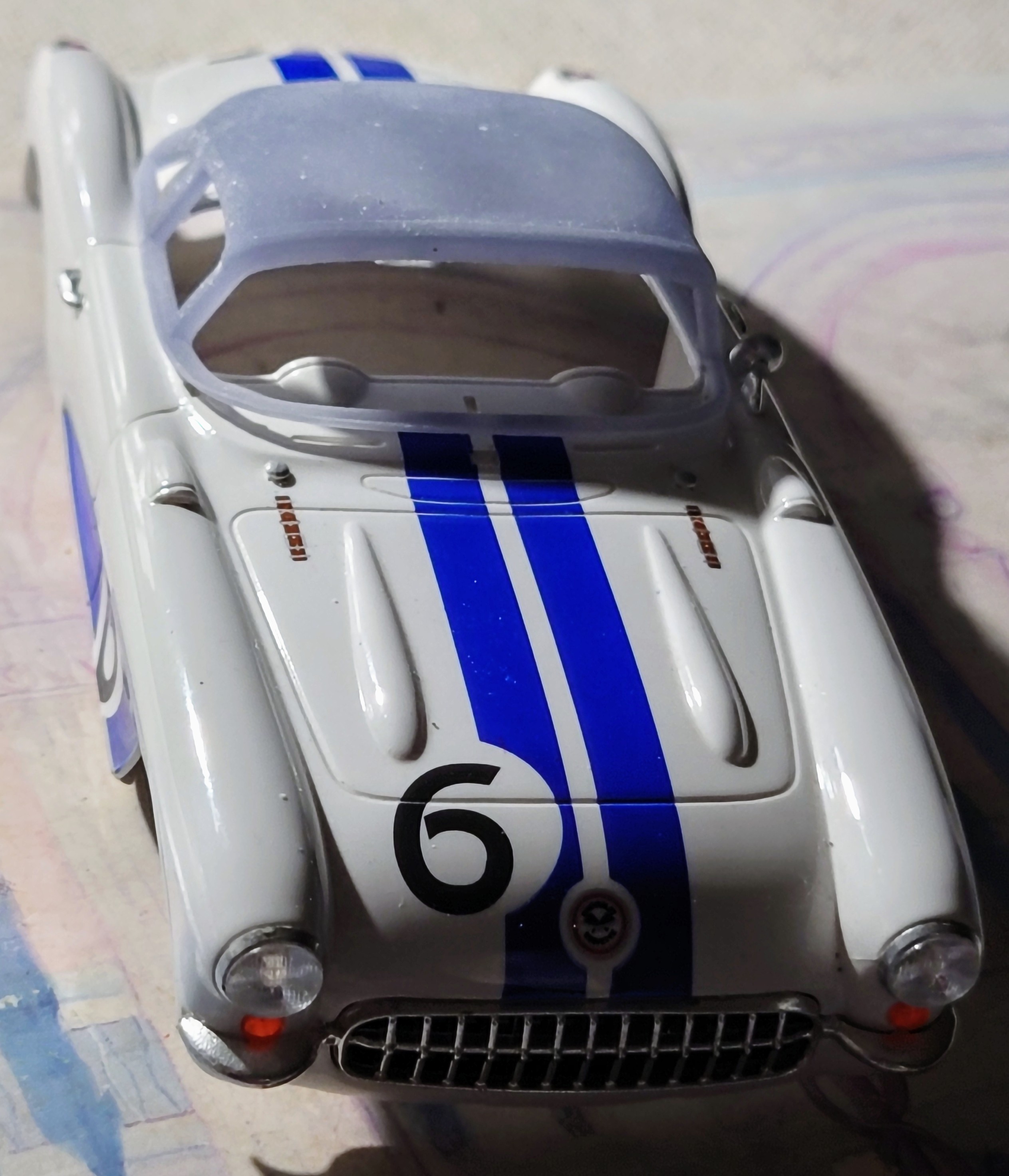

Stage 3 will be trimming the unwanted bits, make the glass and blend it into the contours of the Ninco body but it's looking more like it already.

Main reason
- much better quality finish
Secondary less important reason
- much less likely to break in a crash compared to the front or rear of the bodyshell
I haven't fitted this yet because I'm now thinking it would be a shame to modify such a nice original car.
