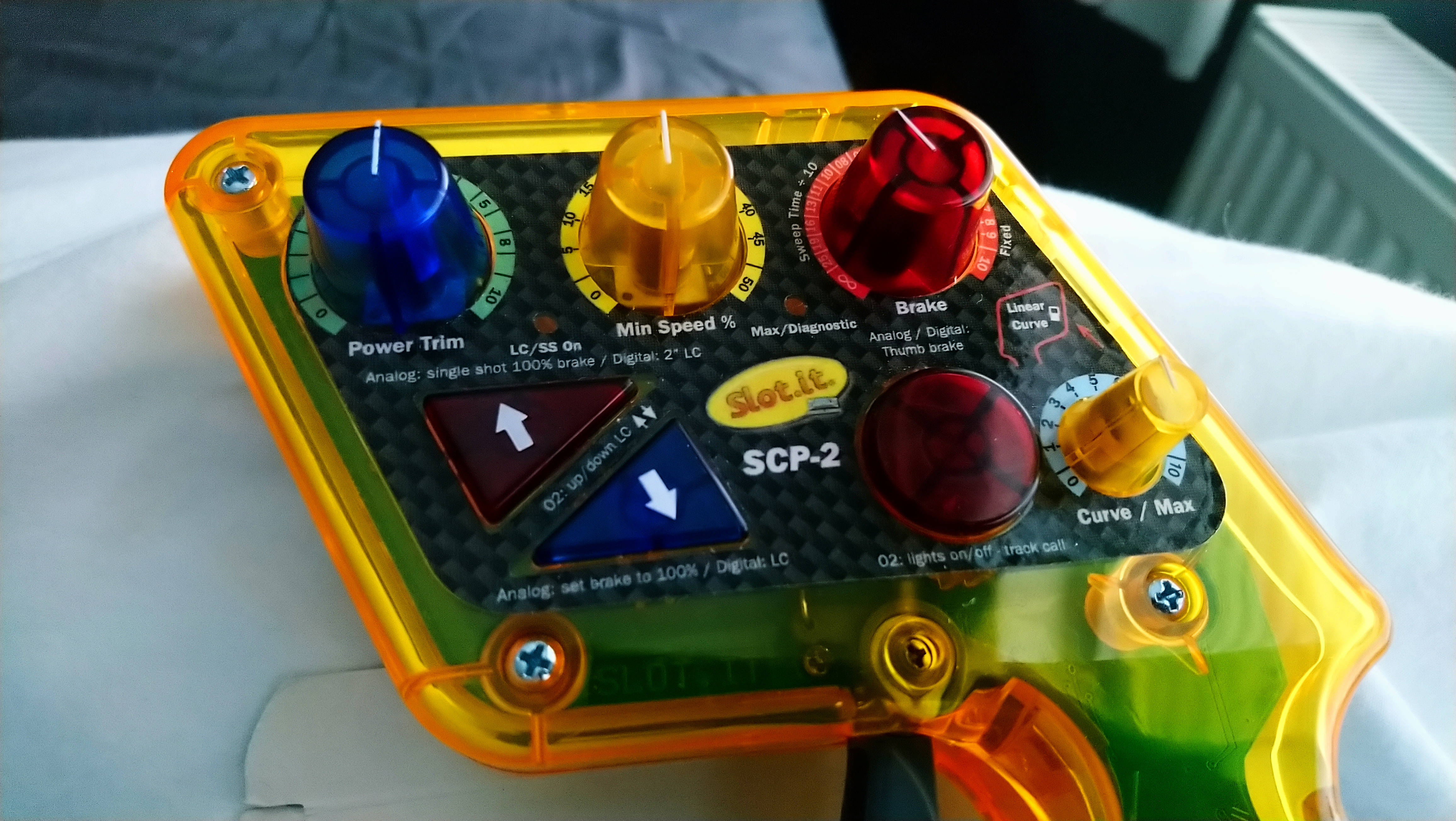

May I introduce you to the Slot.it SCP2 BARacer Special Edition...
Maurizio
a. Happy to license this for 1euro per handset.
b. Do you run a buyback scheme for spare unused  knobs?
I love puttering with gears
