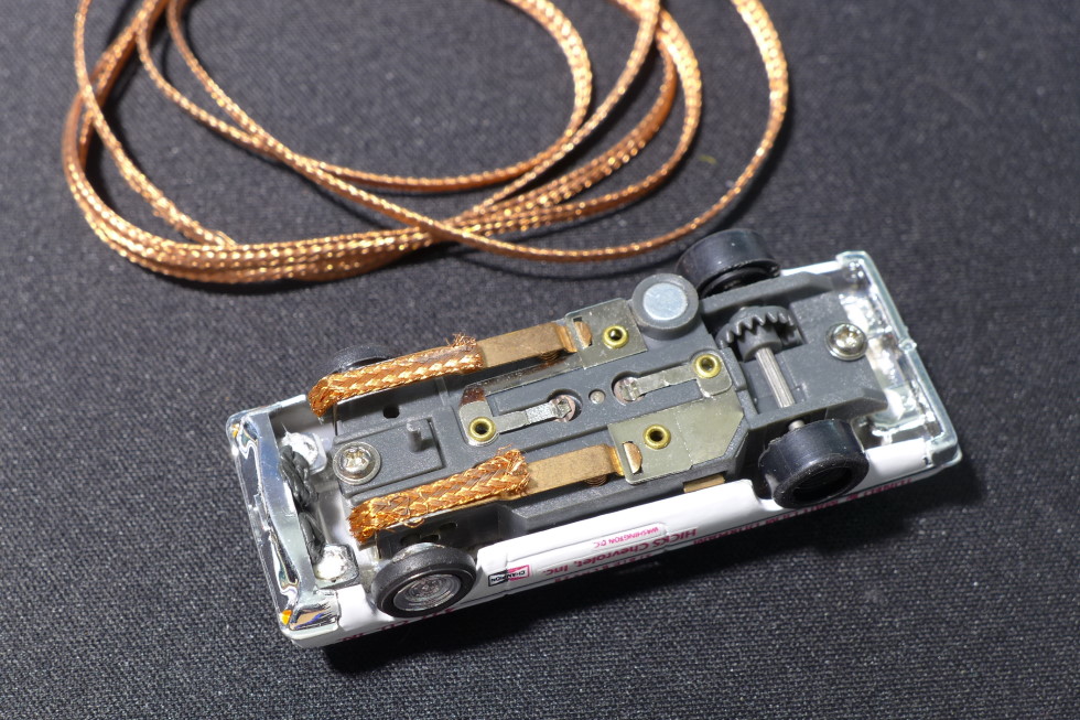

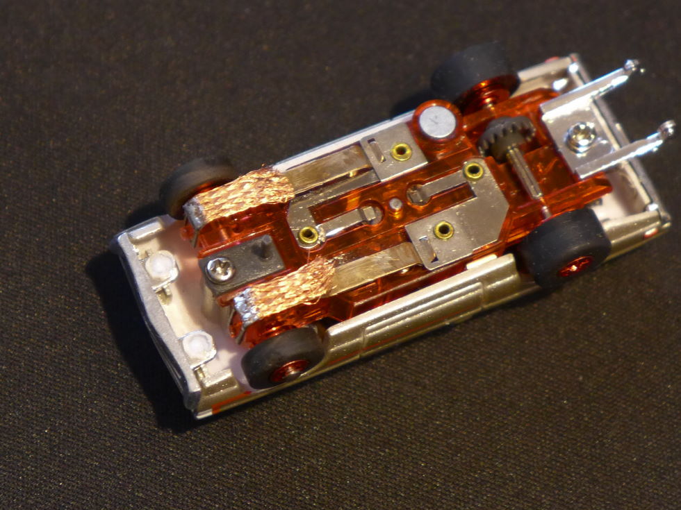

Braids - yes, absolutely. Some short-ish pieces soldered to the front of the shoes is the way to do it. You want it nice and smooth at the front, so nothing catches on the track joins...
One way is to build up solder at the front or...
...simply leave long ends at the front and bend them up.

That would mean these cars are dedicated to the proxy? I can't imagine that the braids are good for my old plastic AFX track?

Quote:That would mean these cars are dedicated to the proxy?
Not necessarily. All you need is a standard pair of pickups to swap back in on their return from the Proxy.

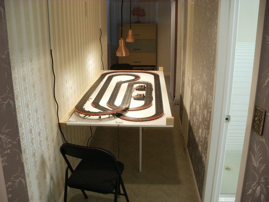

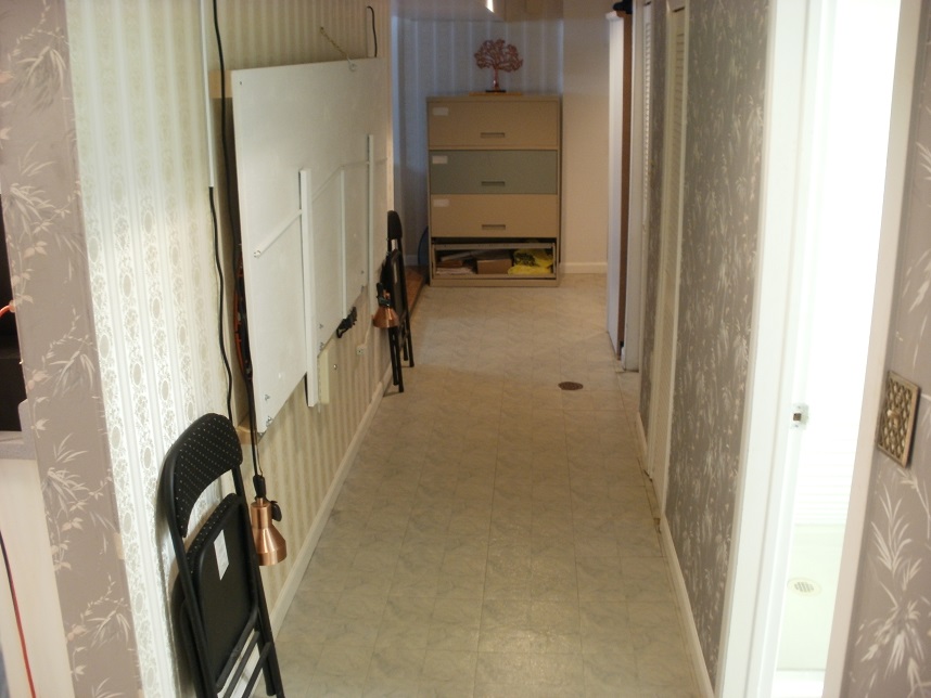

The wall that supports the AFX track is 12' feet long. It has 4' feet of space before it, and 7' feet after it for a total of 23' feet in a straight line. Where the wall meets the floor under the AFX track can easily support a simple HO drag-race track.
Now I'm really starting to think...
