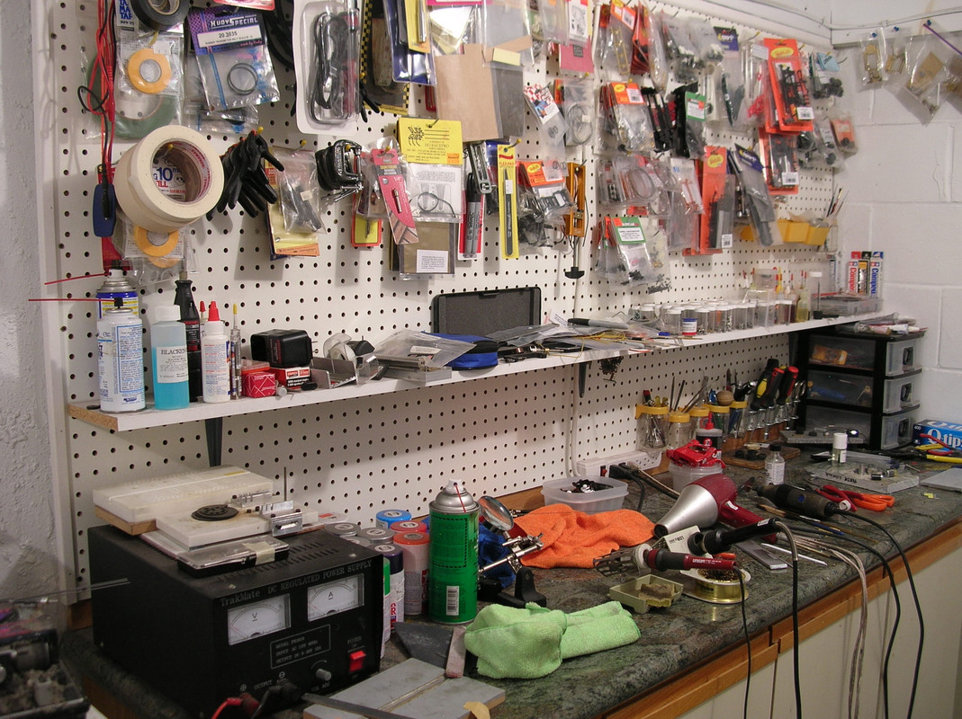

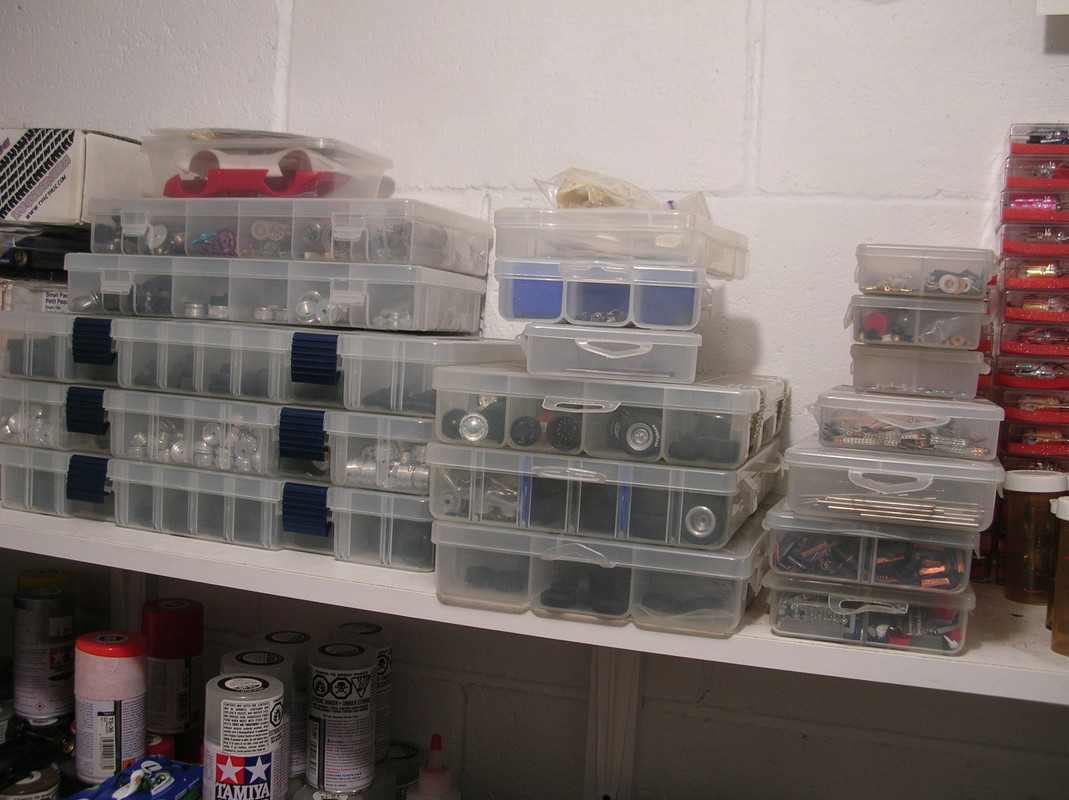

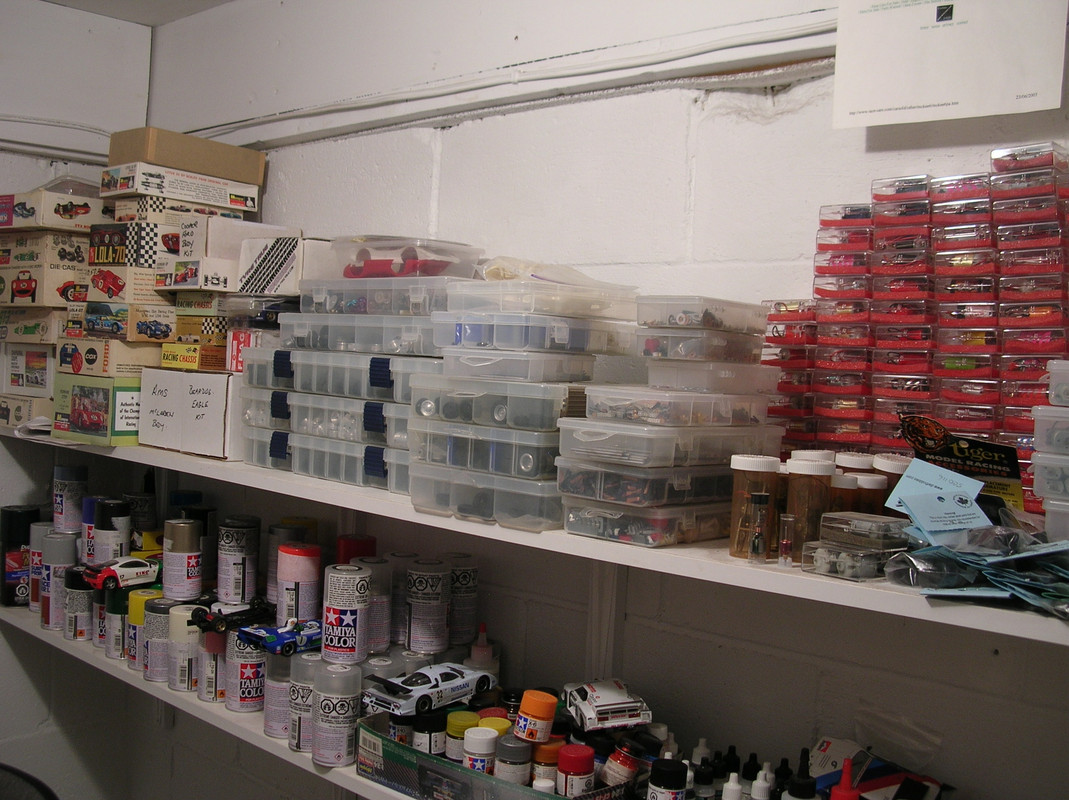

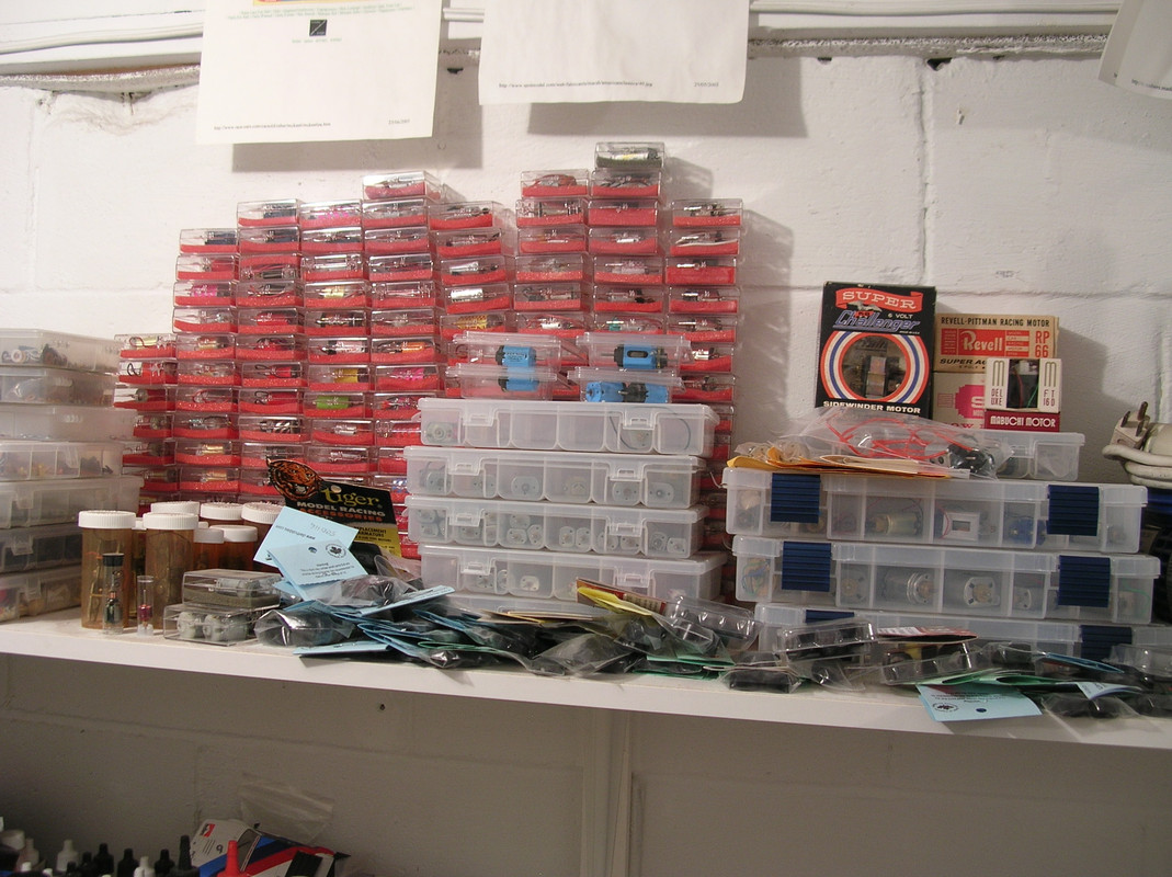

(22nd-Apr-20, 10:07 AM)Nonfractal Wrote: Jeremy,
I would make a guess that Chris's porn-box of gears is a retail box from which parts are for sale, maybe at a shop or a club.
C'mon Chris, fess up!
The parts are all mine, I use them on my own builds
........while I do send some bits and pieces to folks looking for them, I do not sell parts.
I do have some relationships with a few manufacturers, so, I do sometimes get a few bits to test, or some at reduced cost. When I do find a quality part that I like (eg. 65/70 rockwell drill blank axles ) I buy lots,....as,... I know that I will use them, I am never sure how long anything remains available, and I appreciate the the quality/performance.
The parts in boxes are all in as new shape...I do not keep faulty or worn parts...they go in the bin.
Chris Walker
PS the place is a mess,.....With "social distancing", I have been spending a ton of time finishing up projects.
The box of gears shown in my prior post is the second box down on the left...........I do have another one in here somewhere.

That has to be the worst workshop I have ever seen...
Because it's so clean and tidy!
Where's the fun in that?! :-D
