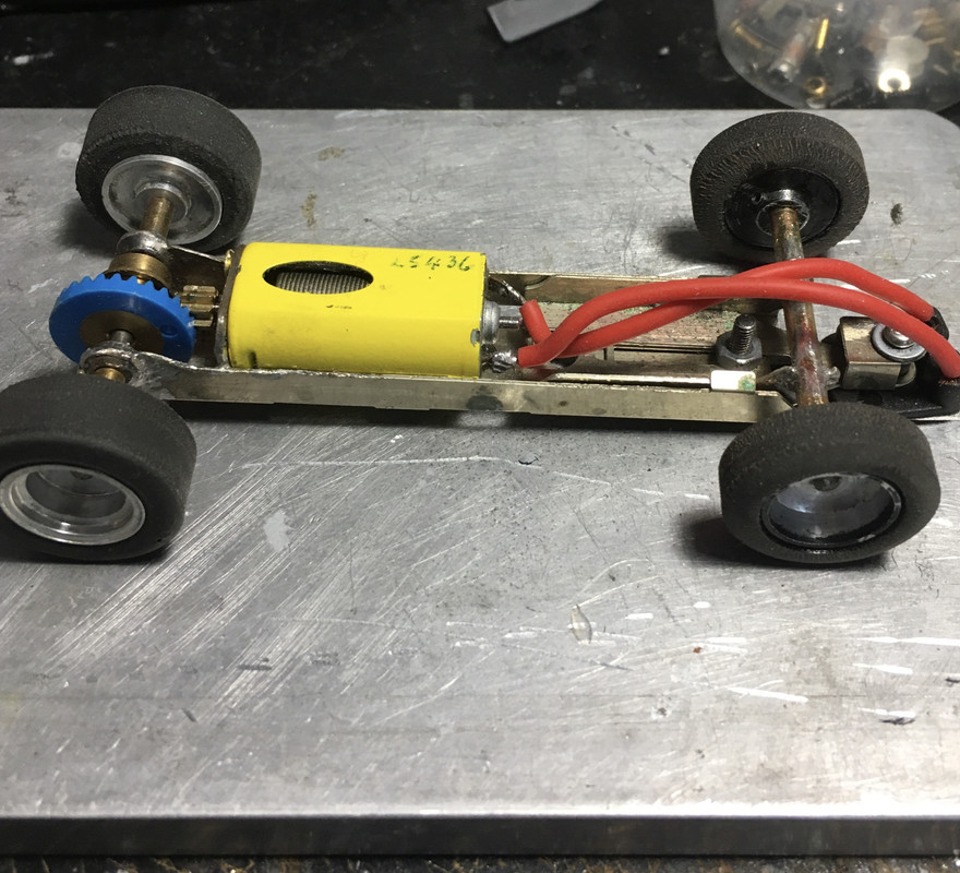

I think mm/rev is simply how far the car travels for one revolution of the motor...
Yogi Berra Quotes. In theory there is no difference between theory and practice. In practice there is.
I like this thinking and sometimes all the charts and tables are good for a starter but are no use if you do not have the practical experience...
"Good judgment comes from experience, which comes from poor judgment."
Some practical theory from me regarding a starting point for gearing.
Short can motors ie FC130 and FK130 and S can motors, gear them lowish around 3:1
Long can motors ie FK 180 including slimline FF050, gear them highish around 2.5:1
There are exceptions of course...recently fitted a 25k FF050 slimline into a PP chassis and geared it using an 8 tooth pinion and a 26 tooth crown wheel = 3.25:1 and as a result the motor gets to rev and stay cool.
Lugging a motor is never a good idea but I am surprised at how tall the FK and FF motors can be geared.
As I said just a starting point opinion.
[Image: 0-D9-EDDD2-DEA0-4436-83-C5-BA9308908-BF3.jpg]
