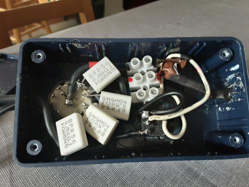

As a wrap up on this sub thread.
The diodes were removed from the circuit last month and 0.5 ohm ceramic resistors used instead.
I tested the the brake choke at Molesey slot car club and found that :
A) the circuit did not upset the SCP.
B) I had far better control of the braking.
AlanW
