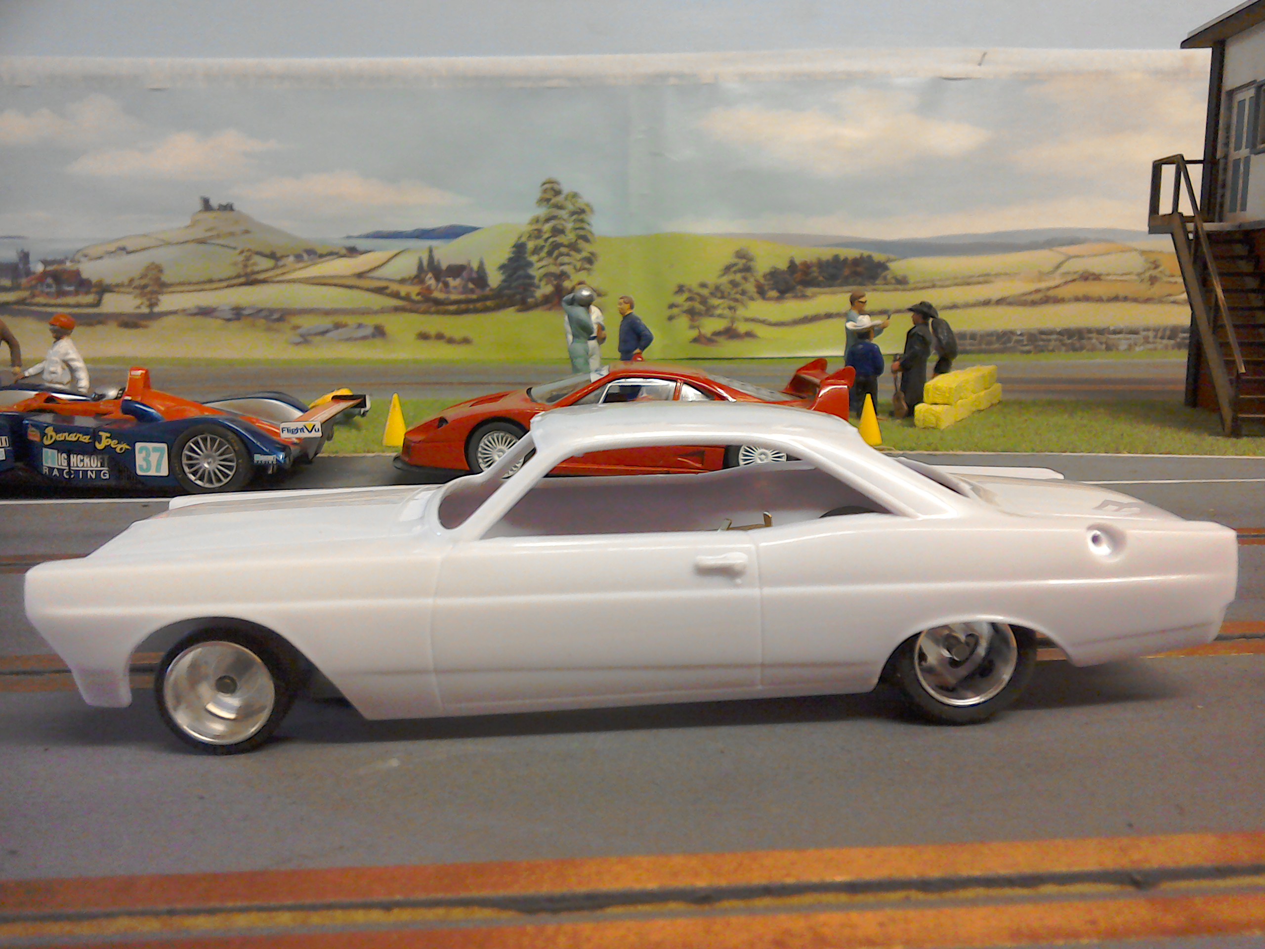

Yo Steve,
I'm happy to send it down. The mirrors and such are all removable, in fact originally it had an aerial on each rear wing.

Hi Leo, wait till I have got my kit and had a go at that first ,if that is successful then I may ask for your sedan and maybe manage to make the roof for mine as well a body for you
Cheers Steve

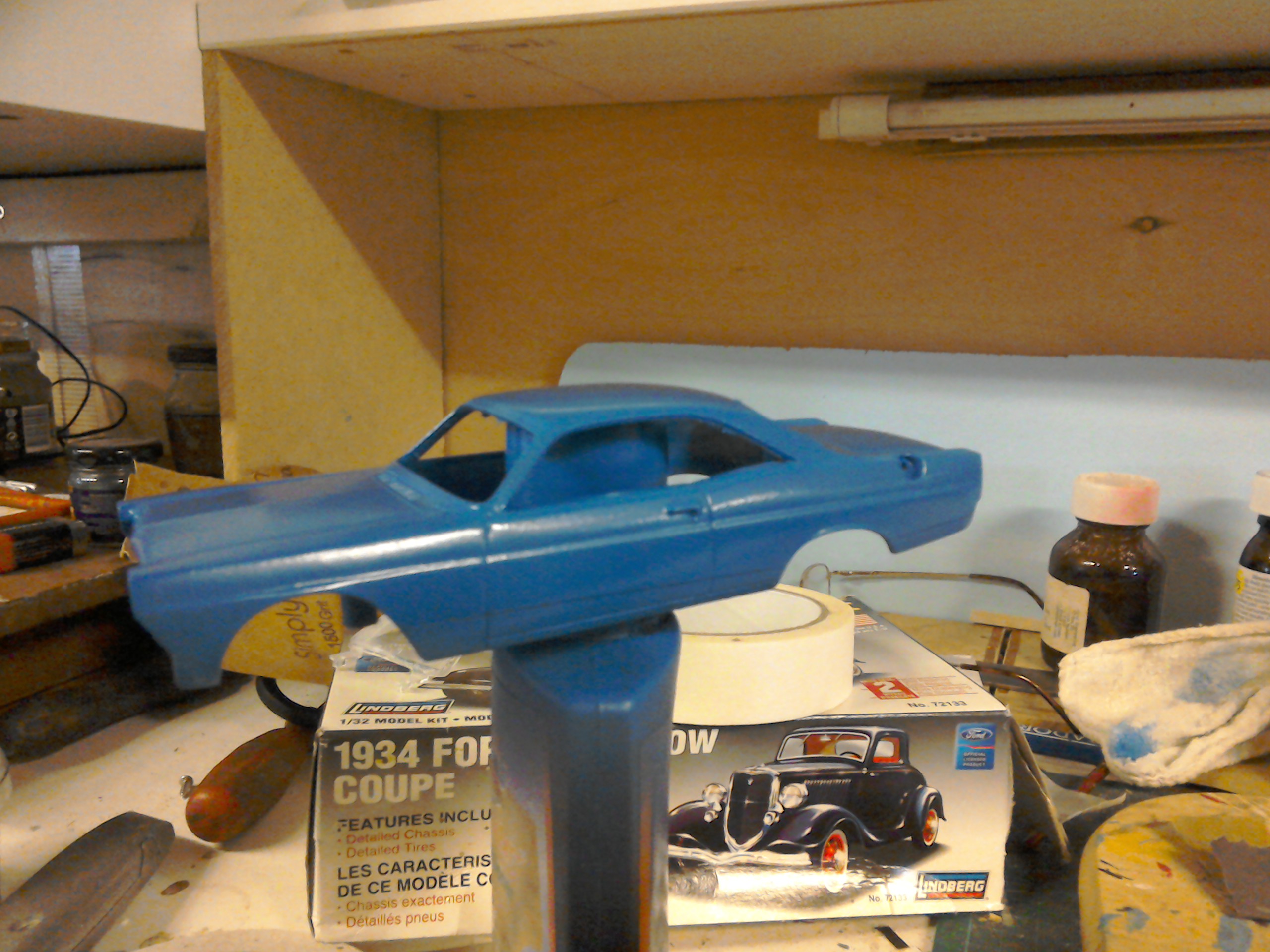

Now he is getting into bodiy moulding ? is there no end to your talent Steve ?
I will follow with interest :)

Hi Savage , there is an end to my talents ,it starts with body molding :

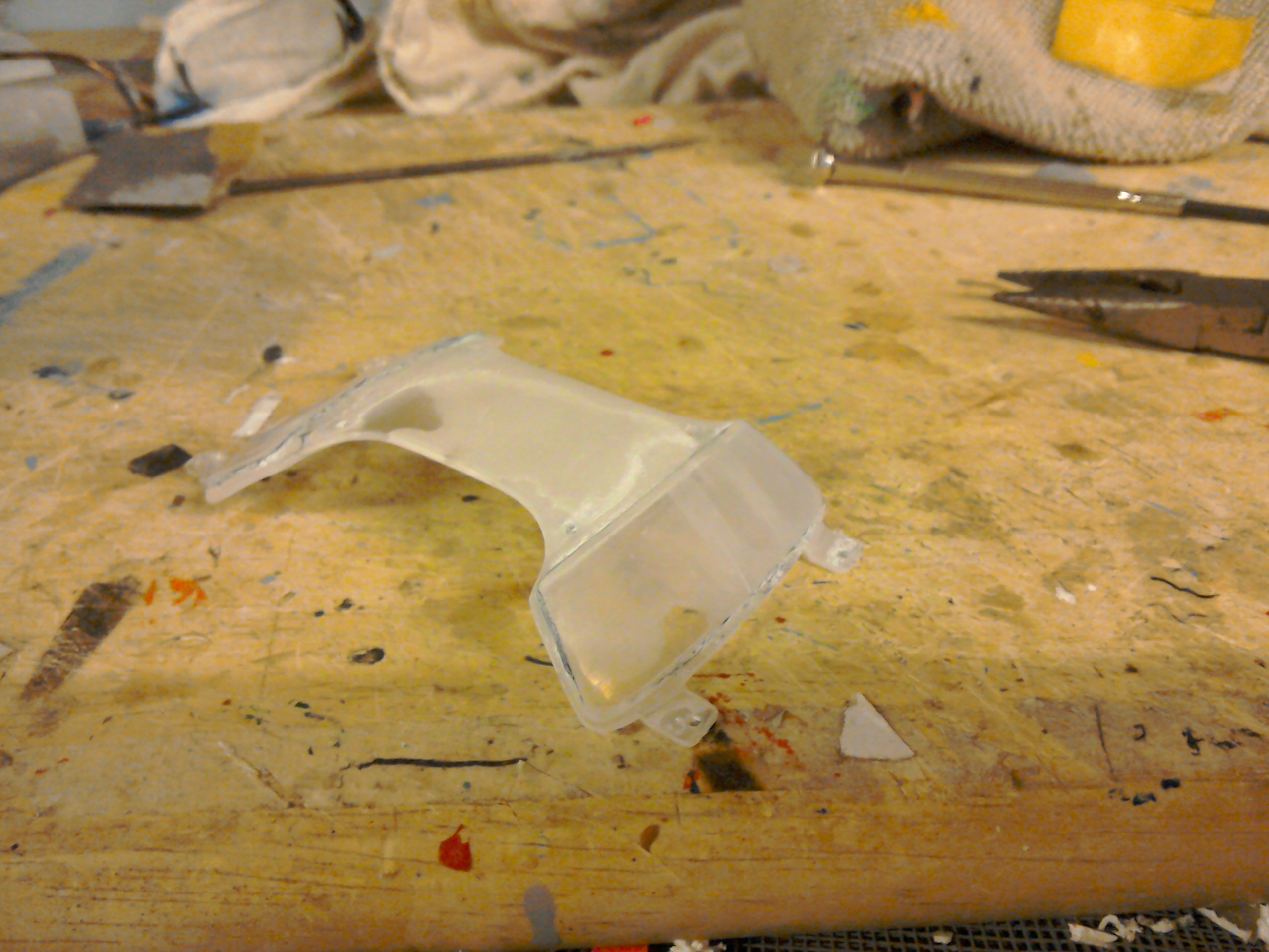

You could probably use the old screens as templates to cut out some new ones from clear plastic sheet.
Gordon's probably the man to consult.

Cheers Jason , will give him time to see if he sees my problem and posts a reply . See

Clumsy bugger, that's the sort of thing I do!
Screens are a pain. Depending how bad the glue is, first thing I would try is wet and dry paper to get it flat, about 320 grade then finer going down to 2000. Once it's flat polish it with T cut. I've rescued a couple that way but it depends to a degree on how far the glue has eaten into the plastic.
I use clear packaging quite a lot but it all depends on the shape. If there are complex curves, it might not be possible and you would have to think about vac forming or, the ultimate - get another kit.
However i'd try and sand it out first. Once it's T cut and Futured, the result can be pretty good.
PS Just looked at the car again. Quite flat so shouldn't be that hard to use thick packaging although finding a glue that works may be tough. Try the paper first.
