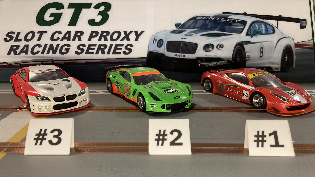

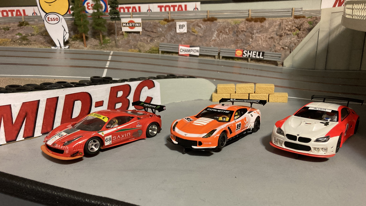

Post race pictures.
Race #10 Podium
1st Heli_ca
2nd Big Duhg
3rd Aloha
[Image: 3-A583-EA1-DE62-42-C3-B753-380126846-C54.jpg]
Race #10 Winner - Heli_ca
[Image: F0-B226-D6-1101-4-A51-AEFE-D83-AEA5-C478-F.jpg]

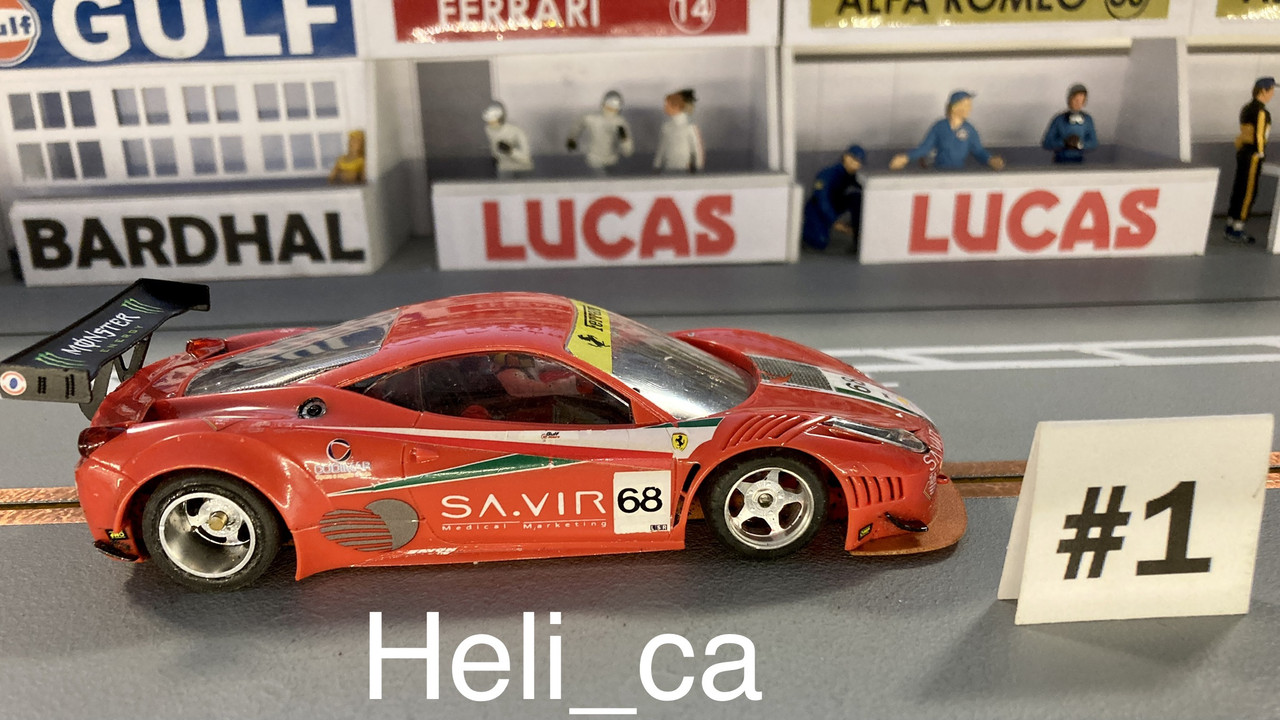

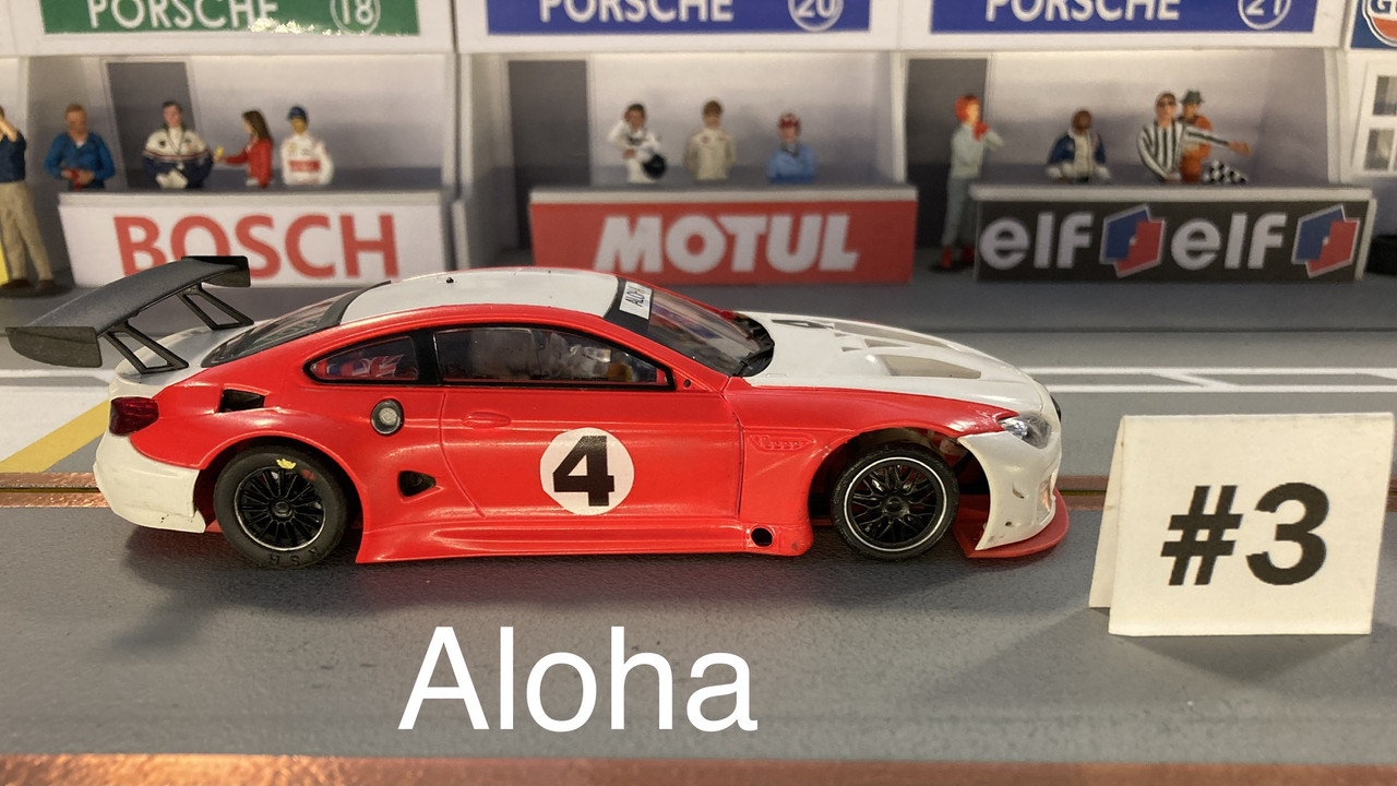

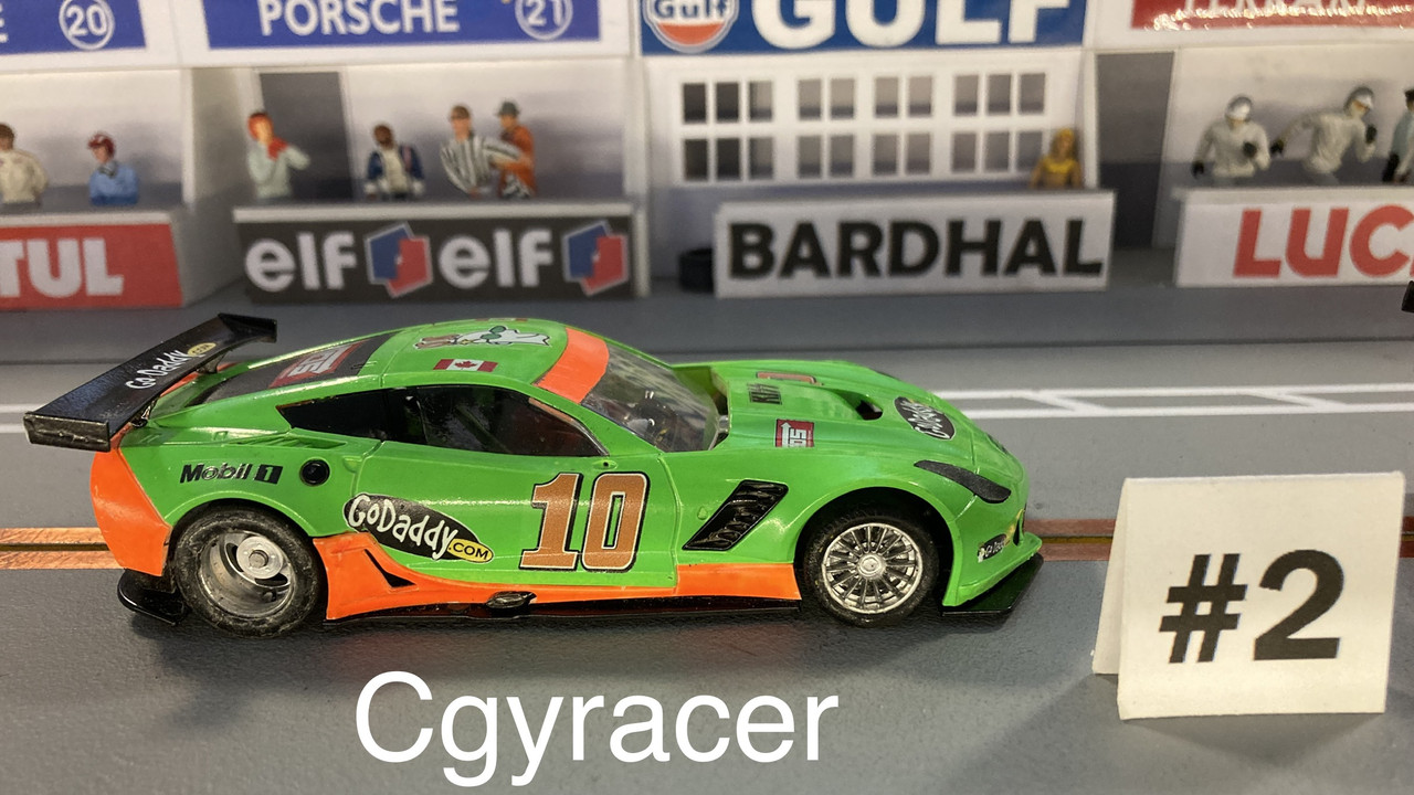

The 2021 season is now officially completed.  Here are pictures of the final overall 2021 GT3 Podium
1st Heli_ca
2nd Cgyracer
3rd Aloha
[Image: 4-BBDFC31-7878-4267-84-E3-23-B130-B0450-F.jpg]
[Image: 83-B83-A30-5-ACD-478-C-94-D3-3565176334-CB.jpg]
